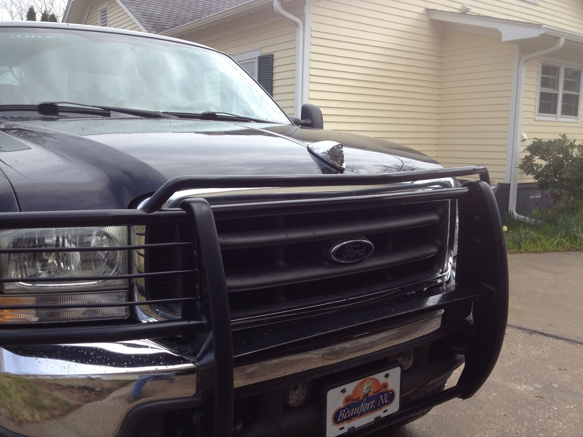

Exactly. It really doesn't bother me at all if the under hood lamp is on when I'm driving with my parking/head lamps are on (10% of my driving time) - I don't really care. Additionally, if I elect to, I can switch it out for a mercury tilt switch lamp & socket or simply install an in-line mercury switch on the hot lead at any time. I kind of treat it like a lighted hood ornament. Much like the lighted hood ornament of my Indian motorcycle War Bonnet I installed on my F250.
