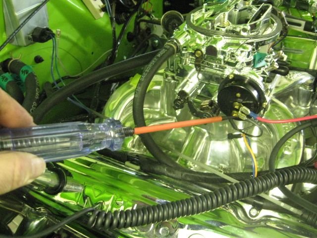

Here is the same car's electric choke wire being tested with a light which is connected to 12V. Touching the choke's black Gnd wire, the light should illuminate, but it does not. The carb's pretty clear coating prevents a ground path even though bolted to the engine.
Never assume secured together = has a ground path. Test and Verify.
In this case, I ran a redundant earth wire from choke/ carb to intake- issue solved, chokes works right. Very basic electrical testing. Where do we have volts, where do we NOT have volts? What volts should we have here? Generally speaking, a bulb holder's outer shell should always be at 0 volts or ground. Therefore a 12V test lite connected to 12V then touched to the culb holder should illuminate nicely. A test light connected to battery (-) and touched to the bulb holder should pass NO electricity and not glow even the slightest. This test is to be done when the bulb holder under inspection has an illuminated bulb- is passing elecricity- or should [is on].
12V test light SHOULD be lit up when touched to ground point. Faulty ground = no ground path = dark test light.
