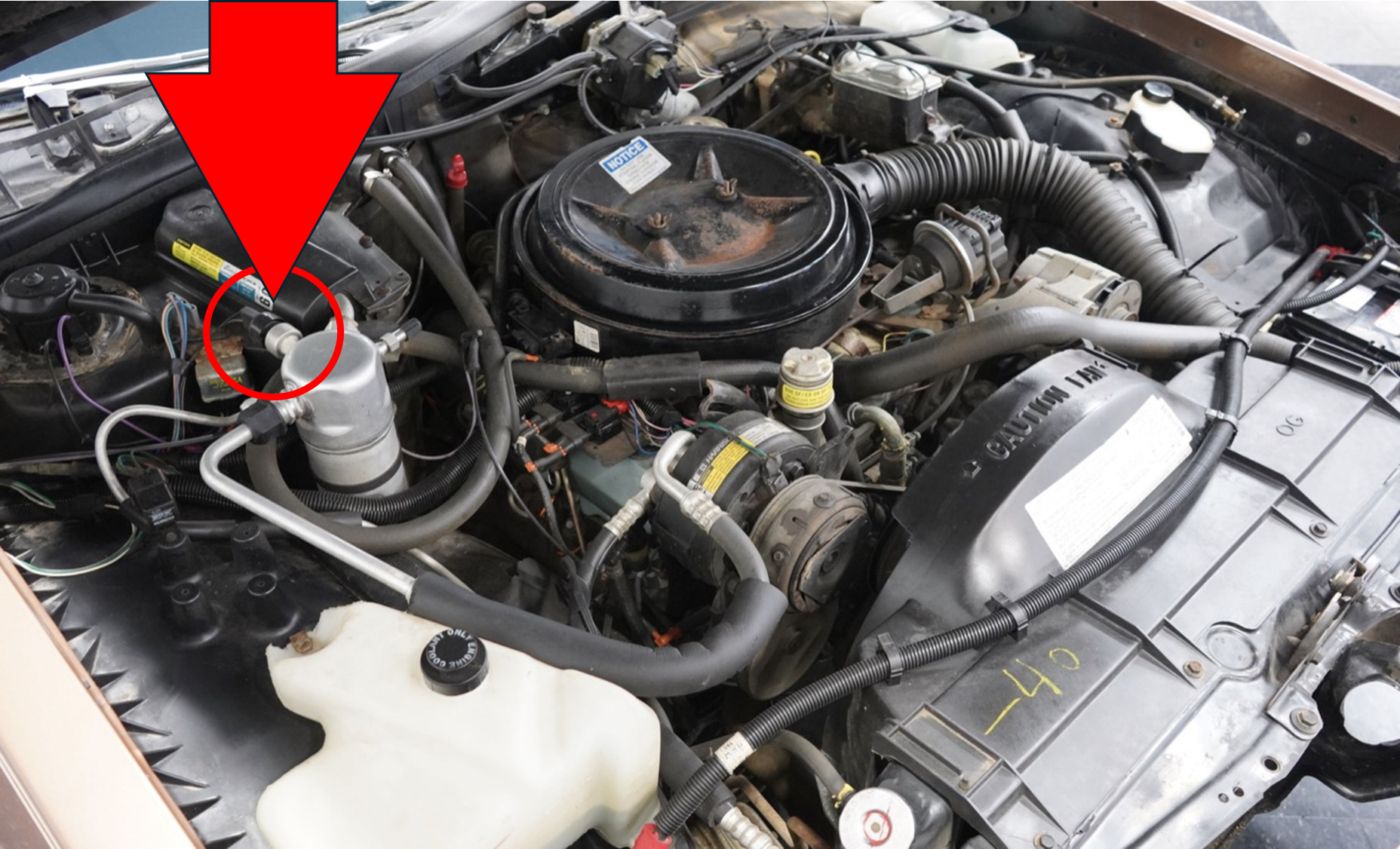

where is this pressure switch located
Old Jun 28, 2025 | 06:59 AM
Posts: 50,815

Without knowing the status of your A/C system, that is impossible to answer. Obviously you need to evacuate the freon before you can do that. Has the compressor been replaced recently? I would start by throwing a set of gauges on the system and seeing exactly what pressure you have. Also, disconnect the plug from the switch and jumper across the two terminals in the connector. Now see if the compressor clutch engages. If so, either you are low on freon or the pressure switch is bad.
