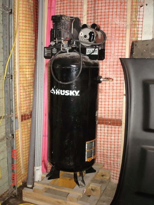

I bought this one used off of Craigslist for $250. It's a 60-gal tank, 13cfm@40psi and 11cfm@90psi mostly sold at Home Depot stores. It's noisy as hell, so I'm glad I put it in my shed which is attached to the garage but a separate room. I inserted a Hayen engine oil cooler between the pump and the tank which is zip tied it to the backside of the cooling fan to help lower the air temp before going into the tank. I plumbed my air lines to the garage using 1/2" copper. The copper was kind of expensive but much easier to assemble than iron pipe, and I know guys who ran their air lines with PVC but that stuff will grenade when it fails sending PVC shrapnel everywhere. It can keep up with my blast cabinet but just barely; blasting at 90 psi the compressor will run continuously, at 40-50psi it will cycle on-off.
