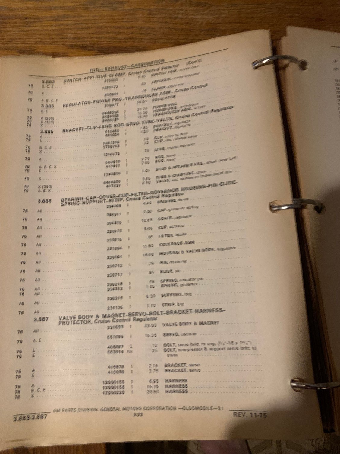

Not sure if this helps but I took a pic from my '76 parts book related to CD. Would the 'bellows' have another name?
Only thing showing in illustrated book is regulator..
sorry for poor pic..

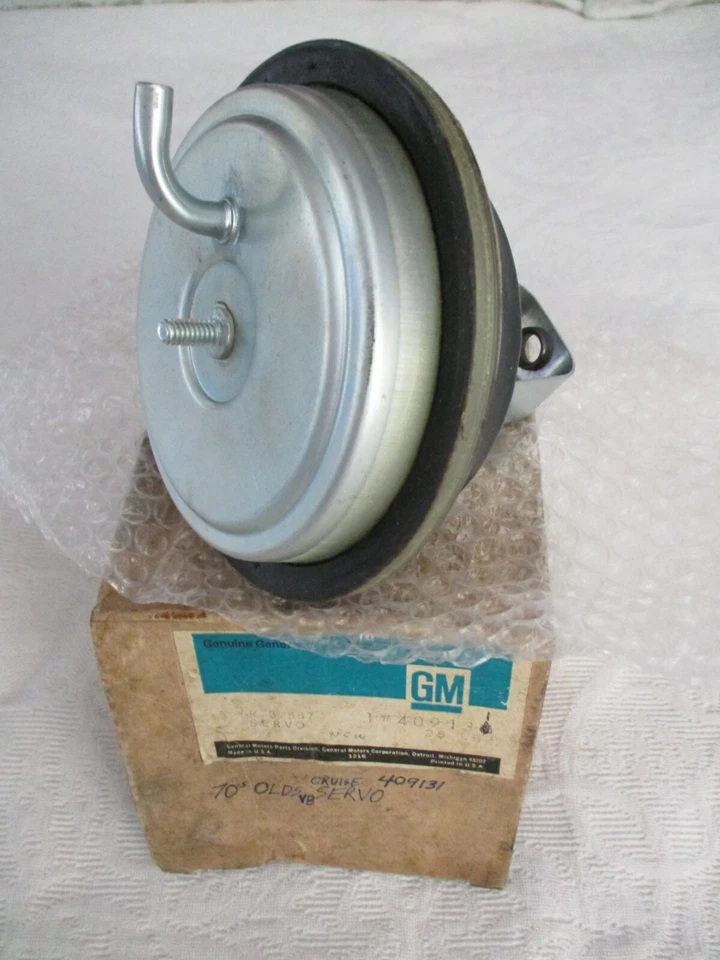

Okay, I found the GM number for the servo: 1498988. It looks like this, but I will consider something close if it seems adaptable.NOS 1970s Oldsmobile OLDS CRUISE control vacuum SERVO new in original GM box! - Image 1 of 3

That photo is from an ebay listing. They're asking $375 for it. That's steep, for sure, but if you need one, you need one.
https://ebay.us/m/lvRVJR

If you’re looking for a servo my 76 parts book shows 551095
the other number comes up online as a tee.
