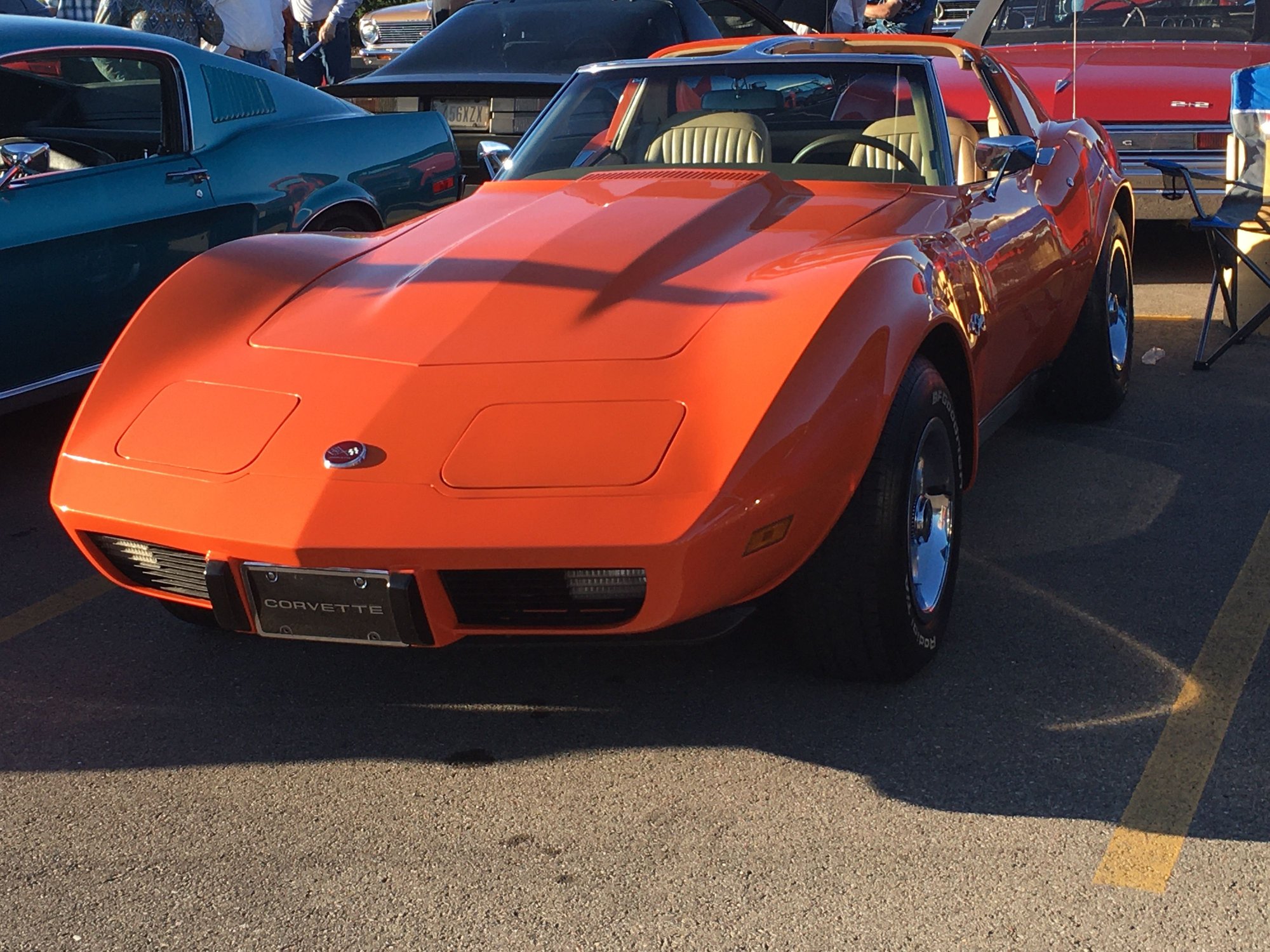

Beautiful Corvette. Is it a targa-top or does it have t-tops?

Yup, my cousin’s old Vette! He owned it from the early 80’s until he passed! It has not quite 50,000 actual miles!

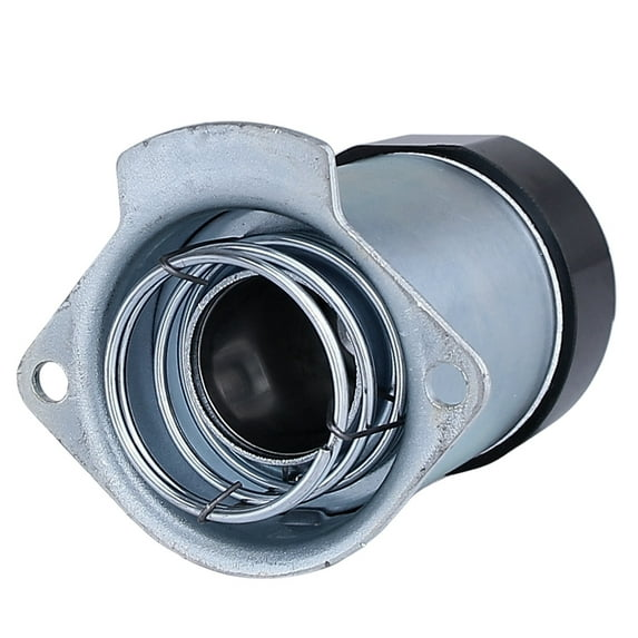

That sounds typical of a bad set of contacts in the solenoid. You can replace the solenoid by dropping the starter and removing the two small bolts that hold it to the nose casting. You don't even need to disassemble the rest of the starter (though I would). If you do elect to replace just the solenoid, once you remove the screws, rotate the solenoid about 15 degrees in either direction to disengage the tab that holds it in place. The spring will try to send it across the room, so apply pressure on the solenoid until you relax the spring. You actually used to be able to buy repair kits that were just the solenoid contact disc and a new plastic end piece, but these days just replace the solenoid.
Edit: apparently you can still buy the repair kits. They just cost the same as a whole new solenoid, at least from NAPA.
