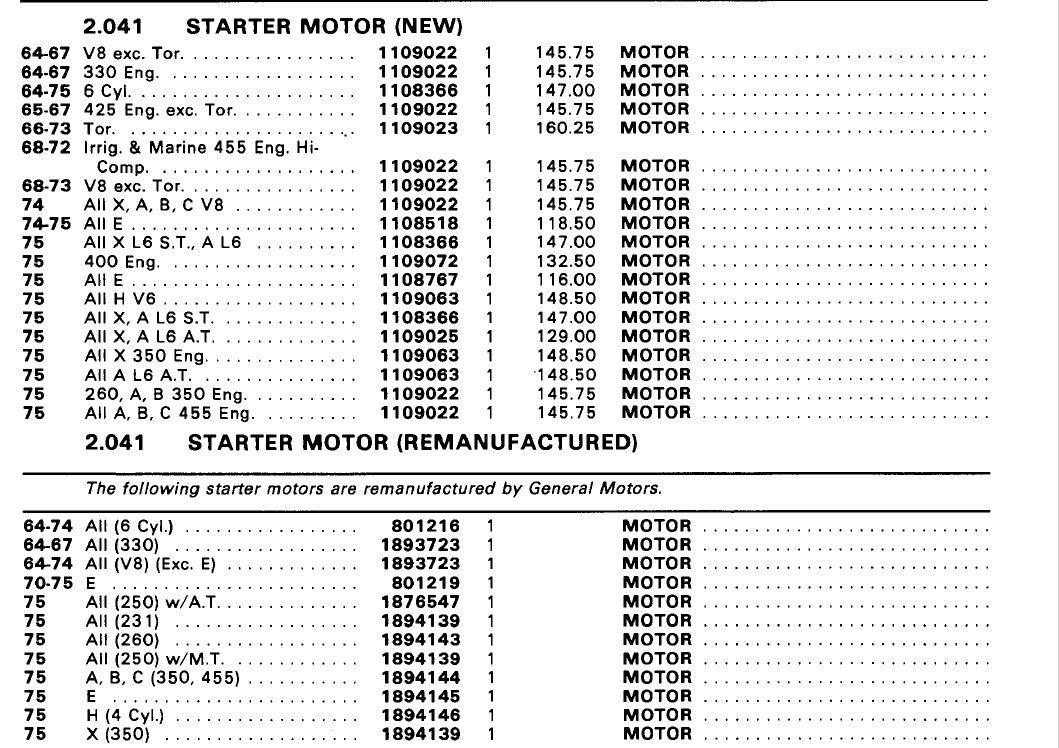

I suspect it will have the OEM number on it...1109022
Old May 22, 2022 | 11:27 AM
Posts: 50,802
Sorry, Norm. This is a classic example of why you need to be very careful using a Parts Book. Per that consolidated listing, EVERY Olds V8 in RWD applications from 1964 to 1975 used the same 1109022 starter. That is definitely NOT the case. This is simply part numbers being superseded.
Here's the same Group 2.041 listing from the January 1972 edition of the Parts Book, and even here numbers have been superseded. In the Sept 1968 edition, the starter motor for the 68-69 H/O is P/N 1108333, which isn't even shown in this 1972 list.
The ultimate authority for the original starter motor part number as installed on the assembly line is the Engine Assembly Manual. Unfortunately the newest one of those I have is for 1971, which shows that all RWD 455s got starter P/N 1108387 that year. You will note that this is not the number listed in the parts book.

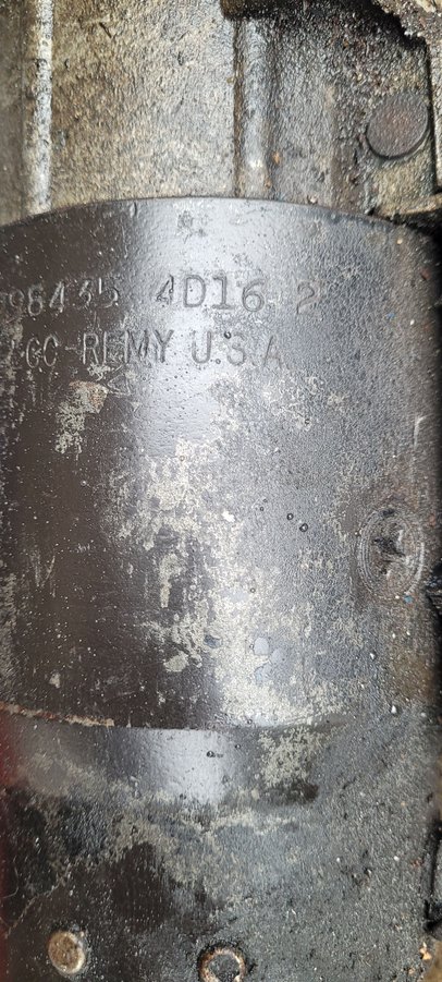

Got the old one out today, and here are the numbers..is it original?
Old May 25, 2022 | 08:15 AM
Posts: 50,802
It is not the original starter. 1998435 was originally used on 1984-87 G-body cars with a Chevy 305. The 4D16 date code shows 1984 (4) April (D) 16th. Obviously this is a rebuilt frankenstarter using parts from whatever was in the rebuilder's core bin.
Thanks Joe...good to know.. it will be my core. Just out of curiosity, would it be different internally since it was designed for the later, lower performance engines?

It's a rebuild. There is no way to tell what's inside of it. It's a pile of mix-and-match parts, which is why I shy away from commercial rebuilders.
