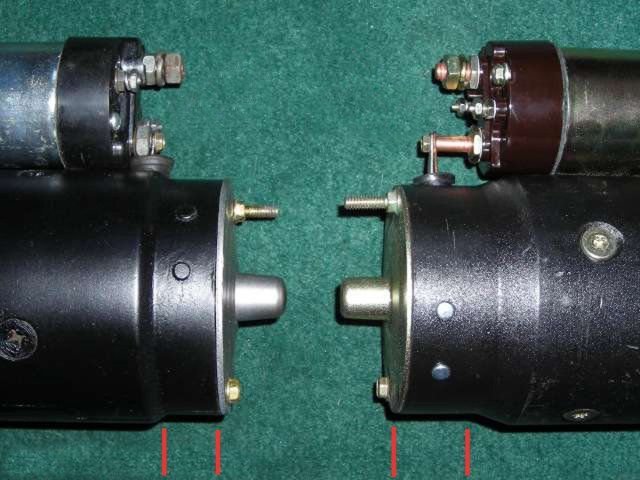

Also take a peek at your starter, the one pictured on the right is a high torque GM unit the other is a standard one. I would make sure which one you have if you decide to buy one outright.
