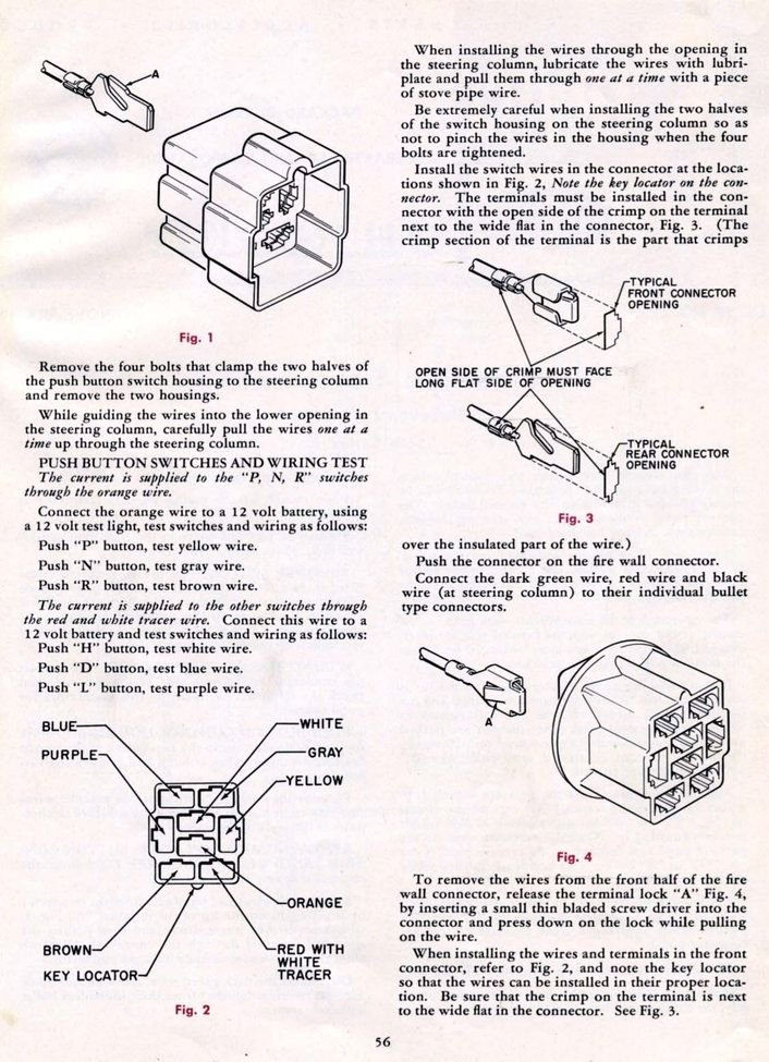

The first is a red wire near the carb with a white connector

That red/pink wire in the first pink is the power source to the distributor. That would explain why you have no spark. Plug that in and go from there.
Plug that into the "BAT" terminal on the cap.

Not only is the pink ignition power wire not plugged into the distributor cap. but the locking tab is broken off. I've had a similar situation that caused an intermittent loss of ignition power because that connector would vibrate loose without the locking tab. The connector is supposed to look like this. That tab snaps over a locking feature on the outside edge of the cap. You can remove the terminal from the old connector and insert it into a new one without having to splice the wire. Note that the brown connector in this photo is for the TACH wire on the HEI cap.
