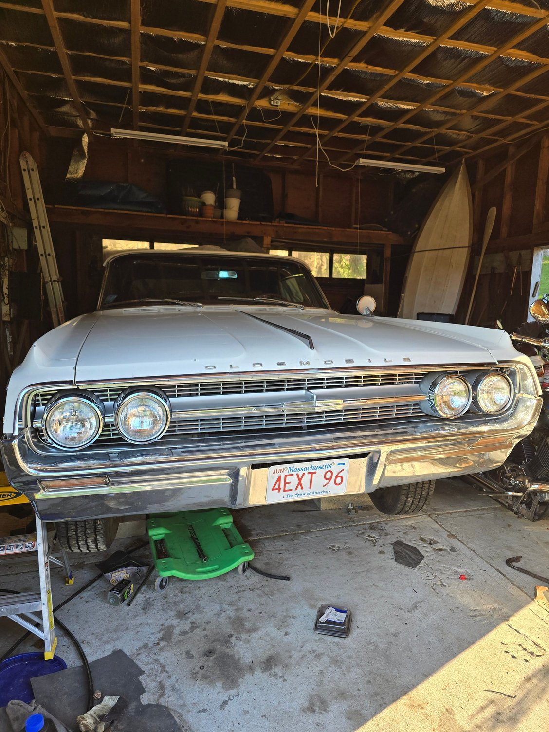

It's back together! I fabricated a battery tray, using what I could salvage of the old tray and 18 ga steel. I repaired a rust through in the inner fender/radiator baffle, cleaned and painted the radiator and the radiator support, and the radiator baffle panels. I pulled off the grille, head lamp assemblies and the front bumper, cleaned and painted the grille and nacelles. I cleaned up the electrical connections and replaced the rusted/frozen screws in the front markers/turn signals. While it was apart and on the lift I fixed a leak at the oil pan gasket and did an oil change. I tested the lights and blinkers- I also had the right side exhaust manifold planed and replace the gasket to fix an exhaust leak, and I got the power door locks working.
Mostly, the radiator, radiator support, battery tray, and all the associate metal parts got cleaned, sanded, repaired as needed, primed and painted. Grille has been refreshed, and all the electrical connections got a good once over, were tested and shown to work as designed.
I think I'm ready to wash it, detail it, and drive to Shrewsbury for the dust off next weekend!
All the silver painted surfaces were repainted with an aluminum color paint
Everything you see has been repainted- Not new parts, just painted the old ones!
The turn signals came out, got cleaned and repaired as needed.
That's a nice look...
Mostly done- I still have some cable management to do
Ready to come off the jacks
