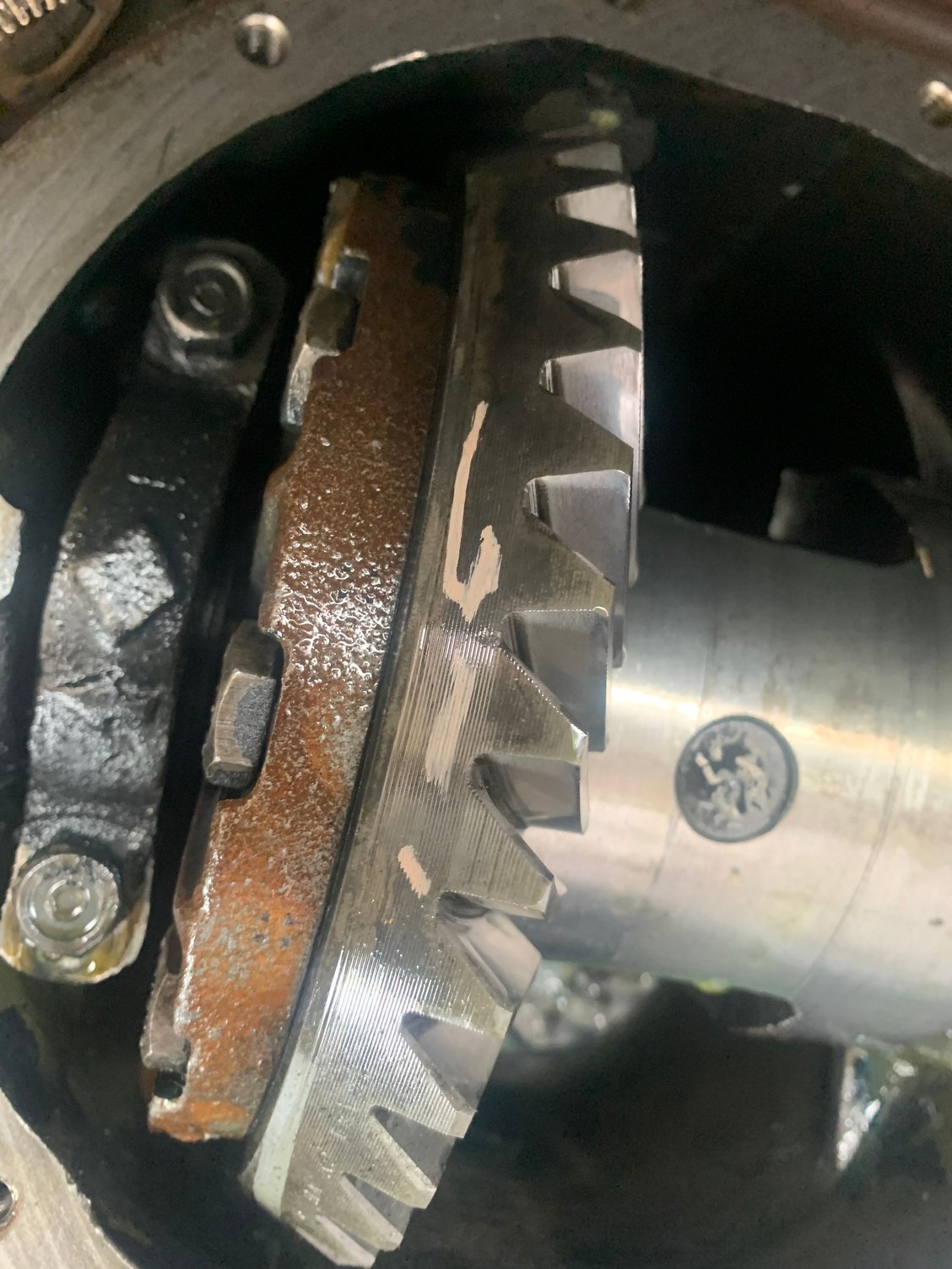

2.56 to ?.??
I have a 1970 cutlass S. It was a 350 2bl car with 2.56 posi rear th350 trans. About 2 years ago I installed a 455 , .40 over full roller..
I would like to change the rear gears to make the car more fun to drive. I do city and highway driving. I am planning to switch to a OD transmission 200R4 at some point. Sooner than later. I do not race. The rear now is a 12 bolt. That’s about all I know about it. I’m sure it the one with the 10 bolt guts in it or something. Not sure. I do run 295/55/15 on the rear. At 65 mph my rpm’s are 2100 or so. The car cruises at 70 mph all day with no problem. What gears fit in the carrier, I already have? Any help would be appreciated

Unfortunately there are no other gears that fit the 2.56 carrier. Most of the aftermarket gears are made to fit the 3.08-3.23 series carrier. You will need a different carrier for any of the 3.xx ratios. There are new carriers that are Ford 8.8 units machined to fit the O-Type gears and bearings. Also be aware the ratios available for the O-Type are very limited.
Factory: 3.08, 3.23, 3.42, 3.91, 4.33, 4.66, 5.00
3.42- up use a different carrier than the 3.08-3.23.
Aftermarket: 3.42, 3.90, and 4.10. All fit the 3.08-3.23 carrier. If you can find them.

Just so you know what you have, that axle is the Type O axle, only used in A-body Oldsmobiles from late-1966 through the end of the 1970 model year. Aftermarket parts are limited at best. As noted, you have a 2-series carrier that only accepts 2.56 or 2.73 gears. It IS possible to use a spacer behind the 3.08 or 3.23 gears in that carrier, but it would have to be custom-machined. And yes, despite the twelve bolts on the cover, this axle uses an 8.5" ring gear with ten bolts. Nothing is common with the Chevy ten bolt axles.

You need a new carrier and a new ring and pinion. You do not need to change out the rear.

The oem 2.78 fits your carrier , just find a 67-70 Cutlass open rear on the cheap and grab those gears.. Not sure on Type O spacer availability to put a 3.08/3.23 gear on yours .
