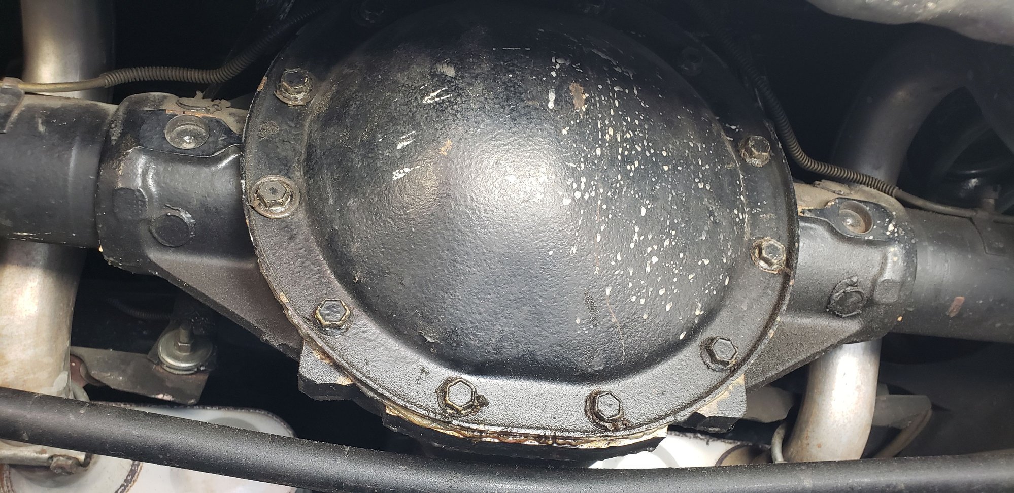

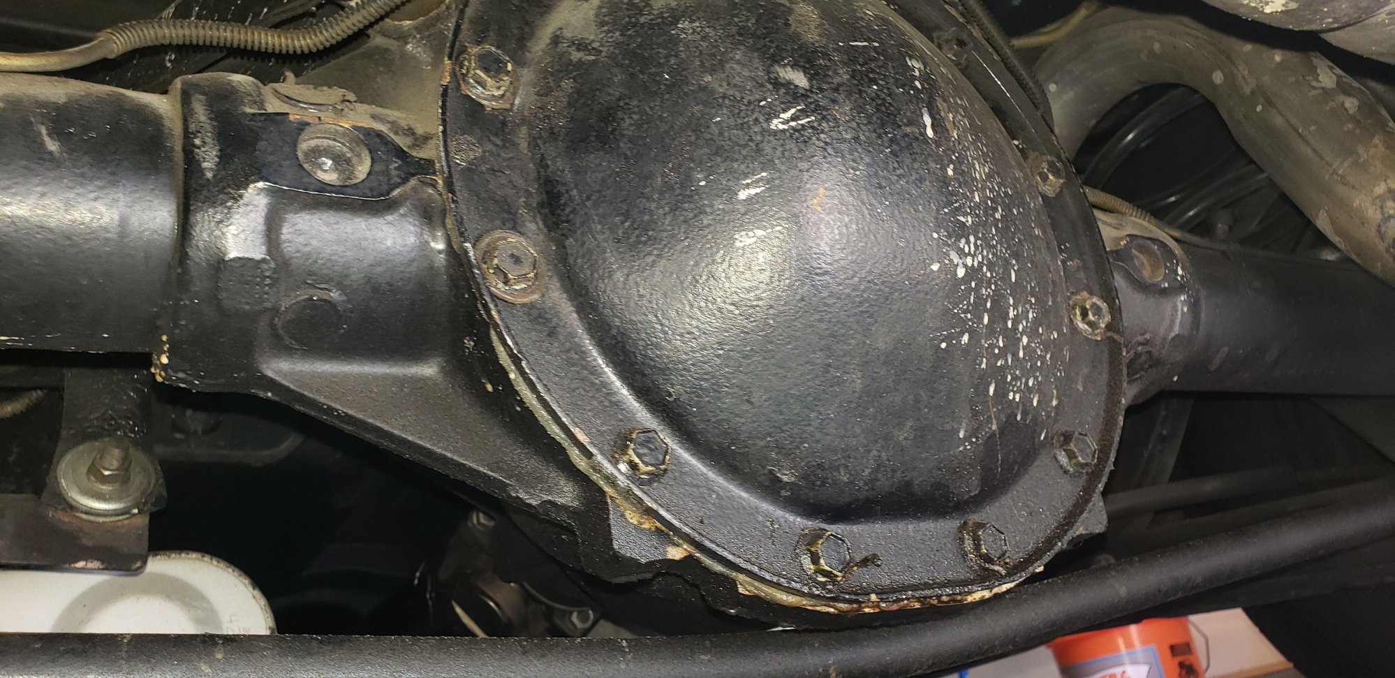

It appears I've moved on to my next rabbit hole, the rear end. I was curious as to the gears i had on it (69 442 with 455 and 5spd tremec) so i jacked up the rear end, rotated the tire once, drive shaft rotated just over 3 times, I'm thinking its 3.08 gears(based on a chart i found in one of Joe's posts). I was looking at maybe throwing in some 3.55 or 3.73, maybe 3.90 gears in there. Anyone have any experience on jumping from 3.08s to any of those gears? Pros? Cons?
Also i am trying to figure out my rear end, i to took some pics, read a bunch on here and I'm still confused. Hoping someone can help. Also would need to now if any of those above gears would fit in place of the 3.08s and where do people buy there gears from?

Looks to be an O-Type rear, which was standard on the Cutlass line from 1967 to 1970. The O-Type has a 12 bolt cover and a 10 bolt ring gear, but the gears are not interchangeable with other GM 10 bolt rears.
The O-Type had a fairly small number of gears available from the factory and they were used on three different series carriers. Below is some info I archived a while back about O-Type posi units and gear ratios
#673 = 2.56 & 2.78 ratios, 28 spline
#671 = 3.08 & 3.23 ratios, 28 spline
#588 = 3.42 & anything numerically higher, 28 spline
#672 = 3.42 & anything numerically higher, 31 spline
***The 31 spline axles were offered in late 67-68 OAI cars only.
In addition to the above gear ratios, there were 3.91, 4.33, 4.66, and 5.00 available.
For aftermarket replacement gears, the field is even smaller, with 3.42, 3.90, and 4.10 as the available ratios. Lucky for you, they are made to fit the carrier you have (3.08-3.23 series).
Here's Richmond Gear's offerings:
https://www.richmondgear.com/wp-cont...n1.pdf#page=32

Rick, Kenneth's info is correct. That's a Type O axle - 12 bolt cover, 8.5" ring gear held with ten bolts. Unique to the 1966-70 Cutlass line.
