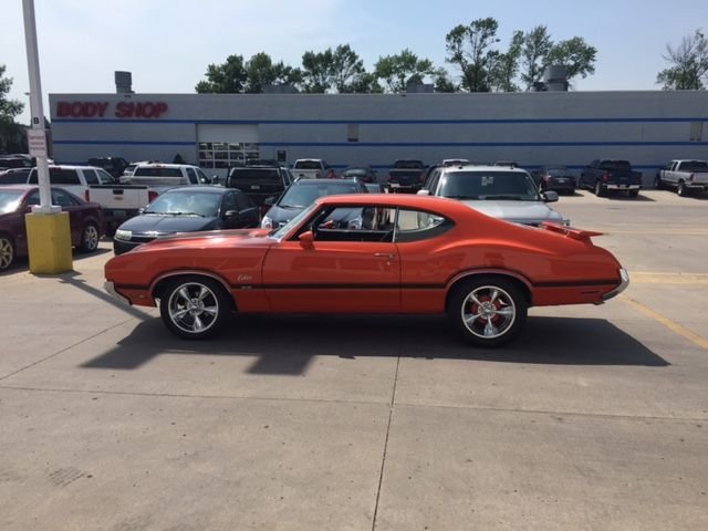

Hi all my fellow Olds guys. I'm wondering, I do have a real 1970 Olds W31. It has the 3:91 gears which as we all know suck on the highway. I want to make if more Highway worthy, with out it costing me a ton of money. Obviously an OD transmission would be best, but expensive now. What are my options with this rear end. The only two ratios it will except are 3:91 and 3:42. with out swapping carriers. Where can I get a new carrier for my car? I thnk this is an O type rear end. I can't remeber. My uncle will do the labor for free, I just have to get the parts. OR does anyone know of a good OD trans that isnt $2200 or more like I've been seeing for a beefer motor. Thanks in advance everyone. I do have the 12 bolt rear and it is a posi rear end.

Why not swap the entire rear end assembly?
You can have 3.08 or 2.73 probably w/o much cost.
You can even leave the brakes on the car. Backing plates and all.

However ..... if you really have a W-31, with original engine and original cam, you should not even be considering putting highway gears in it. 3.42 will be tolerable, but anything numerically lower will turn your car into a dog (if it has an automatic transmission) and also make it difficult to drive (if it has a manual transmission). There's a reason the factory made 3.91 gears standard for the W-31.

Originally Posted by Joeg
Thanks for all the input. I'm not looking for a highway cruiser. But I do want to be able to run a 70mph comfortably. Heres where i'm at now. At 60 mph im at about 3000 rpm. It is the hurst dualgate 3spd auto. Not original motor or trans. But original rearend. I do have 29in tall tires. Lowest i'd think I want to go is with a 3:23 to keep some snap. Per RPM callculater. With a 3:42 i'd be at 2848rpm and the 3:23 2690. But I better throw this out there to. There is a 455 going under my hood as we speak.
So you are installing a 455 in a real W-31 car? Shaking head. You should have mentioned this earlier.
Anyways if you are going to a 455 then put your 3.91 gears & posi aside & install a 3.08 or 3.23 gear & carrier. The 455 will be fine with a tall tire & low 3 series gears.
Sure hope your trans is up to the TQ of the 455....

@Blackgold, Yes sir, it is a real W31, had it authnticated at the GM dealership which used to be an Olds dealer as well. It was bought her new actually. But unfourtunaly it is not the original 350 under the hood

However....I am sure I am not the only member pained to see a W-31 with 3.91 gears be converted to lazy gears & a 455. That kills the purpose of the W-31 doesn't it. But like I said it is your car so have at it....
