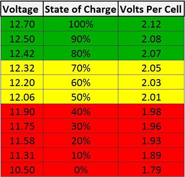

Old Dec 22, 2022 | 07:21 AM
Originally Posted by PaulWinn
Try it.
As batteries discharge they dont lose V they lose the ability to push the volts (Amps).
They lose both voltage and amperage. A completely discharged battery is 10.5v.

PaulWinn's Avatar
Joined: Dec 2013
Posts: 220
Took my opinion a bit too literally...
I have (what I call) a dead battery - won't turn the engine over, just clicks - and it registers 12 V on my MM. I didn't mean dead dead dead really. A fully charged healthy bat registers well over 12 V.
Some folks might think a 50% discharged bat measures 6V, 75% discharged measures 3V, and so on. That is not the case.
