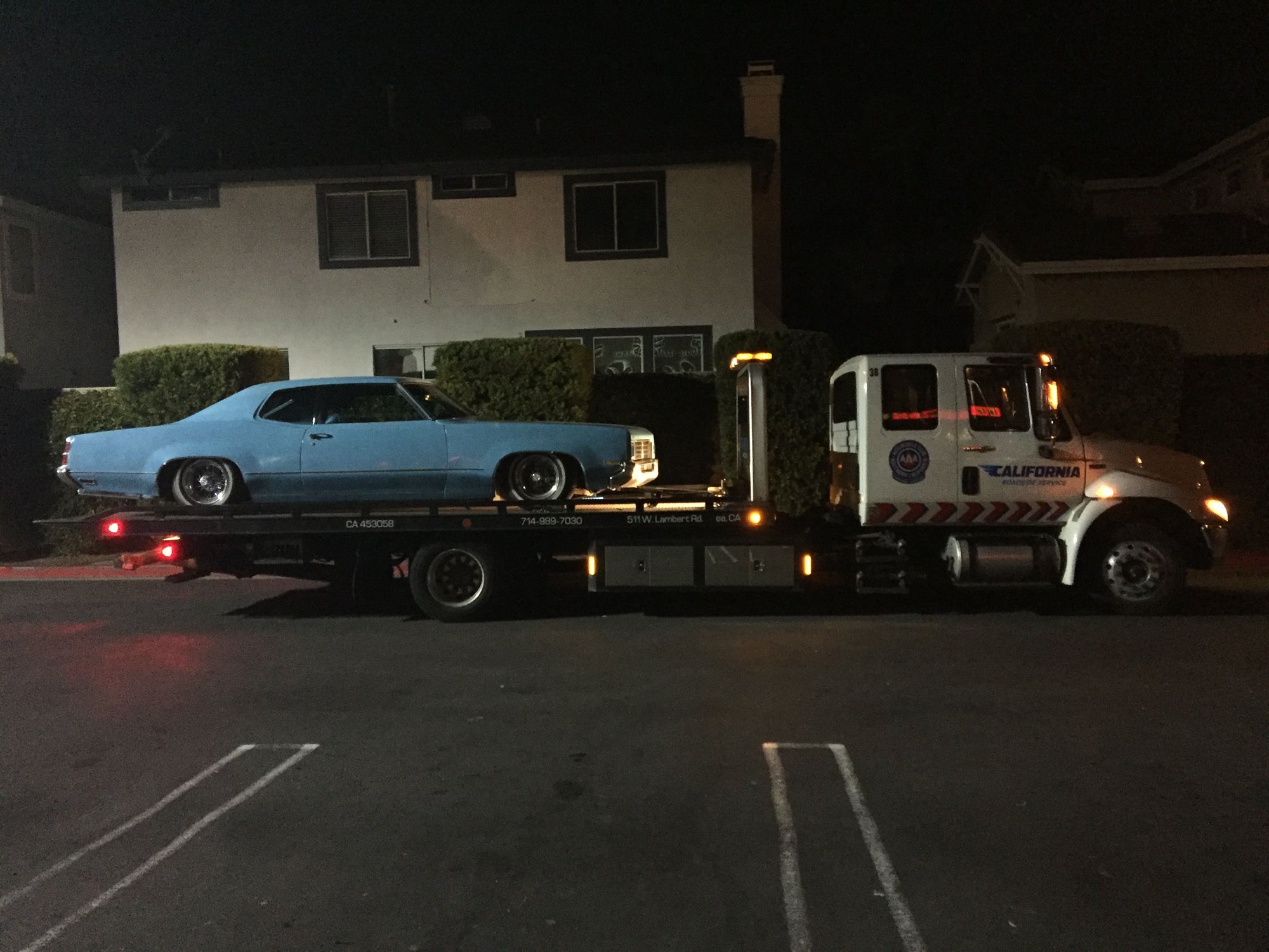

I just gotta say sweet ride love the 30 spokes. Atleast they look like 30 spokes lol.

thanks! they're cragar star wire 50-spoke =)
