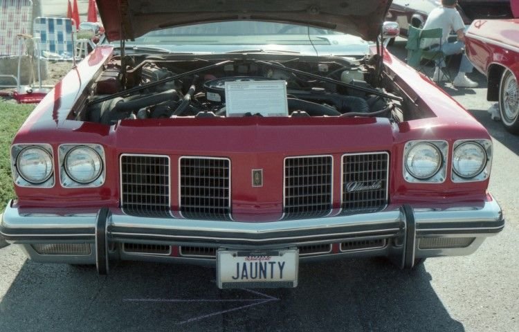

jaunty75's Avatar
Posts: 15,177
From: southeastern Michigan
Originally Posted by Olds64
Is it your 75 Delta 88 Jaunty?
Yes, I would say it was a jaunty vehicle.
I sold it in 2001. Here's a photo of the front end I took at a car show in 1999. Note the license plate. It's where my username comes from.
