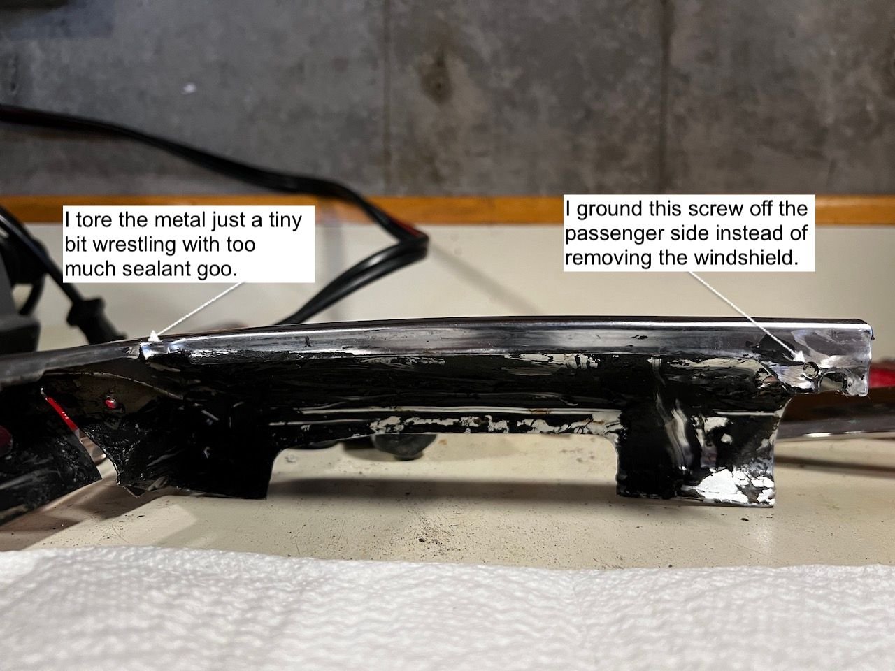

The last person who put these trims on (not me) goobered the trim undersides with enough mastic to stop Mr. Incredible:
Heat gun & solvent help remove 3M sealant. Heat also melts it for reinstallation. Heat parts on the bench, not your windshield.

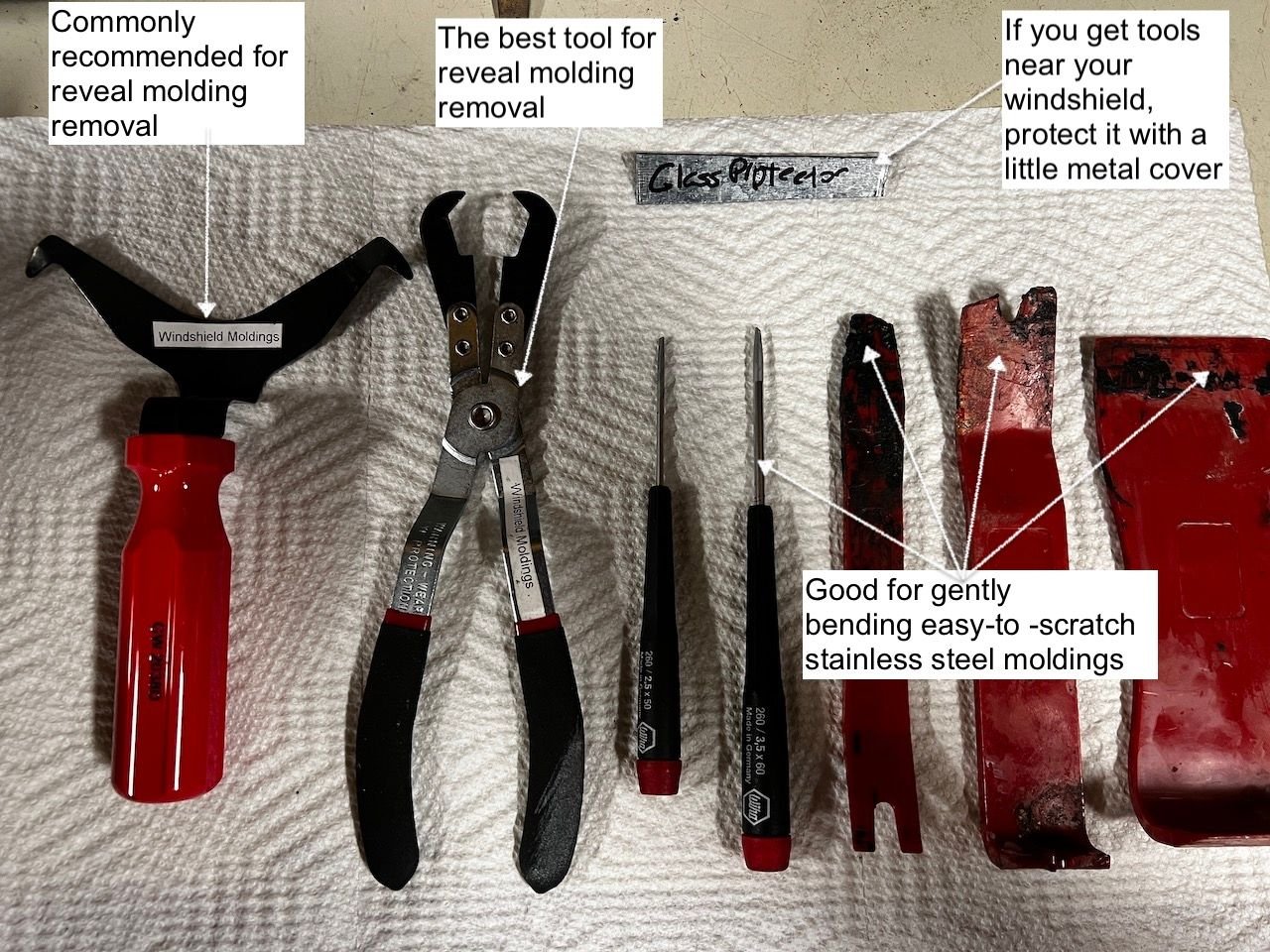

Tools help: with the "Y" hook, you can only grip the clips under the molding from one side and they seem to want to chip the windshield. With the molding pliers, you slide one tooth along the clip channel, hook the clip, close the pliers, and pull gently.
GM windshield (and rear window) molding clip tools. Bending tools (right) create gaps under the molding (on the glass) for the pliers or Y hook on the left. Then pull the clip toward the windshield center.

Begin with the moldings at the bottom of the windshield. I got away with leaving those alone this time. That gives you access to vertical windshield reveal moldings using the pliers above. Once the vertical pieces are off, the thin horizontal one at the windshield top unclips the same way. Be careful about chipping your windshield. Don't rush or you'll chip/crack the glass. I chipped mine in a few places, while I was getting the hang of the molding clip pliers.
Typical GM reveal moldings. The best tool for removing them.

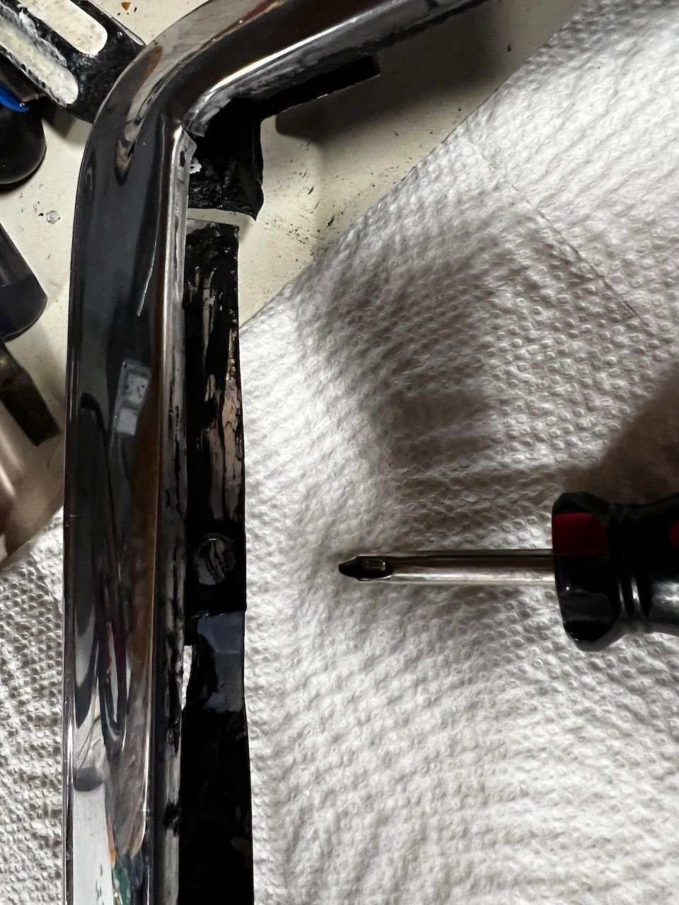

Once the reveal moldings are off, on the front of the windshield you can see a bunch of screws in the channels holding the A pillar and top molding in place. The A pillar front screws are easy, but the top forward ones are flush with no room for tools due to the glass. I ground them off with a dremel instead of pulling the glass. There are 2 screws on top of the A-pillar moldings, but they're easy. The A pillar wraps the side of the windshield frame. There are screws on the back side too.
Once the reveal moldings are off, you'll see 3 screws securing the A-pillar molding to the windshield frame on the front.
I chose to grind off this screw on the front top of the A-pillar molding, but only after protecting the windshield with a piece of bent metal. It's probably smarter to remove the windshield.
Passenger side A-pillar. Grind this screw off or remove the windshield to get at them.

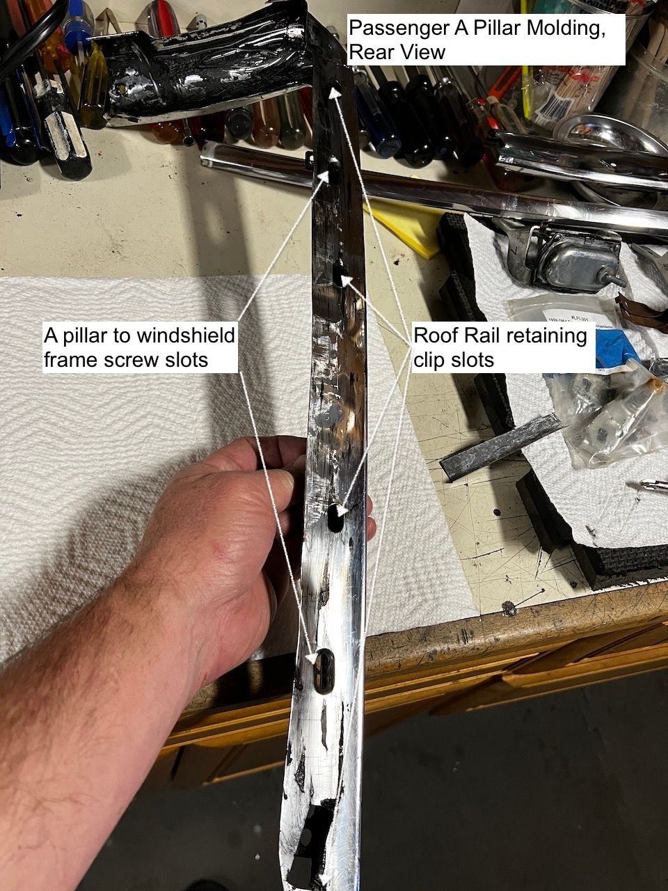

You can't get to the 2 rear A pillar screws until you remove 4 roof rail rubber channel screws. To do that, remove the sponge rubber seal between the door and the windshield. The top of the seal is secured to the A-pillar molding with another screw. If your seal is glued in, it will need to be replaced. Mine seals aren't glued, so I reused them. Once the rubber is out you'll see 4 black screws securing the roof rail to the A pillar through the A pillar molding. Remove them. If your roof rail is glued to the A pillar molding, use one of the plastic wedges to gently separate it. The last 2 screws secure the A-pillar molding rear to the windshield frame and are pretty small. This is a good time to remove the interior A-pillar moldings too. 2 screws per side.
Screw slot locations, symmetric on each side of the car. This is the passenger side as viewed from the rear.
Once the screws are _all_ out, the moldings may come off easily. Or you may begin a wrestling match with ancient mastic glue used to seal the moldings against the windshield frame like me. If they're stuck, the thing to do is work very slowly and use the plastic wedges to slowly separate the glue. Yanking on moldings will bend or kink them into scrap. In the removal process, a little warping is ok, but really try to avoid kinking or tearing the trim metal.

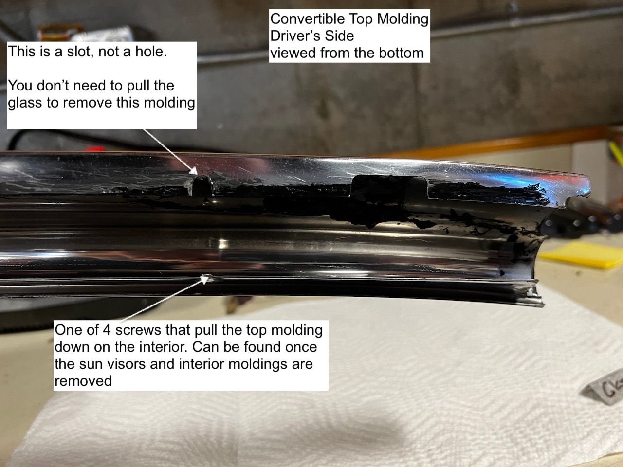

4) Top Molding
This is a top view of the curved piece that the convertible top closes onto.
Convertible windshield top molding. Passenger side on the left.
This was a tricky for me. From the front it looks like the molding is screwed in. It's not. There are 4 screws that look like they go through holes, but the holes are actually just slots to correctly locate the molding side to side.
Here's a shot of the slots that look like screw holes when installed:
On the bench: As you saw above, somebody went nuts with 3M Mastic goo. I used a heat gun on the moldings, scrapers, and 3M solvent to get mine cleaned up for future use. If you're reusing your original stuff, clean off old mastic/sealant & buff up all visible surfaces. I'm not real good at removing dings, so mine have a few, but that's "patina".

I lightly redid the Goo with new strips of 3M mastic, but heated the strips with my heat gun to get a consistent thickness coating (and not go ape-sh*t). I aimed at a seal, not cavity filling, So I put a heated bead in the front lower corner & spread the heated goo with a toothbrush. That sealed it to the windshield pinch weld. When you put the molding back on, use the locating screws to get it back in the right place (side to side) and then affix it using the 4 interior screws that pull it rear and low into the interior.

Next are the A pillar moldings. Same deal with a thin line of fresh goo, heated to get a consistent coating and seal. They kind of pop on, but I lightly tensioned all the screws and tweaked (or bent) it just a bit with the screws on since it will be totally visible. Then tighten down front, rear, and top screws. Pay close attention to gaps & lines where moldings meet each other so you can tweak or bend them to get the right overlap. If you have to bend something, put one of the non-marring plastic tools over it and strike the plastic. This can help shape the trims just a little without scratching and denting them.

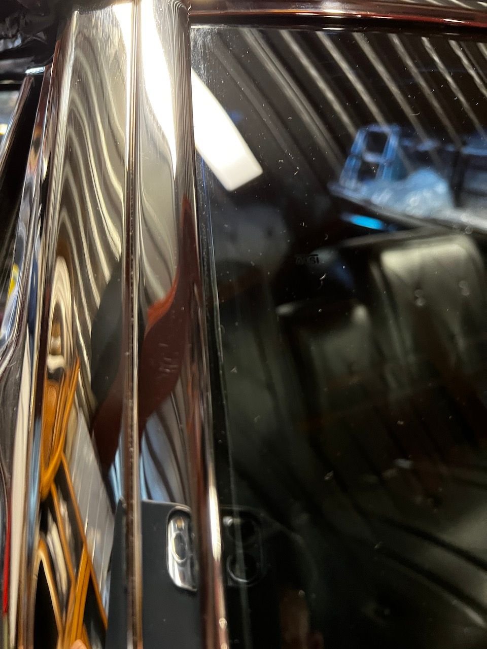

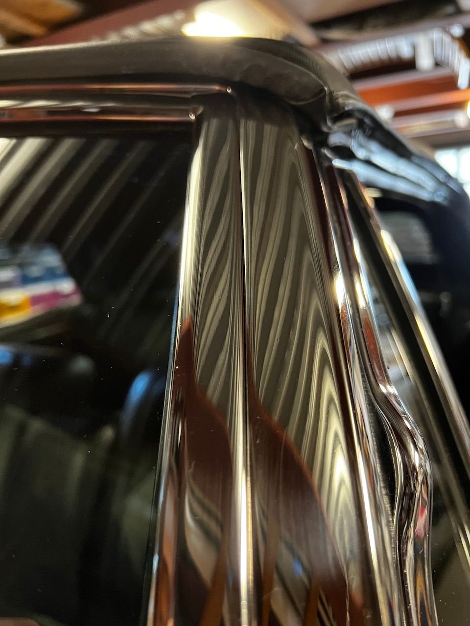

How'd it turn out?
Here's the driver's side.
After few hours with the buffer.
Here's the passenger side:
Hours just to get a few shiny moldings in place.
