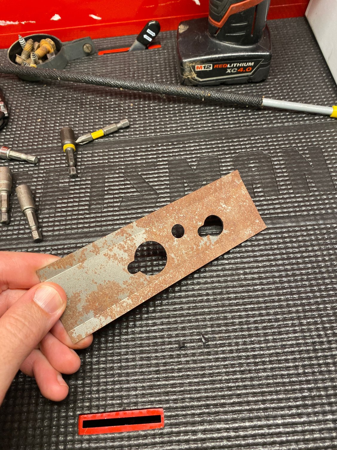

Hello Brian, I am doing the same installation as you but on my '70 Cutlass.
I have this same sport mirrors with the bracket as shown in your photo.
Can you tell me what you used inside the door skin to mount the mirror bracket? From what I can tell it looks like this mirror is for a 71/72 but a pair of them came along with the car in a box of parts so I am going to use them.
Any advice on retrofitting these sport mirrors on my cutalss that originally came with a singe chrome mirror is appreciated.
thanks,
Pat
Old Oct 27, 2019 | 01:18 PM
oddball's Avatar
Joined: Sep 2011
Posts: 2,148
From: Plano, TX
It just bolts right on the driver side.
You'll need to drill the holes and fabricate a plate on the passenger side. You can make a template of the driver door and just flip it around to use it on the passenger. I just used a piece of 16 ga steel as a reinforcement plate.

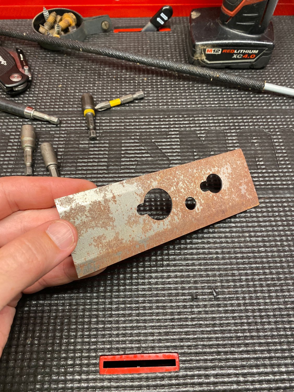

This is the plate you can get from OPGI
Old Oct 27, 2019 | 05:15 PM
jpatfarrell's Avatar
Joined: Oct 2018
Posts: 123
From: Texas Hill Country
thank you for the info.
Will I need one for both sides or only the passenger side?
Old Oct 27, 2019 | 05:33 PM
Brians1's Avatar
Joined: Jun 2018
Posts: 554
I did both
Old Oct 27, 2019 | 07:59 PM
Posts: 15,409
I made a backing plate out of a piece of 1/8" or so sheet aluminum. Drilled and tapped holes for the mounting screws, and one hole for a rivet to hold the plate in place while the mirror was mounted.

Thanks......this is exactly what I was thinking about doing. Those backing plates are not cheap.
Old Oct 28, 2019 | 08:24 AM
oddball's Avatar
Joined: Sep 2011
Posts: 2,148
From: Plano, TX
Driver side should already be reinforced for the mirror that was on there.
