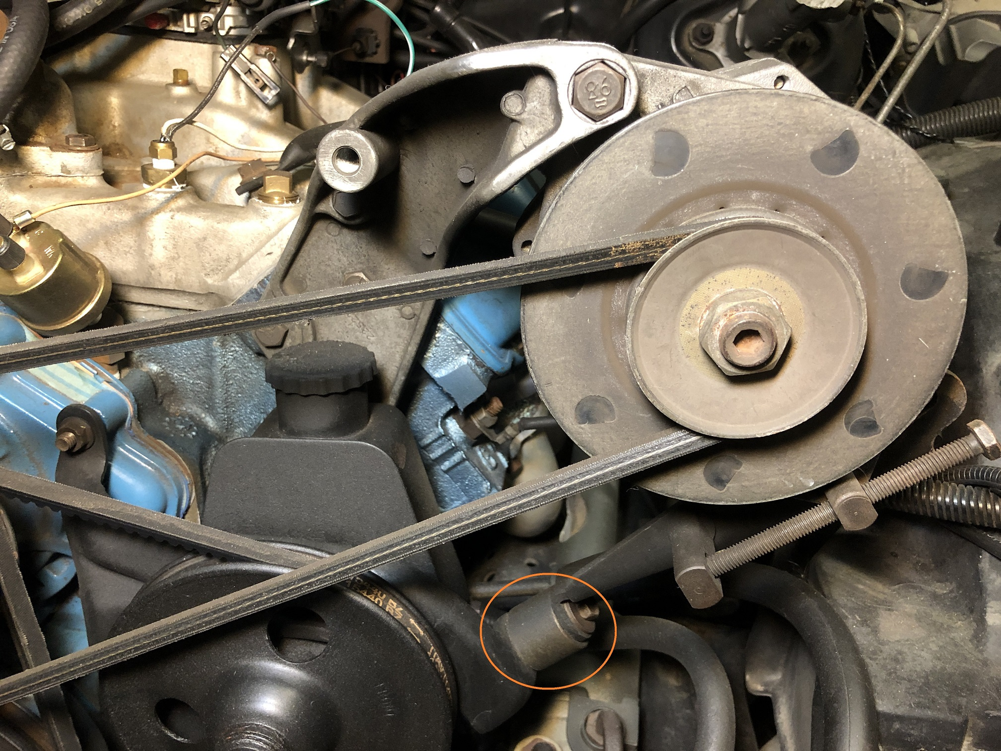

I know this is an old thread, But does anyone have a photo of the mod that needs to be done to the 307 AC bracket. The link above no longer works.

And don't forget the PS pump spacer.

Old Jul 2, 2024 | 07:03 PM
TURNA's Avatar
Joined: Jul 2022
Posts: 13
From: NY
Thank you for the pics.
Looking at these pics, the tabs have to be extended about 1.5 inches?
