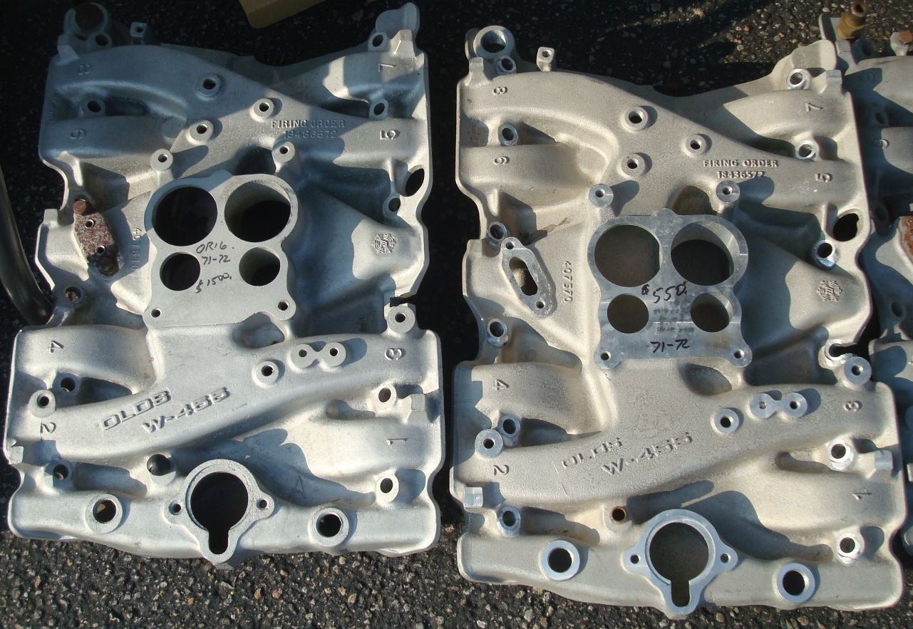

I don't know if this has gotten any better, but five years ago the repro intakes had some clear differences from original Perhaps this is a good thing. Note the differences in font, character size, and the FIRING ORDER letters. Also note the incorrect notch between the #3 runner and the heat crossover.
As for the original vs the O4B, the original W30 casting is geometrically identical to the iron intake, so there is no benefit in flow, only weight. The O4B has differently shaped runners, but you can't tell by looking at them if one is better than the other. Subsonic aerodynamics is not intuitive.
