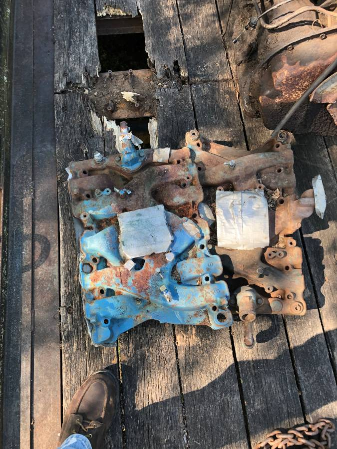

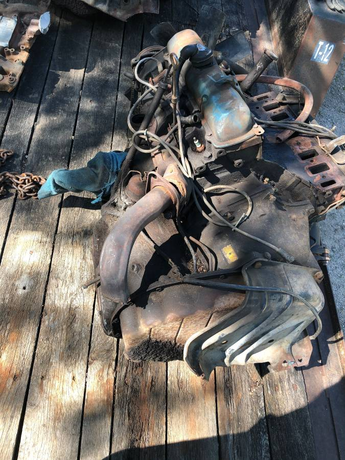

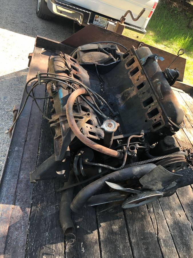

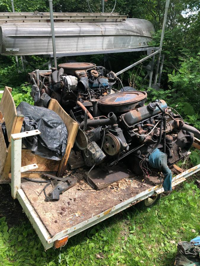

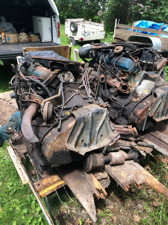

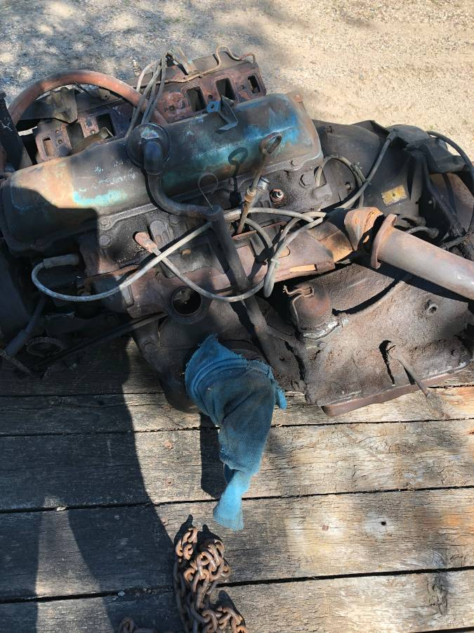

As I " have to start somewhere", I am going to dive into the purchase of the 455 engine first as this will ultimately be the heart and soul of the build.
There is a local option for a good price that looks to be a '75 motor (seller determined this based off of the numbers on the transmission, I will look at the codes on the engine to verify), I have heard that the later motors were not as strong due to the fact that they did not need to handle as much power as the '68 - '70 units.
I suspect this is a Fa block with J heads (J heads for sure as I can see in the picture). My plan is to either buy C heads or Edelbrock performer RPMs so I am not concerned with the heads as much as the block itself.
My main question right now is weather or not the Fa block is going to be adequate enough for my build, I want to make some good power but plan to drive it a lot so I don't want to overbuild it to the point that it is cumbersome to drive.
The seller states these motors were taken from Toronados and kept them for replacement motor home engines.
Wondering if this would be a good starter for my project or if I should wait for an earlier engine to come available.

However its never been proven one way or another that there’s any difference in the metal of an Olds block.
When I can’t tell you is that the later blocks, 73 and up, seem to have at least as thick or even thicker walls than some of earlier ones I’ve checked. Go figure.
I seriously doubt there is a difference in metallurgy. I’m guessing Olds was more concerned with casting enough blocks to meet demand, as long as the casting was good enough for their needs performance wasn’t a concern.
I work in a factory that casts aluminum. I wouldn’t be surprised that the later years would be cast thicker. The diemakers who repair the molds sometimes have to grind the molds to repair them, that would make the casting a little thicker. I know very little about how parts are cast, just have seen the molds and talked with a few die repairmen.
