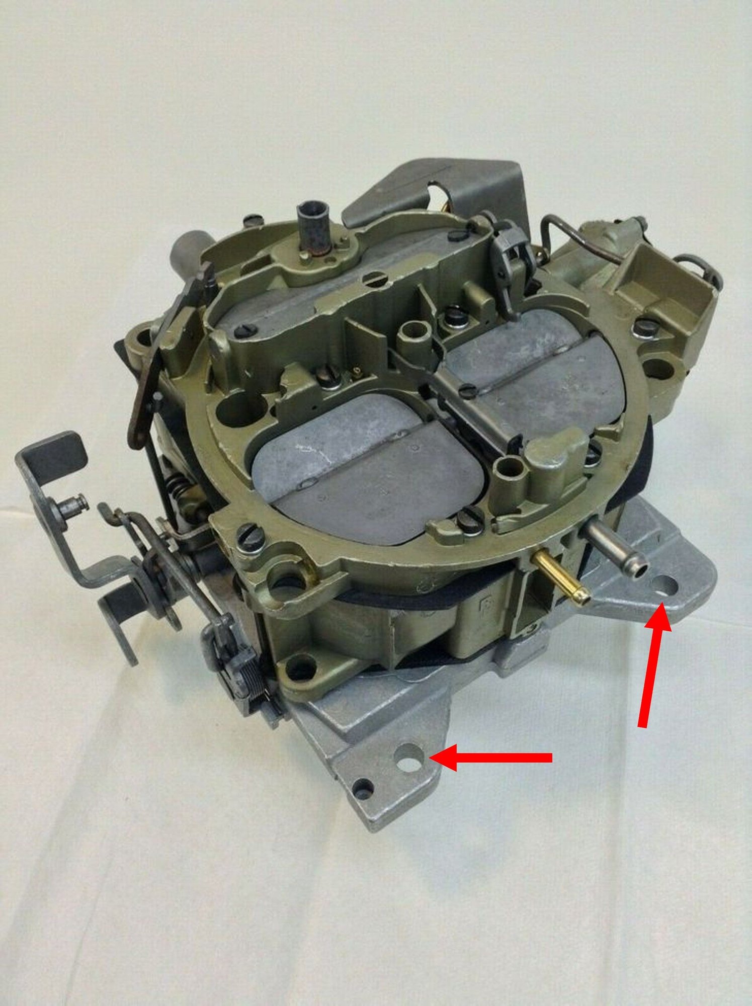

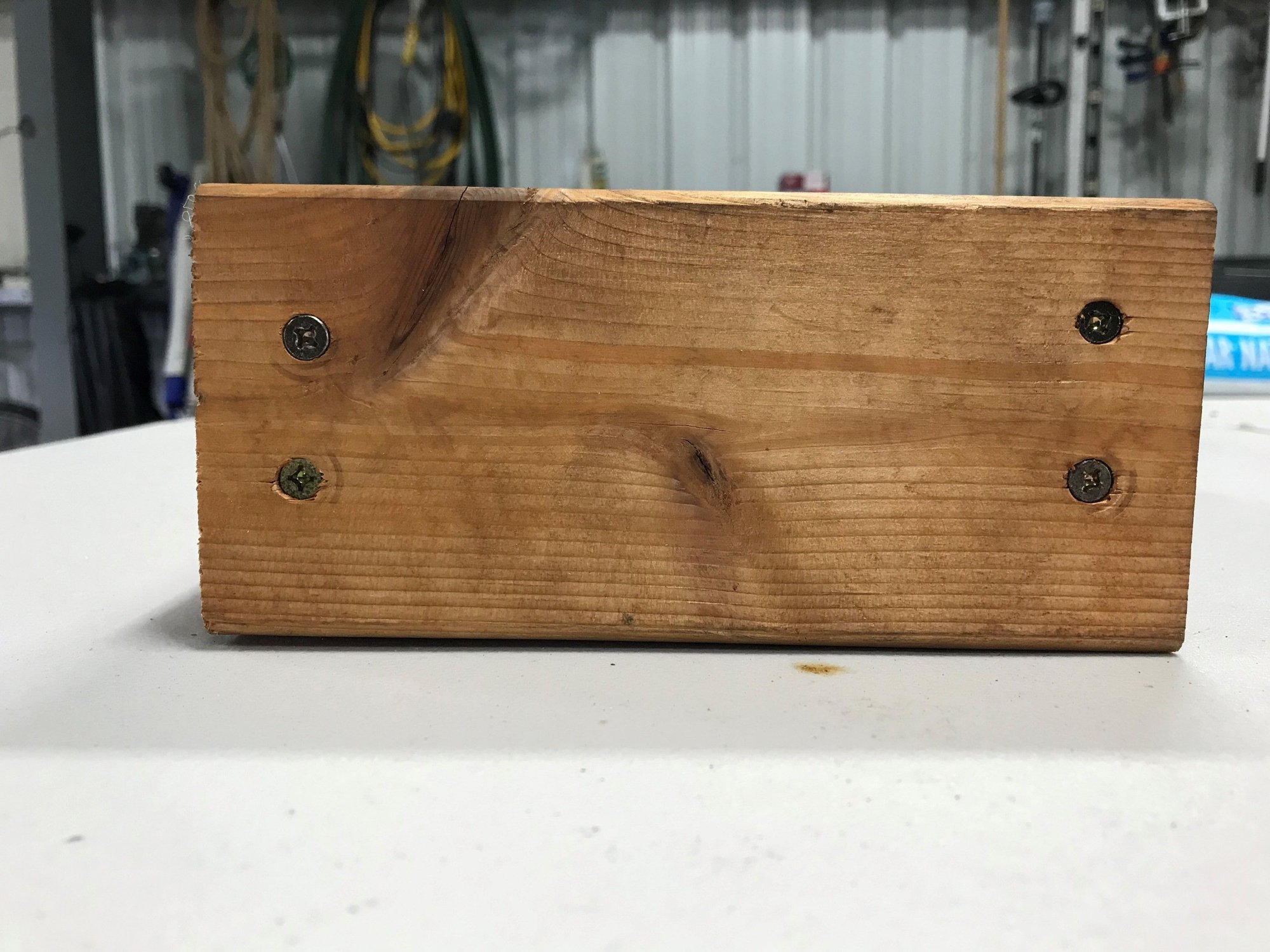

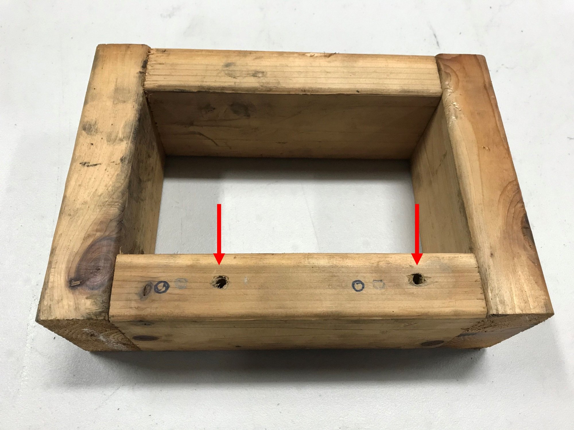

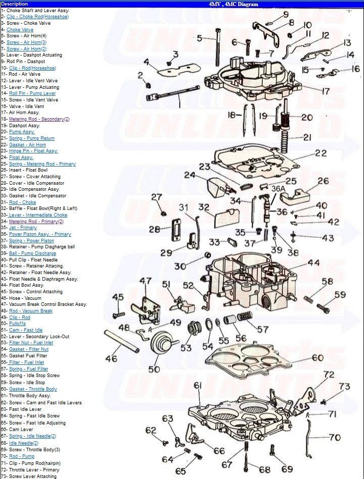

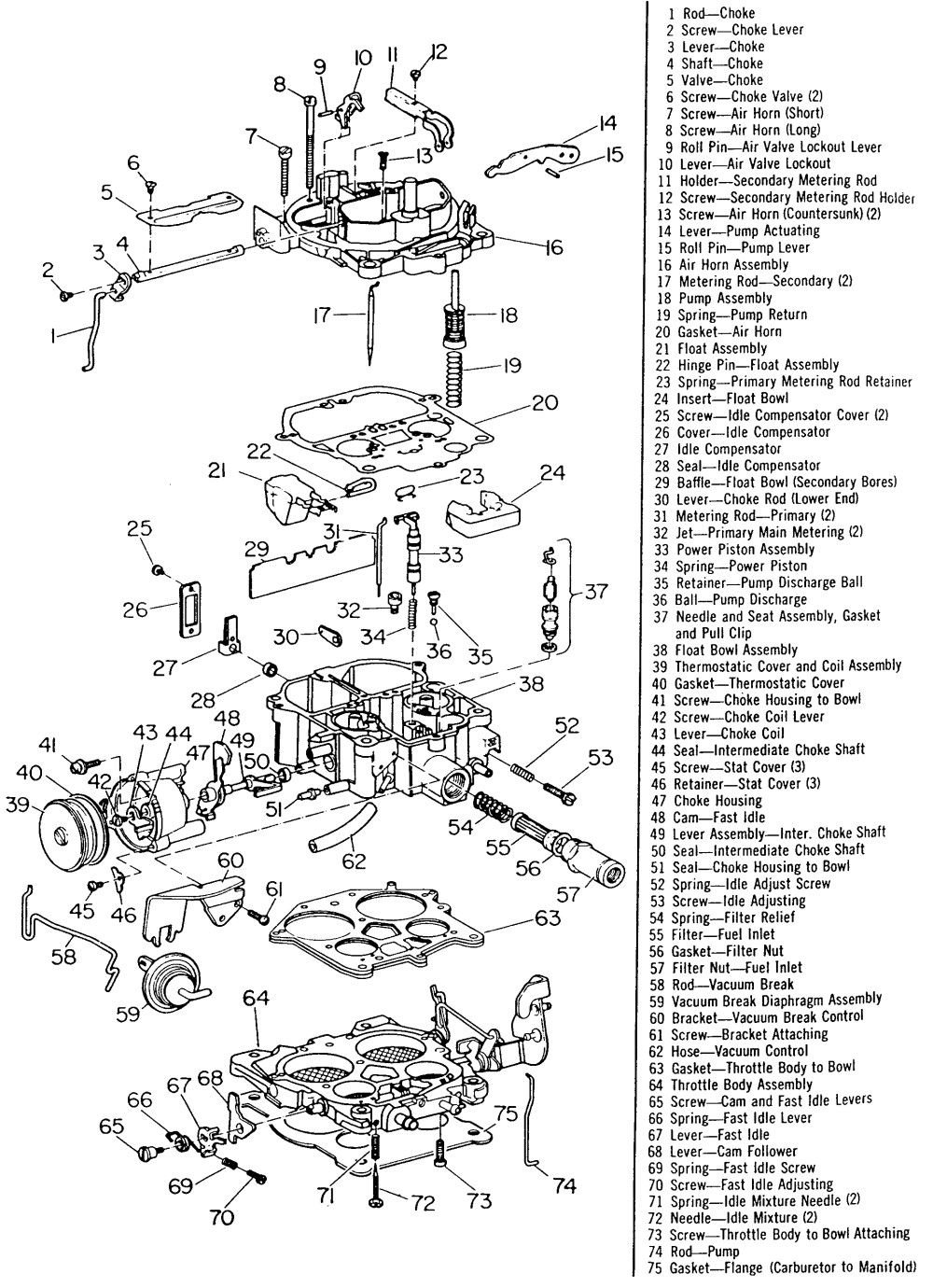

A small stand will create stability while you're working on the carburetor. I have a wooden platform made from scrap 2"x4" boards. You could also fashion nuts & bolts together to create (support) a free-standing platform - slide the bolts through the base plate holes use nuts to secure (tighten) the nuts/bolts to the carburetor. Liberally spray (soak) everything in the carburetor with carburetor choke/parts cleaner. I have a set of carburetor cleaning wires (needles) of various sizes but I'm not 100% you'll need any of them. Depends on degree of dirt/grime/gum buildup. One of those dental picks (cleaning tools) works nicely to dislodge junk in the corners/crevices & a handful of Q-Tips. Recognize the names of the parts (a diagram helps). I'll provide you w/ a couple basic diagrams & a URL link (below). Essentially, there are three pieces from top to bottom:
(1) Air Horn Assembly, (2) Float Bowl Assembly, (3) Throttle Body Assembly (with a gasket between each). Pretty simple stuff, really.
URL link to a basic diagram >>> https://www.carburetion.com/quadrajet2.asp

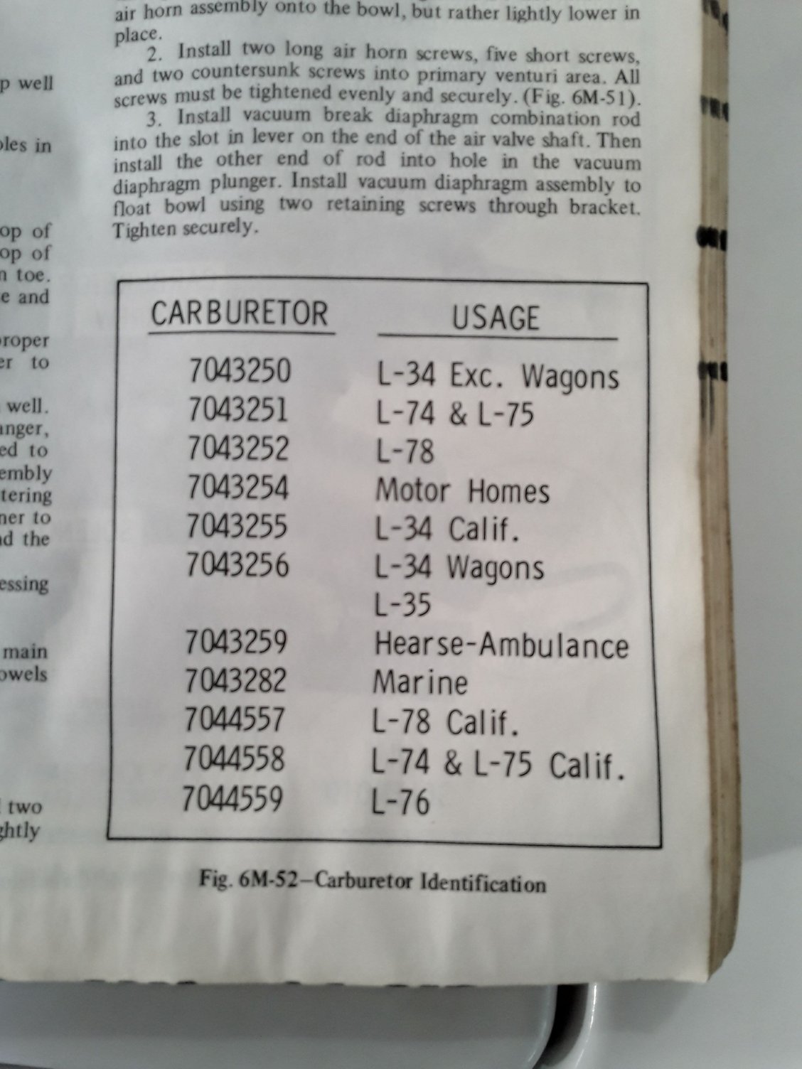

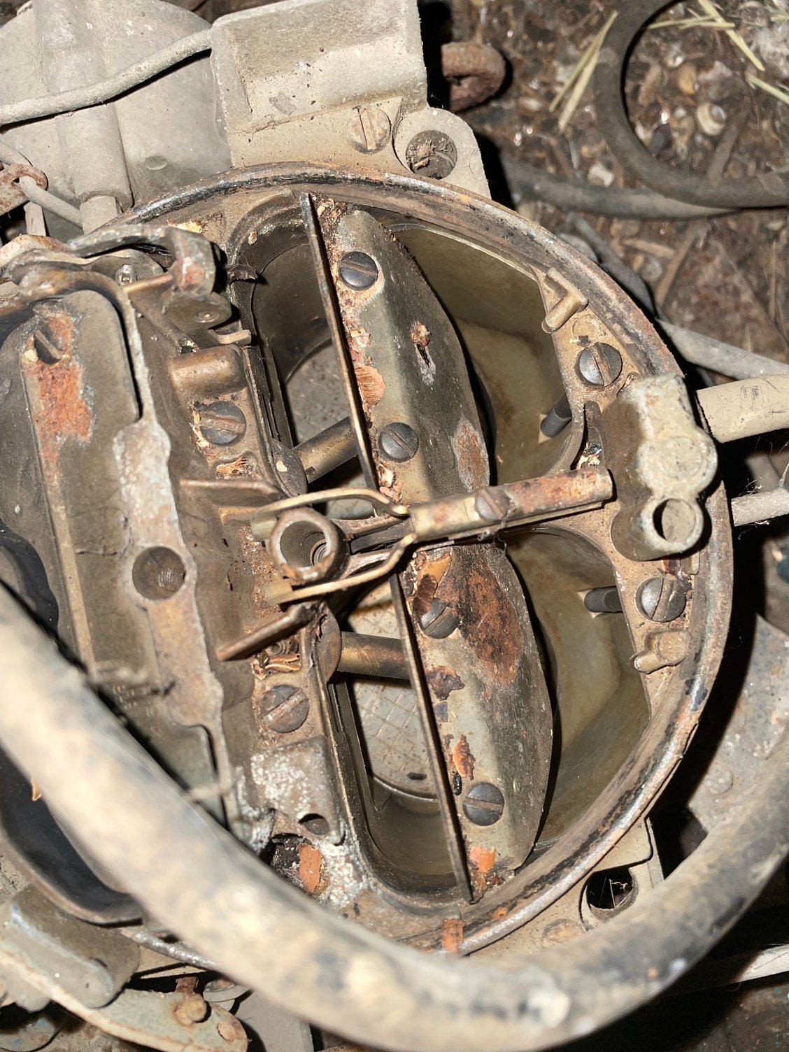

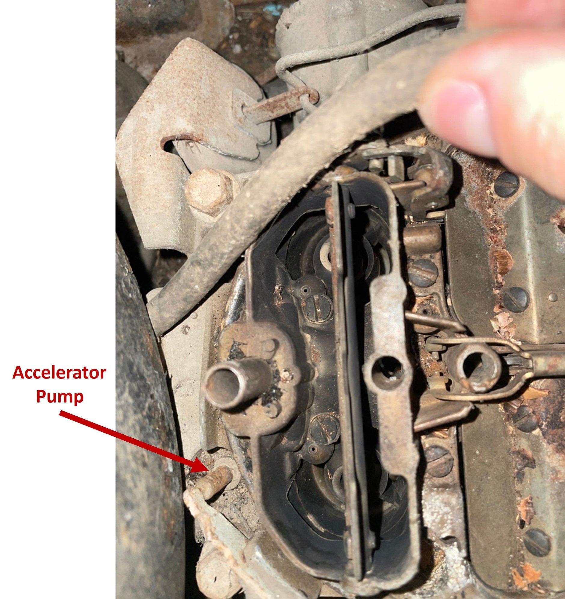

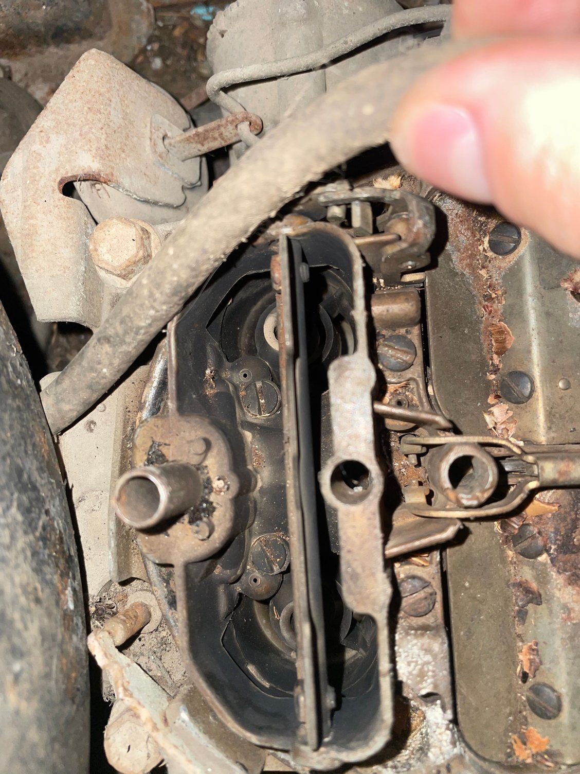

So i just checked the carb and it has #7043250 stamped on. Now the question is, can i have an idea of the condition of the carb by opening the choke plates and looking in? Honestly it doesn’t seem so bad for a car that has been sitting close to 30 years. According to my uncle, he and my grandfather who was a GM mechanic rebuilt the engine and carb but didn’t drive it due to paperwork problems. I know I’m probably gonna need to replace gaskets and seals but I would have a clearer view on the engine condition too by knowing if the carb is clean.
Old Nov 2, 2023 | 01:10 PM
Posts: 26,066
To specifically answer your question "...is the carburetor clean..."? Based solely on your images, the answer is no - the carburetor is not clean. Don't base engine condition on carburetor condition - they're two entirely different beasts. The carburetor needs a good cleaning and a rebuild. Rubber, nylon, gaskets, the accelerator pump, the fuel inlet spring, fuel filter, etc. all need replacement and come w/ the rebuild kit. I've already provided recommendations on cleaning. That carburetor needs a good cleaning. Additionally, you need to spray the linkages thoroughly and basically follow (once again) the recommendations I already provided.

From 1974 Olds Chassis Service Manual. If you don't have one yet it should be your next order of business. The CSM covers a complete teardown, assembly and adjustments on your QuadraJet. Along with about any other service procedures your 442 is likely to need.
Going by this, if it's a 350 car sounds like it still has its original carb.

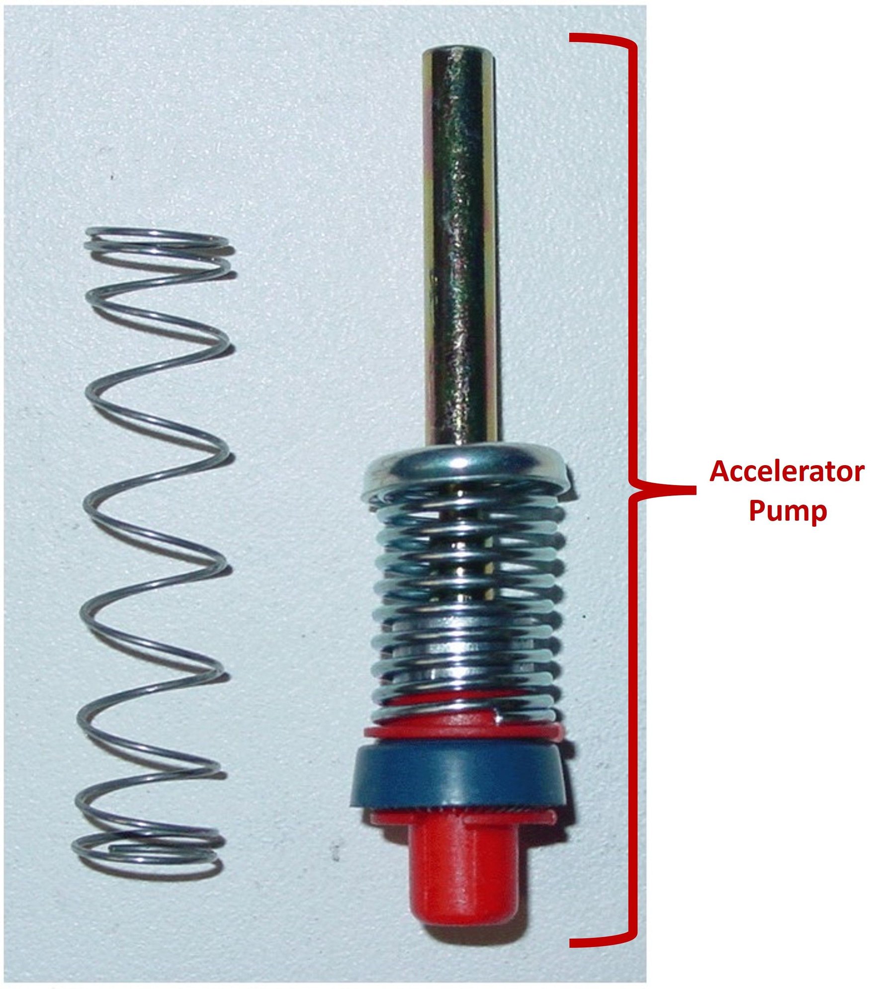

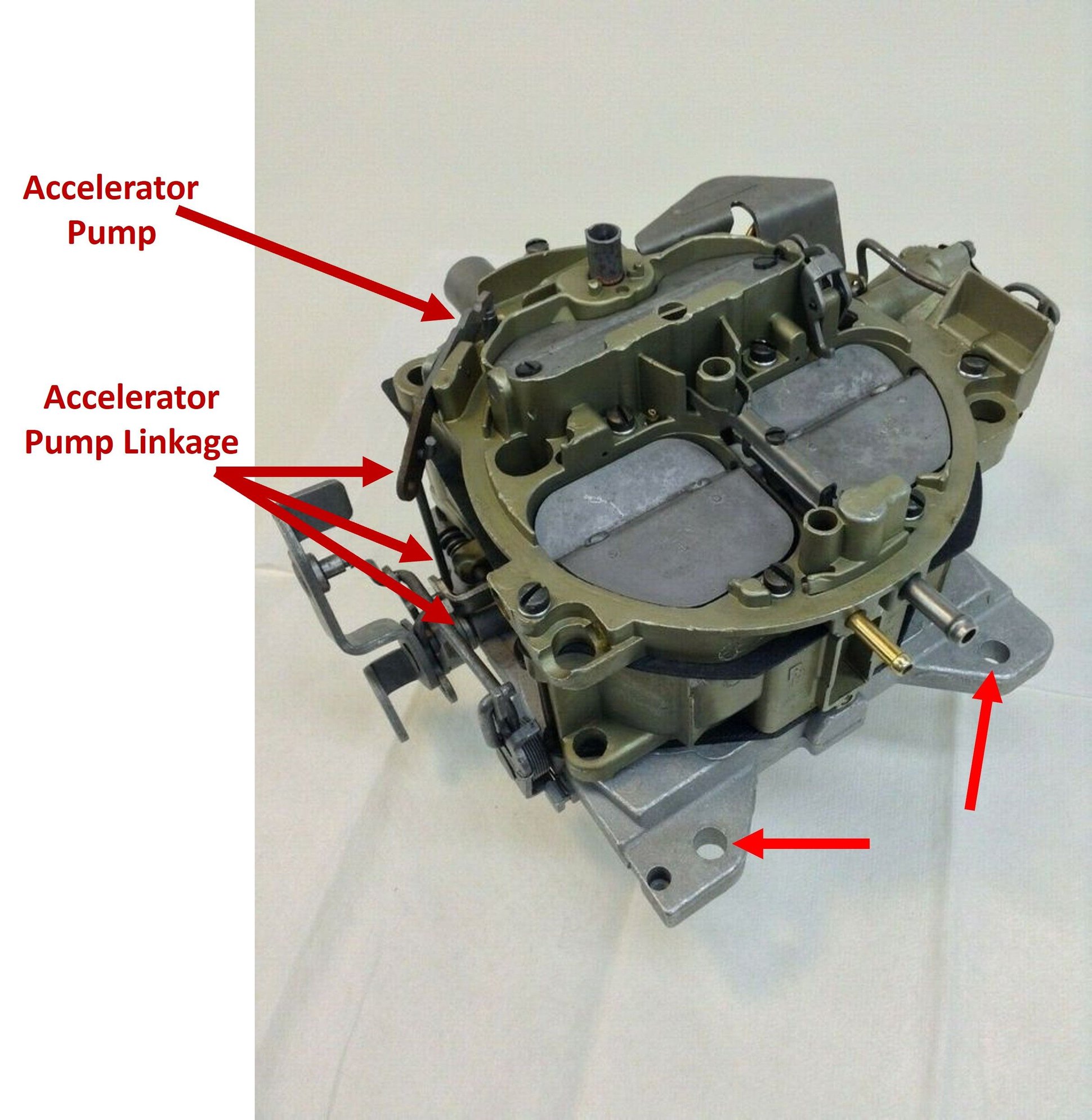

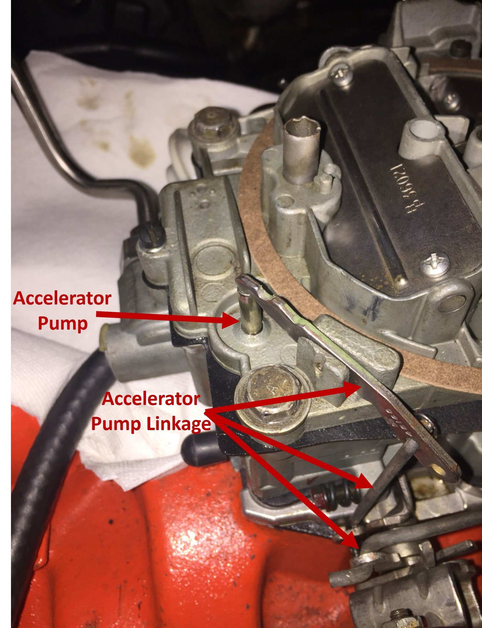

Ensure the rebuild kit you order comes w/ a new accelerator pump; if not, ensure you replace the accelerator pump for smooth consistent fuel delivery. Older accelerator pumps don't hold up well to today's alcohol/ethanol fuel blends. The rubber cup on yours is most likely cracked & torn in addition to the springs having collapsed. Below, a review of your accelerator pump & a daily driver rebuild.
Your carburetor accelerator pump
Off the shelf carburetor (reconditioned)
Daily Driver (rebuild kit)
New Accelerator Pump
