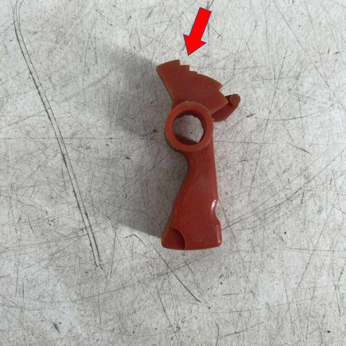

Either way, the fast idle cam is linked directly to the choke coil. There are a number of steps on the cam that are intended to gradually lower the fast idle speed as the choke (and thus the engine) warms up. If it goes directly from fast idle to slow, it isn't adjusted properly or the coil has lost tension. It's also possible that the plastic fast idle cam is damaged. Adjustment is spelled out in the Chassis Service Manual.

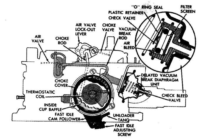

My '71 350 4 bbl did this when I bought it. Texas car. Never needed choke. Fast idle cam was sticking. Was adjusted w/ no fast idle. I loosened up the cam so it moved freely. Then adjusted the choke coil counterclockwise until it stayed on for a while til warm. CORRECTION. Wrong picture for a '66 carburetor. Can't read.
Old Dec 3, 2022 | 10:18 AM
Posts: 50,770
Originally Posted by Falkon

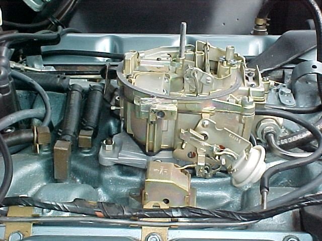

Just so there's no confusion, the 1966 Qjet uses a divorced choke, not the integral choke shown in the diagram above. This is what a 1966 looks like:
Old Dec 3, 2022 | 10:22 AM
Posts: 50,770
A better shot of the 1966 choke setup.

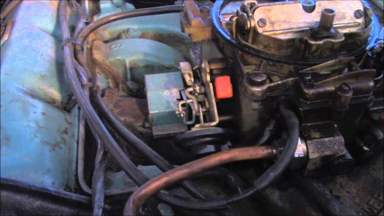

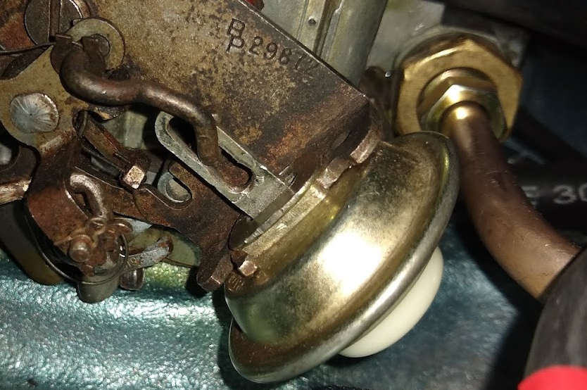

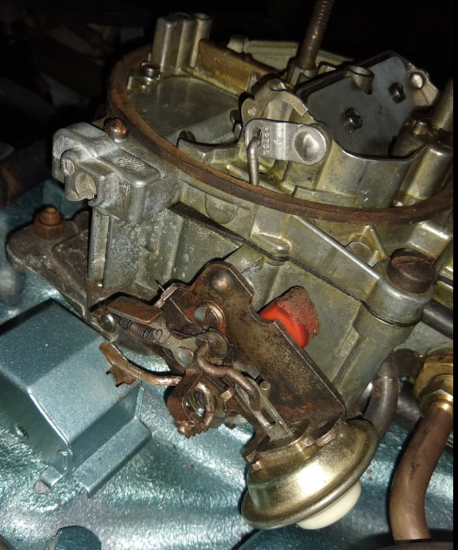

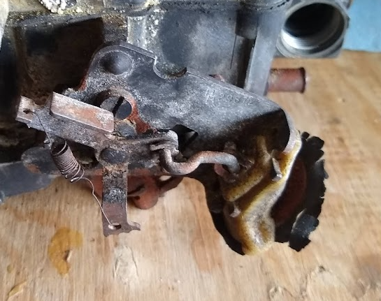

I went through all the adjustments and I'm so close. Currently, the fast idle will set and when I kick the throttle it only drops down a single notch on the cam........perfect! The only problem I have right now, I think, is that the choke isn't getting pulled off quite enough by the vacuum break when it first starts. I have to open the choke ever so slightly with my finger to keep it from loading up. I tested the vaccum break and it's leaking so it's not pulling on the choke enough.
From what I understand, the original vacuum break on my car is a one year only item (66') and reproductions are not made so they are pretty much un-obtainium without shelling out big cash for old stock. My cars original vacuum break was destroyed in a small fire so I cobbled one together from an old one (it looks identical but doesn't have the long slot - just a single hole for the linkage). I just measured the slot in the old one and copied it to the new one by drilling a bunch of holes and then using a dremel to make the slot roughly the same size. Anyway, I guess the break I used was leaking internally so I guess I'll have to try making another one and trying again.
My original, fire damaged, choke with destroyed break
My "cobbled together" solution. Unfortunately, it leaks.
As currently installed on the car. The choke is the one from the fire damaged picture.....it cleaned up decently.
