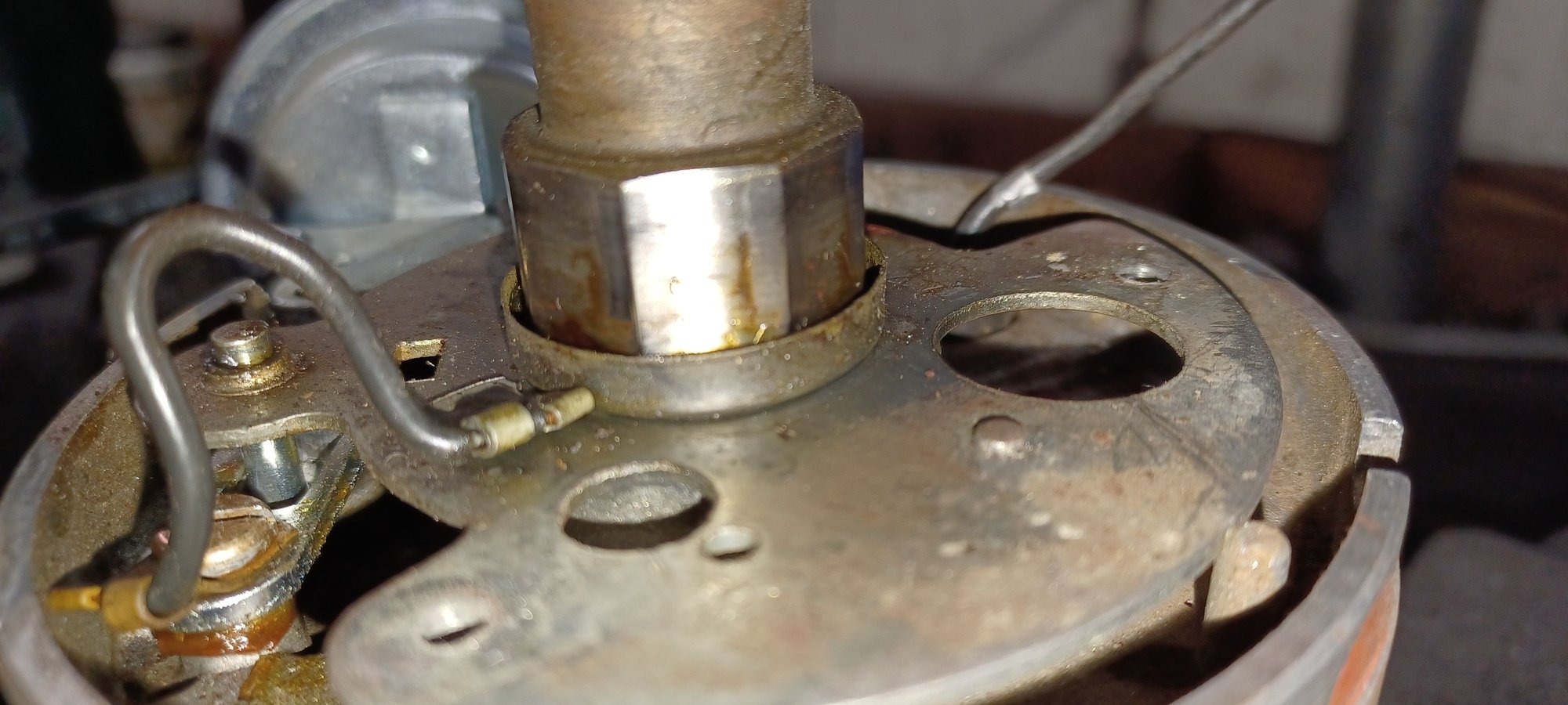

The main reason is I see dwell variation which means distributor shaft/busing wear, its old and expected.
Also seen capacitors fail, and yes points are reliable untill they shut down for months during winter and resistance from corrosion sets in.
Wanted to keep the original proper distributor look naturally, but I could also run a hotter coil.
Lets discuss those reasons, open to all input.

Yes I could do the bushings and I don't know the condition of the point cam, but I do know its ancient.
Seens caps fail out of the blue just like MSD boxes and lots of no starts with oxidized points after lay up in boats for the reasons I gave.
I also lost a 400 marine engine that detonated from one of these point less kits and the manufacturer backed up the subsequent overhaul, it was RFI that messed with the timing in some unknown way I saw it on a timing light.
Thats why I was looking for a higher end kit like Gary posted
It just seemed like a simple solution vs a full overhaul of the distributor for the sake of keeping the points.
As it happens the distributor is coming out for an intake change, so I may look hard at the wear and condition then.

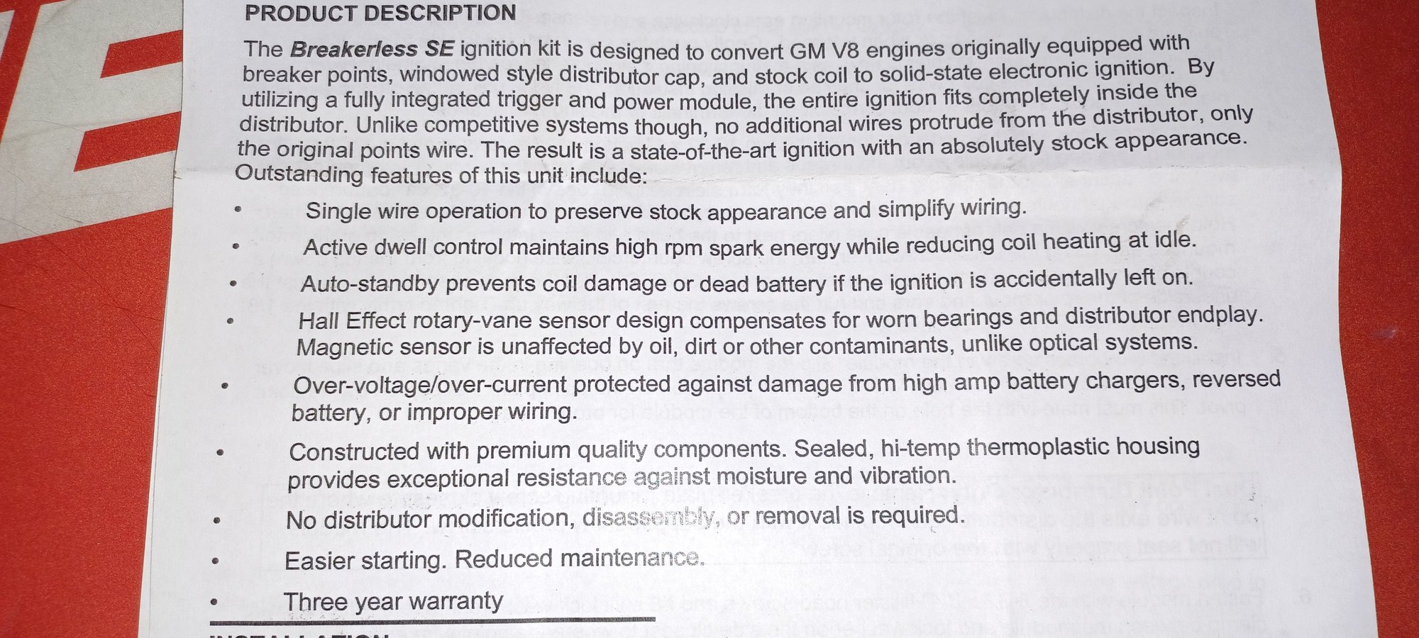

I have this in my son's car, It is GREAT, IMO. I will use these in all/any old car I have from now on. As linked above. For some reason I can't post the link.
Breakerless Ignition

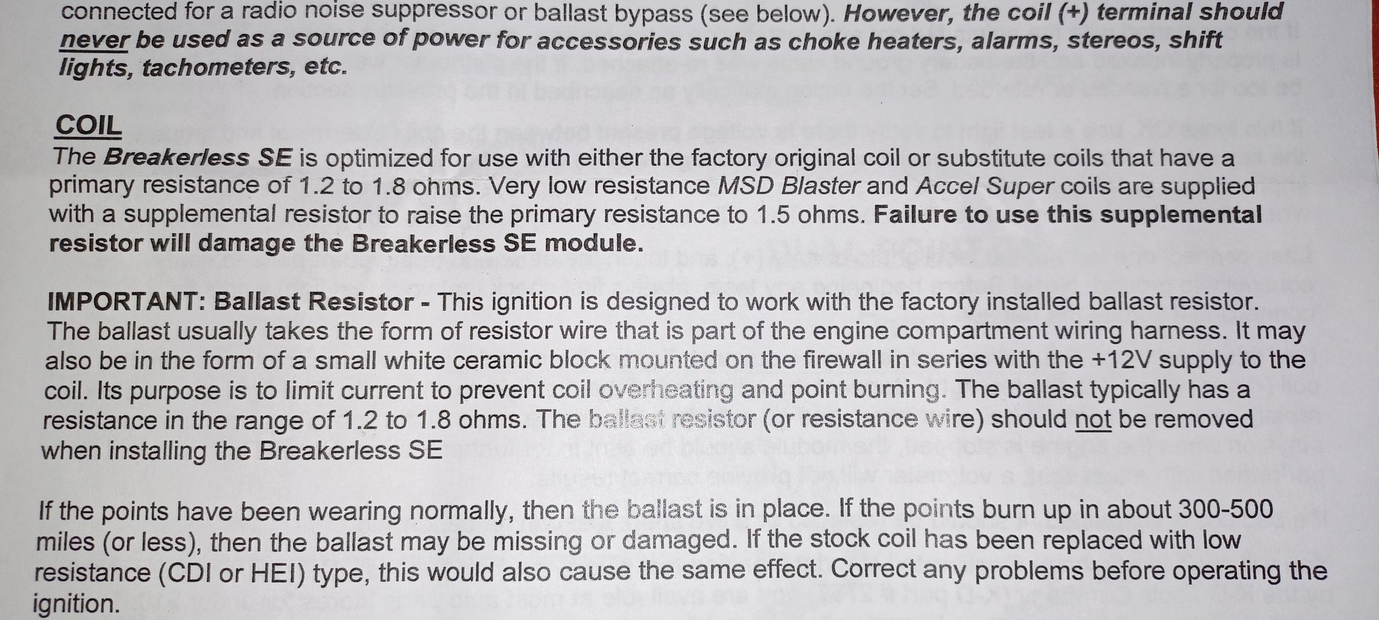

I hear about Pertronix failing. What I have seen and read, is it will run on the resistor wire. I did it on a 72 VC. But If you do it that way, sooner or later it will fail, mine did. I read you need to run a full 12 volt to the system, even If they say it will run on less.
Old Nov 30, 2022 | 06:43 AM
Rick Hodgkins's Avatar
Joined: Oct 2020
Posts: 140
From: Freetown, Massachusetts
Anybody know the location of the resistor/wire in the harness so it can be eliminated?

It's connected to the coil+ terminal and runs to the firewall. Be sure to read the installation instructions for your unit and coil.

The resistance wire is crimped to the coil connector along with the bypass wire that runs from the starter. Note that some aftermarket systems don't require you to remove it.

The Breakerless modules have been rock solid for me, both driving and racing the car, and I can't find anybody who complains about them - definitely my number 1 choice. Timing is dead steady without bounce. I've seen points corrode from sitting, the contact pads fall off, and they need checking/adjustment. That being said, I'd still use points over Pertronix or other conversions.

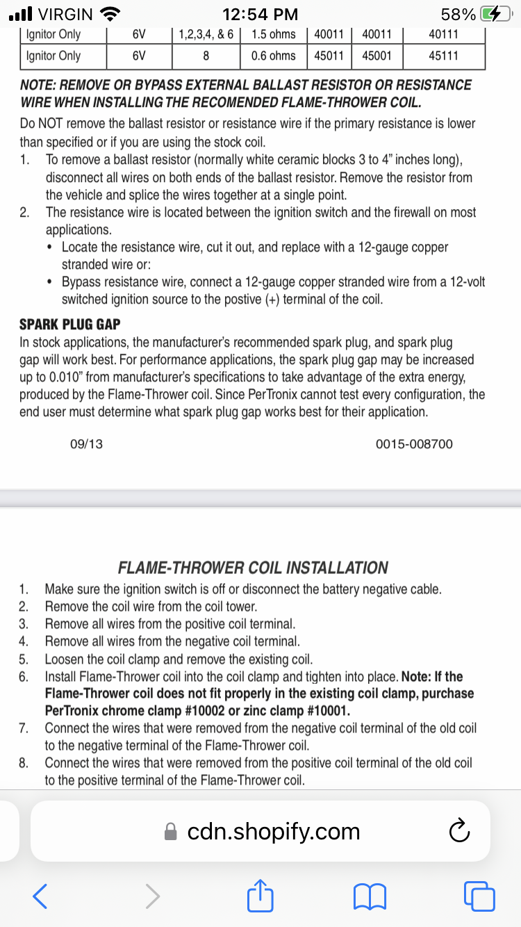

Taking in all "points" and opinions on this, so I went back to the instructions again.
All companies make tall claims about their products, thats why I ask end users.
My reasons for wanting this are pretty well spelled out in their feature descriptions.
As for the resistor, as I was directed back to the instructions, are to NOT remove it.
So now my head is spinning with all this back and forth.

How so? This particular unit is designed to operate without removing the resistor. Install (and subsequent removal after failure) is easier. It uses the stock coil, so there's zero benefit from a hotter coil. Again, all this is is an electronic on-off switch that replaces the mechanical on-off switch that was the points. I don't know what's confusing about that.

I am not confused in the least how these work,
Maybe you could explain how dwell variation changes the hall effect timing window for me.
I think that’s the biggest problem with them…it clearly says must have a minimum of 12volts.
I’ve used them many many times for years , never had one come back. That’s with the built in rev limiter . In fact, I have reused some that were supposed to be bad…they were fine.
I do a lot of stock style sleeper builds where a small cap stock dizzy is required. The pertronix with built in rev limiter, good MSD cap&rotor with brass contacts, black MSD 8.5 wires with the white letters rubbed off and MSD blaster coil painted black is reliable as it gets.😎
They are CLEARLY saying NOT to run this on 12v, so that all of this is what is making my head spin not to mention Luke's poat back slapping all of the features and greatness of pointless, then saying he'd rather run points lol.

Originally Posted by Rick Hodgkins
What is confusing is I am getting conflicting comments.
Conflicting info from the interwebs? I'm shocked, SHOCKED I tell you.
Seriously, I think the manufacturer usually knows more about how their product works than the Interwebs (OK, not always - witness header manufacturers that still claim their headers don't fit Supremes...). As I noted above, SOME electronic conversions are designed to work with the resistor left in place. As for reliability of a specific product, none of these responses have enough of a sample size to be statistically meaningful. SOME electronic conversions do have features that are improvements over points, but most do not. Unfortunately your ability to get this info from each manufacturer may be limited. Extending the dwell window electronically is one benefit, but few of the replacement manufacturers even discuss this in their specs, so conservative assessment would say to assume those do not. I'll also point out yet again that NO aftermarket part has had the same level of engineering and performance/reliability testing as factory parts. Your call on whether or not that means anything to you in your reliability assessment.
Well gee wiz Joe, are you reading the other posts on this?
What is confusing is I am getting conflicting comments...
Which is why it was suggested in post 27 to read the instructions, they are not all the same. In addition, Pertronix uses the resistance wire if you're using the stock coil, but requires 12v on the module itself.
this is directly from pertronix site. I’ve only used the ones with built in rev limiter and aftermarket coils. Like the pertronix ones that do not need resistance feed. They need a full 12v
