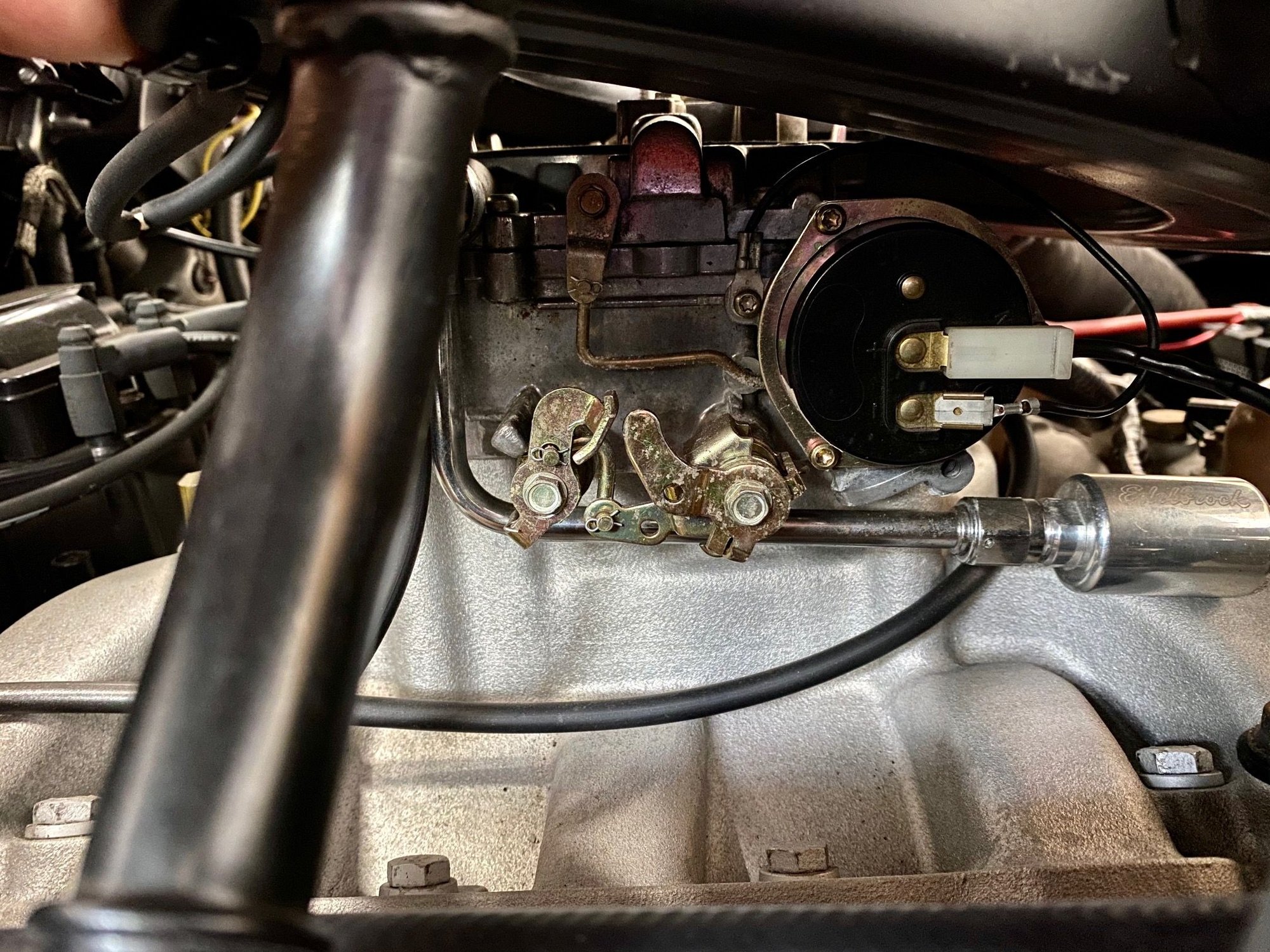

Can you post a picture of the pass side of your carb with the air cleaner out of the way so we can see the choke thermostat?
I've got OAI snorkles attached to my air cleaner but I've lifted it here for the third pic. Does this show you what you wanted to see?

My bad, I'm an idiot lol. Here are pics of my carb from the passenger side:
Old Mar 29, 2020 | 11:07 AM
Adjust the screw in this picture clockwise a 1/4 turn until you reach 750 rpm on your tach and see if that works for you.

Carb as stated is an Edelbrock vs an OE Qjet. It does have what appears to be an adjustable choke thermostat, the black round disc with two wires in the last picture. Ask the mechanic that last worked on it if that was adjusted, if not ask what was adjusted.
I'll give that a go - thanks!
BTW, there's a screw behind it that you can't really see. The mechanic told me that it's for my fast idle. Should I dial it back from the 1,600 rpms I'm getting now with the choke set?
I like them set at 1400, but that's not much of a difference.
