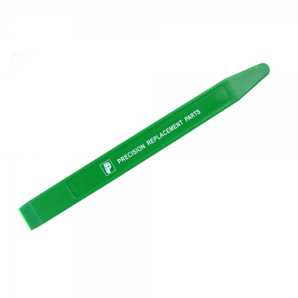

I recently found out getting a 57 year old original one out is harder than installing a new one.
Heat and silicone grease with assist from a pry stick like this.
Also, use sealer or it will weep oil.
