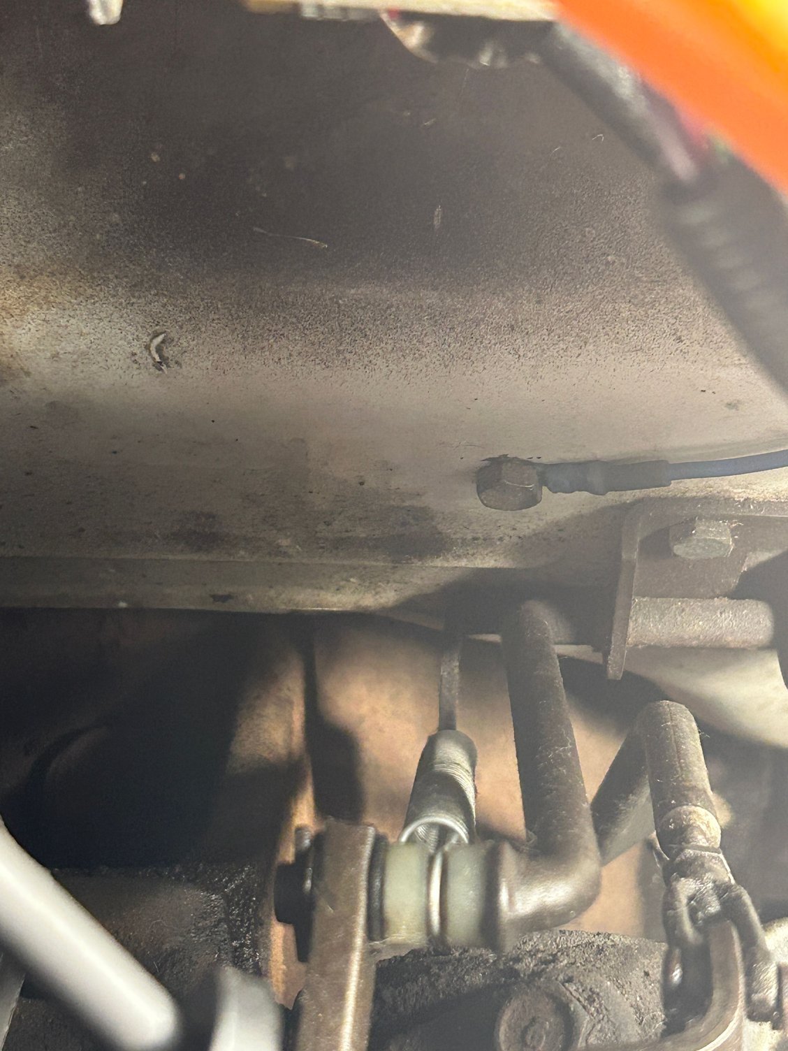

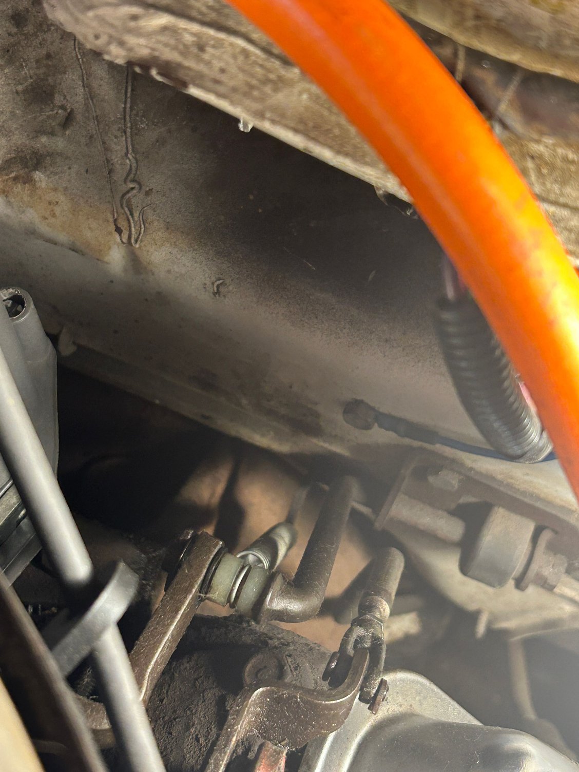

So, all in all, maybe not a bad idea? A couple pics of the setup on my Rochester 4GC carb with the spring.
