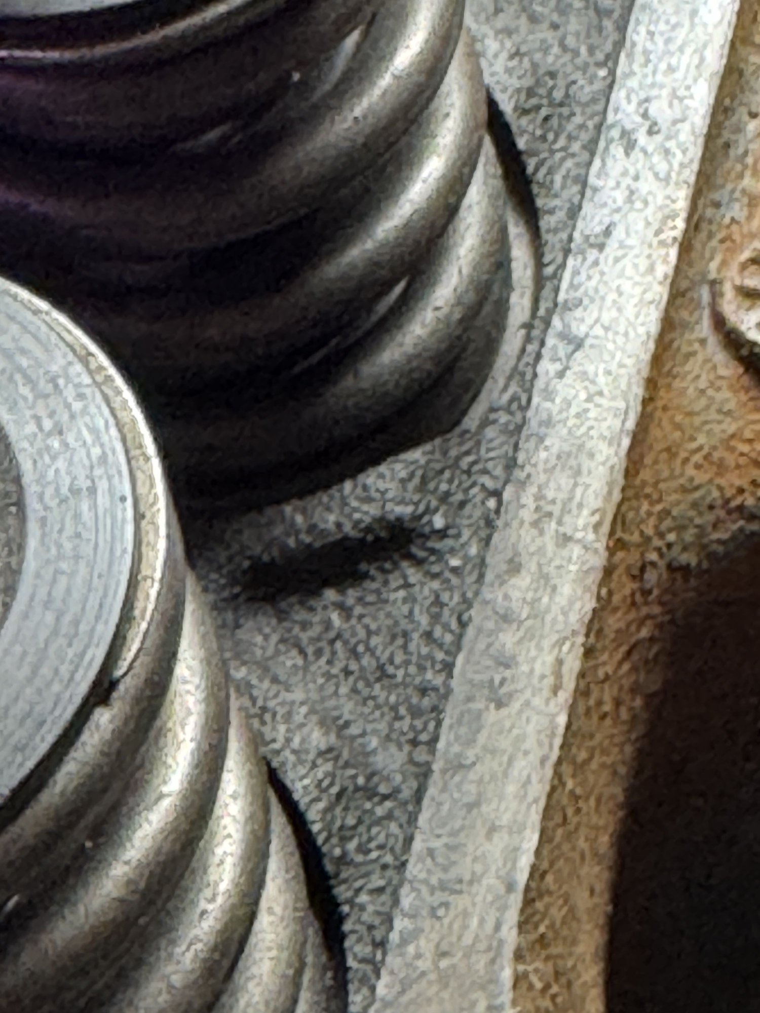

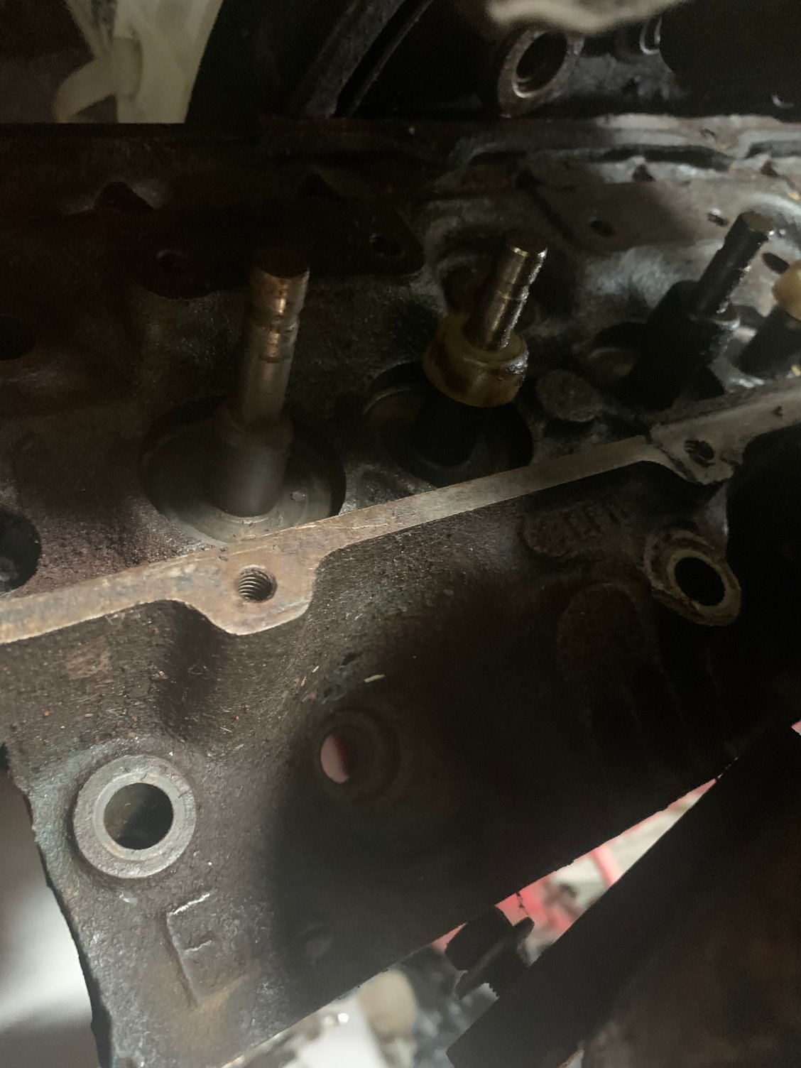

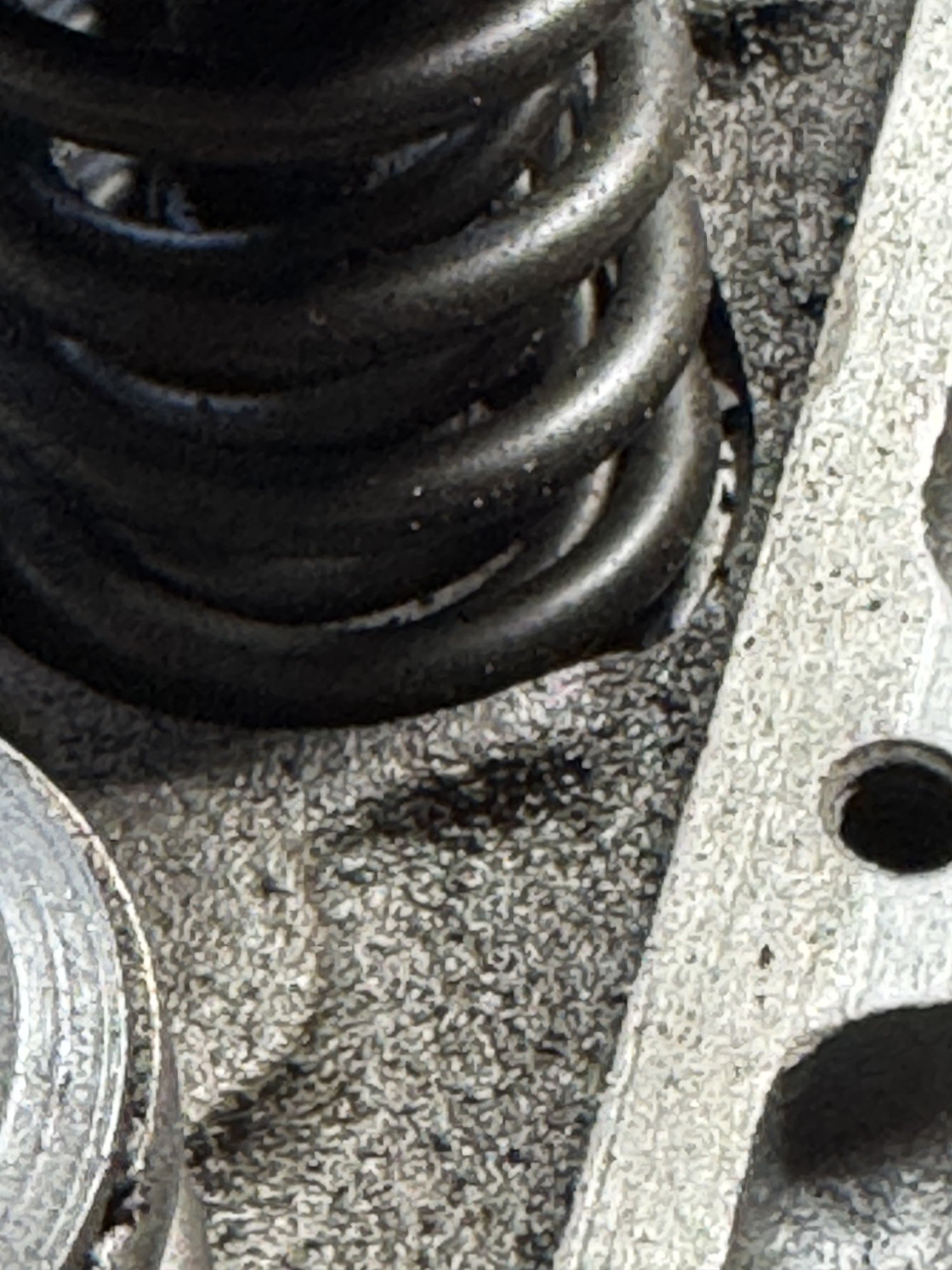

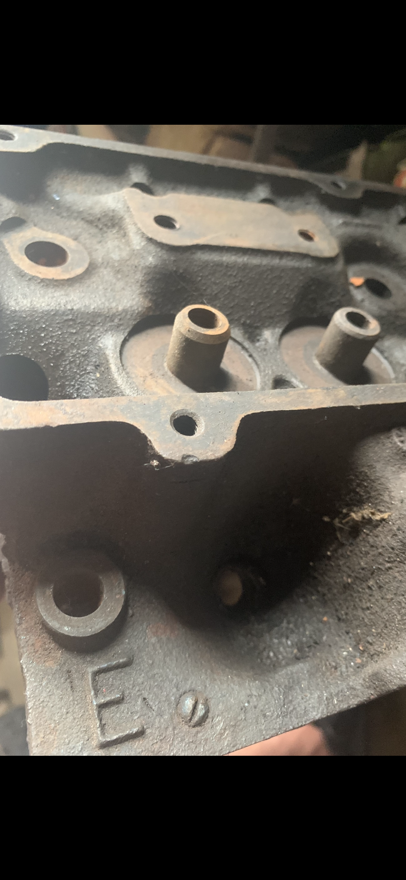

CANADIANOLDS, big thanks for pointing out the E head revision mid-year—I wasn’t even aware there were two versions under the same casting number. My car is an early build (01/70), so I assumed I had the early-style E heads without the deeper spring pockets. But after inspecting and snapping a few closeups, it turns out mine have the deeper pocket design you described—visually identical to my F heads. So it looks like even some early ’70 builds ended up with the later-style heads. That was a great call to check.

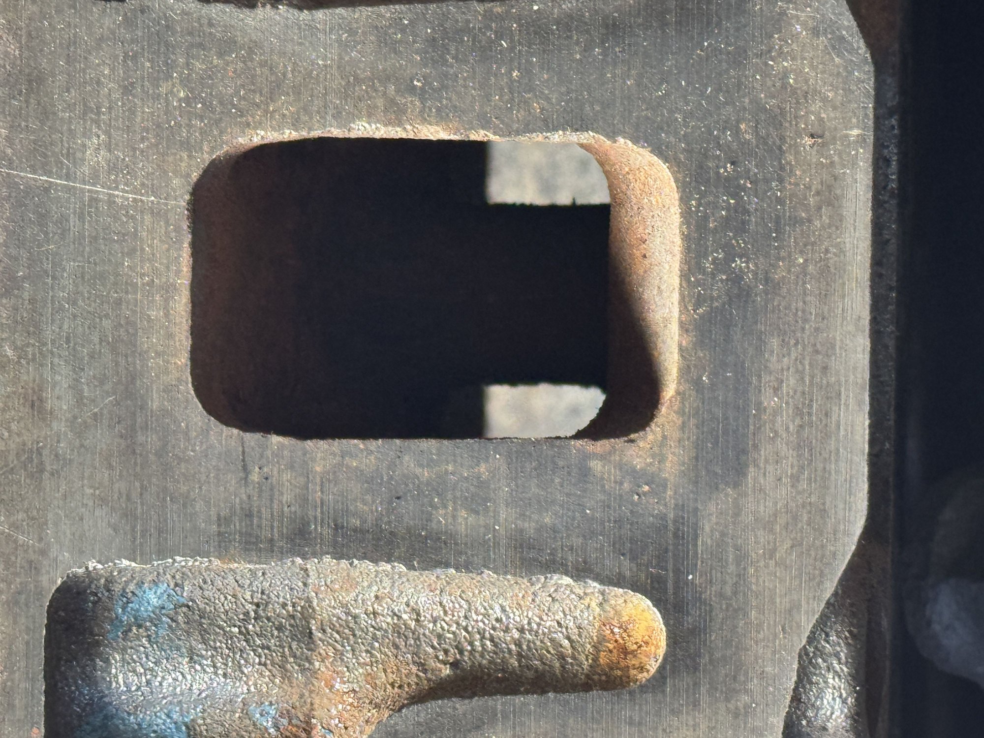

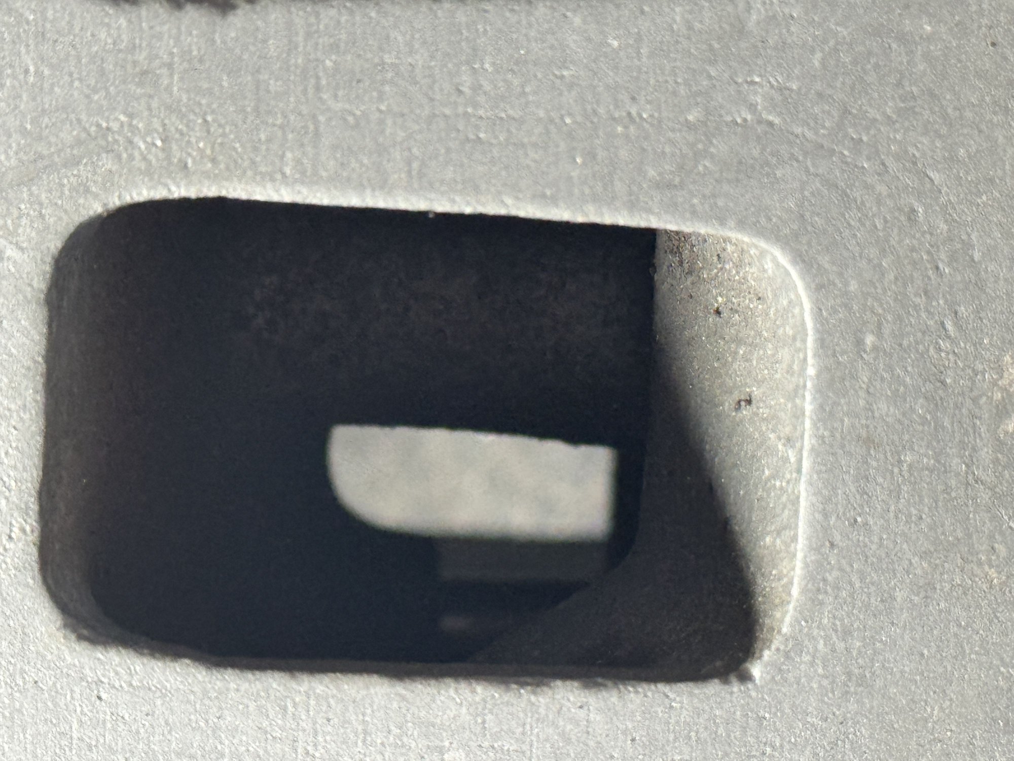

I also attached pics of both the E and F center exhaust ports. Visually I can now see the one side of the F blocked, and understand the crossover and internal shape make a real difference.
On that note, I dug up some flow numbers comparing stock E and F heads. At 0.400 lift, the E heads flow noticeably more on both intake and exhaust (243/147 vs. 227/144), and that advantage mostly holds at 0.500 too. That said, the F heads still seem to perform well despite the slightly lower flow numbers—probably due to the blocked crossover and center port design. Curious if anyone here has tested or confirmed similar figures, or if these numbers sound accurate to you?
Hammerdrop, shiftbyear, and cutlassefi—you all brought up a great point about the two center ports on the E heads fighting each other. That crossover flow design really seems to change the game beyond just CFM numbers. That said, I will be using the w-30 aluminum intake if that makes any difference.

I think that pic of the E head is the second version..which is deep seats on intake only. hard to tell because the pic is so close. Can you check to see if both seats are the same depth or a pic further out.

CANADIANOLDS, thanks again for helping break down the seat differences. I went back and measured the spring pockets—both seats on my E heads match the depth of the ones on my F heads. So that confirms they’re the later-style version with the deeper pockets.
