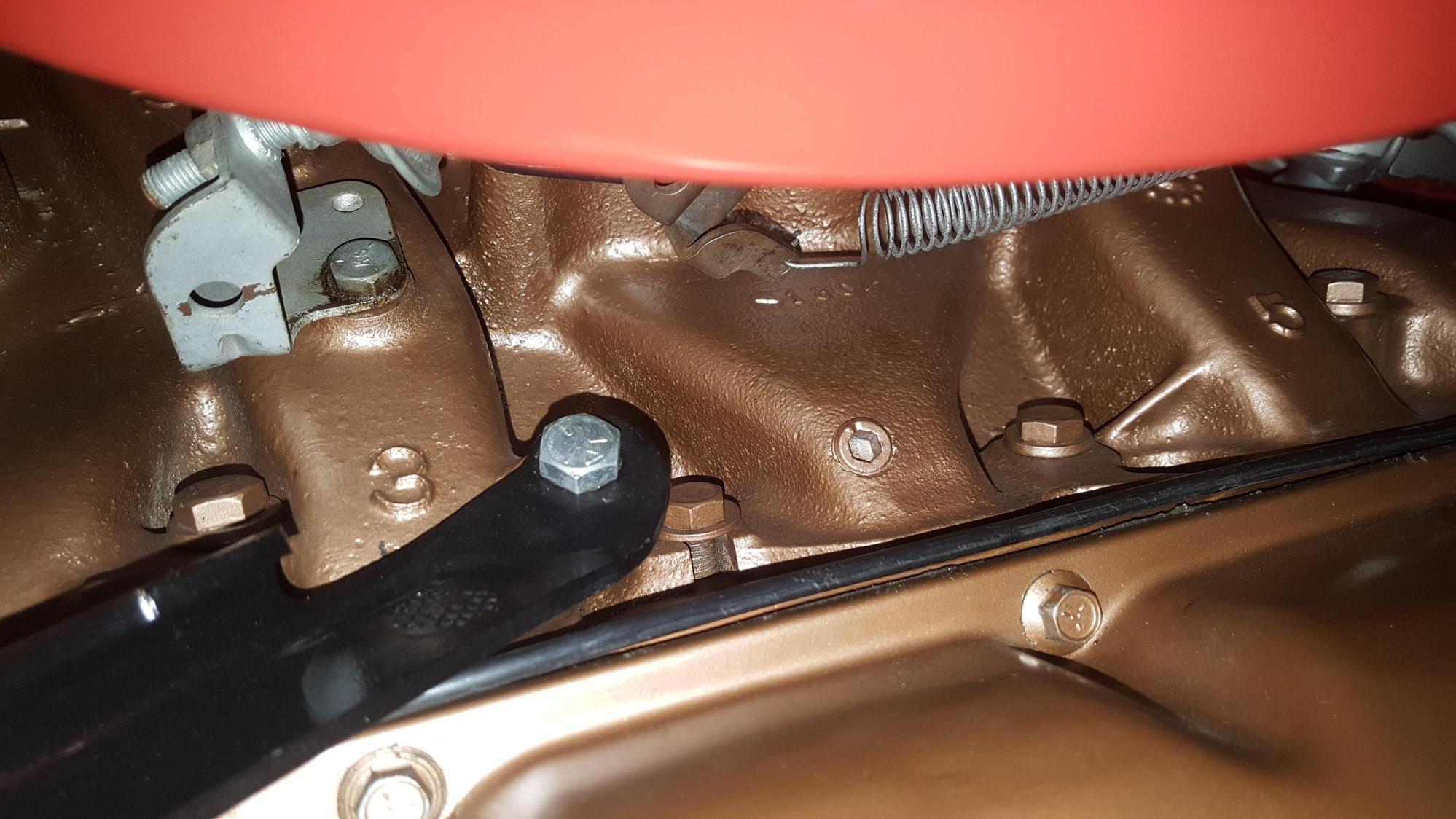

Removing the valve, its spring, and shaft from the manifold is a subtle upgrade.
Only a trained eye or a PV evaluation on a museum car wouldn't pass the originality test. (PV = performance evaluation in NCRS Vette speak).
You could source another manifold to weld on.
The cast block off plugs in the intake are meant to be installed into the heads. But I chose to recess them into the intake and spot welded them in. They could be removed. You cant see this modification.
I needed to solve recurring hot a starting problem from fuel boil off, and I was in search of ways to increase HP with out adding aftermarket crap.
This mod cured the hot starting. AND the paint doesn't burn off the intake. I installed 69 400/455 exhaust manifolds in my 68. Still have the mint 68s on a shelf
