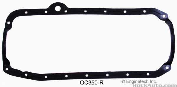

I know this is an old post but it helps when researching these subjects. I needed to order an oil pan gasket as well for a 455 and see that RockAuto lists a 1-piece oil pan gasket, with a picture, from EngineTech (ENGINETECH OC350R) if you search for 1980 Olds Delta 88 Diesel for example. Its currently not available or maybe never was available but its the only 1-piece I have found so far.

Rock auto shows that gasket as being for a SBC, not an Olds.
I see it listed when you search 1980 Cutlass Diesel 350 too? Maybe they are interchangeable? I actually do not see the gasket when I searched for 1980 Chevrolet k10 pickup for example.
Old Mar 23, 2022 | 07:34 AM
Posts: 50,768
This should be your first clue that this gasket won't fit an Olds motor. Every 1964-1990 Olds V8 has the dipstick on the LEFT (driver's side). Once again, view online catalogs with a heavy dose of skepticism. MOST are incorrect when it comes to Olds parts.

Appears it may be an LT1/LT4 pan gasket for a chevy. OC350 is the alternate number for this Mr. Gasket version, apparently. But yeah, if dreams came true, a one piece would probably be a whole lot easier to deal with.
Mr Gasket Engine Oil Pan Gasket Set 6561; .093" for Chevy LT1, LT4 | Star / PerformanceParts.com
Good catch and thanks! I am used to buying at a local parts store.
I did a bit more research and found that if I used the drop down box on the Rockauto website it listed a bunch of GM models that the 1 piece gasket is supposed to fit including Old's models from 1977 to 1981, Assuming it is correct that Old's pan gaskets are interchangeable so that is
good news, Bad news is that nobody in the USA has any stock, my suspicion is that there is a major issue with this range i.e they leak like a sieve and have been removed from sale. I have contacted the manufacturer about this issue and will come back and post what they told me as soon as they reply to my inquiry.

Posts: 50,768
Do more research. Those models were available with a Chevy motor.
