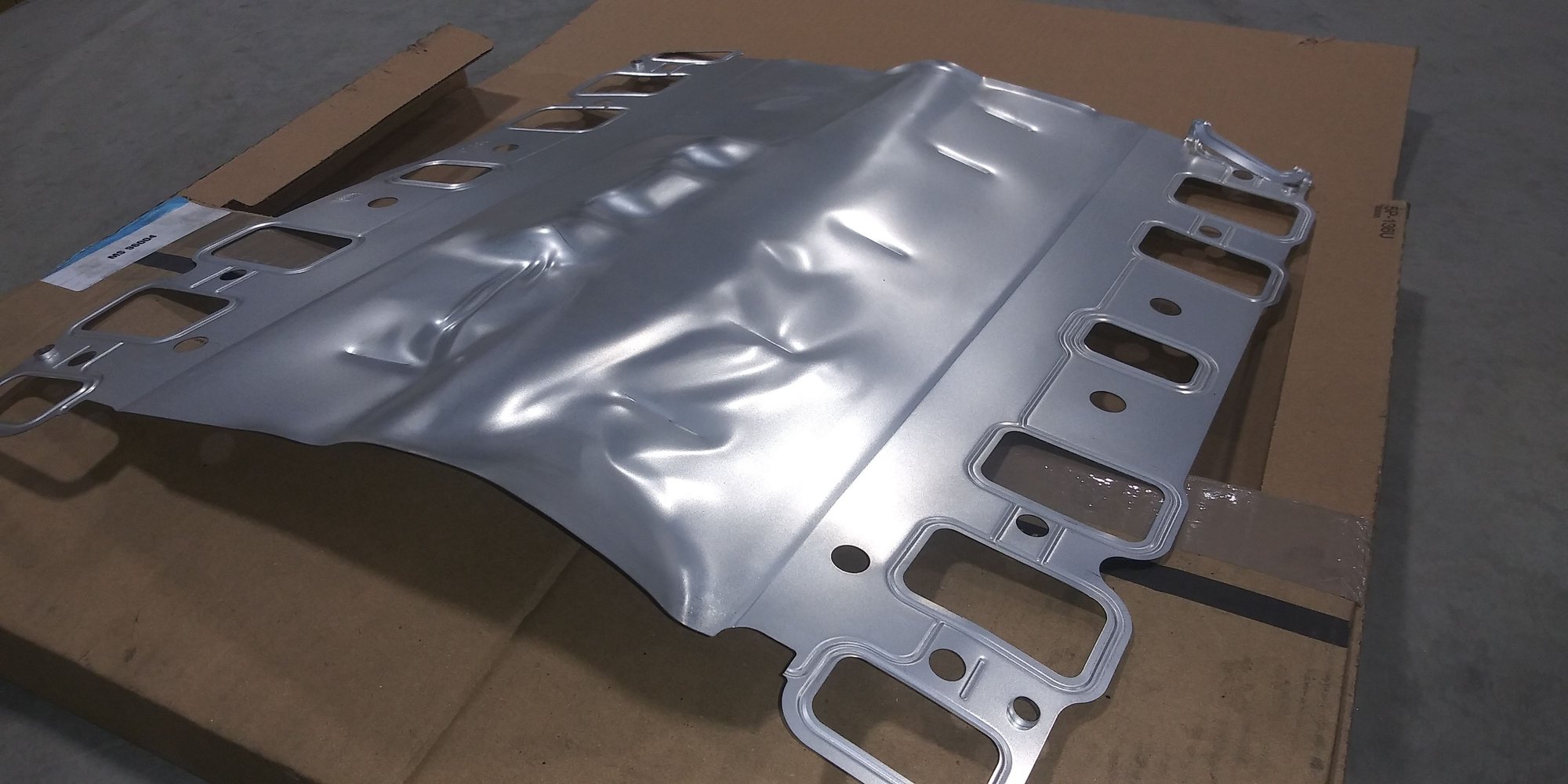

Second Felpro gasket out of an undamaged box. Does this look normal or is the stamping die pooched? Even google images show this gasket bent up like this.

That’s totally unacceptable. Those boss indents at each corner are certainly going to be off-centered. I’d never accept that turkey tray gasket.
Old Apr 24, 2021 | 08:37 AM
Sugar Bear's Avatar
Posts: 4,098
Doesn't look normal nor mis-shapened from a die, it looks damaged. It may work if the sealing dimensions didn't change. Send it back.

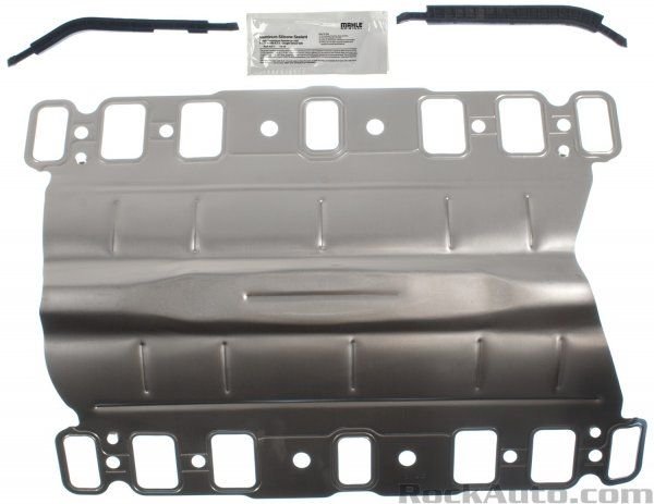

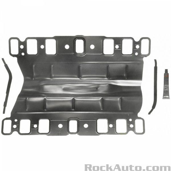

When I went to Rock there were 4 different brands available.
All 4 info images showed the same deformations all different brands.
Check it out, I'm losing my mind on this.
Felpro said they're not concerned with the windage area of the gasket as long as the ports line up.

Look at the images on Rock, they're ALL this way.
Old Apr 24, 2021 | 12:03 PM
Posts: 25,789
I did. NONE of the RockAuto images look ANYTHING like yours.

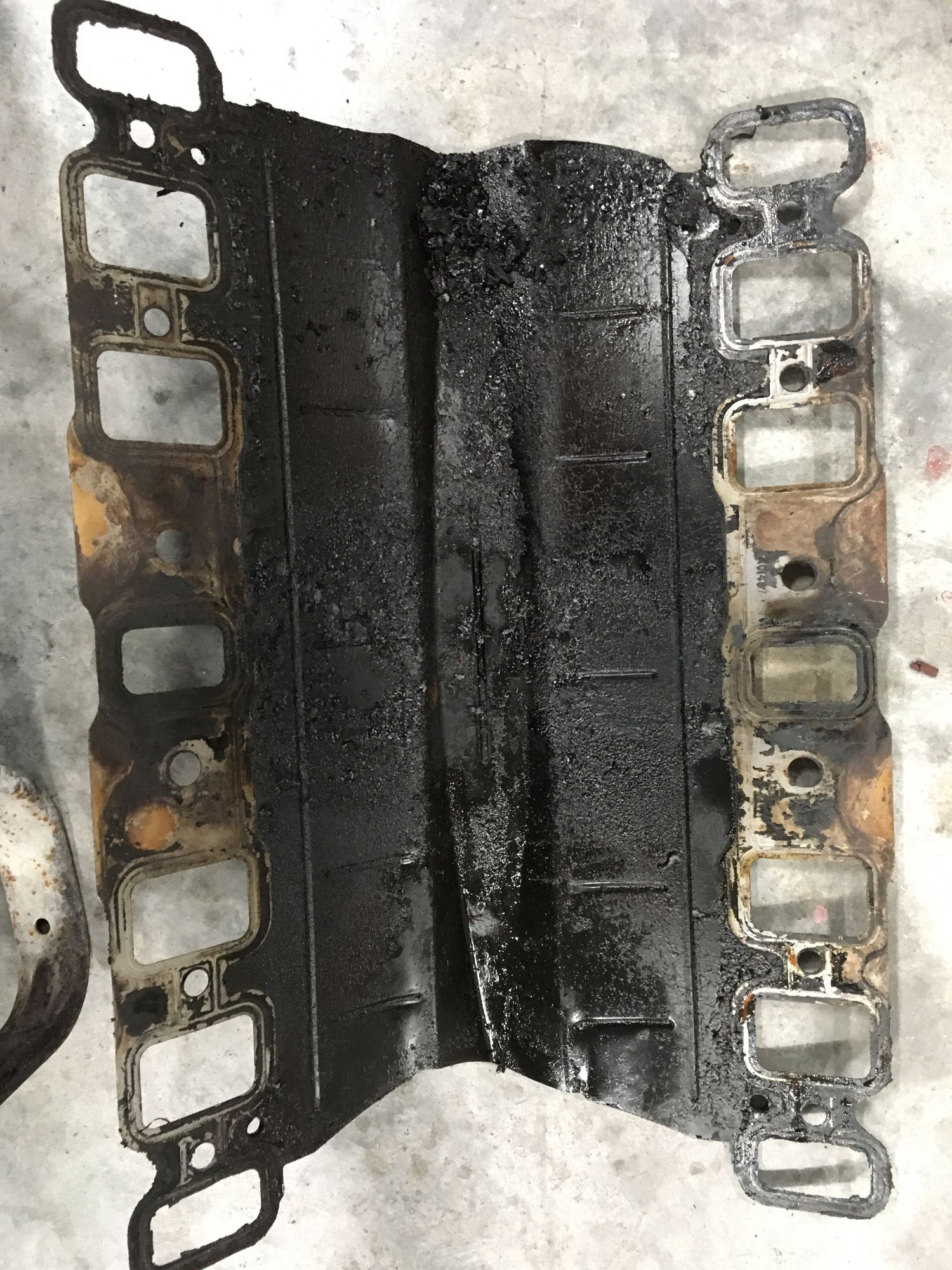

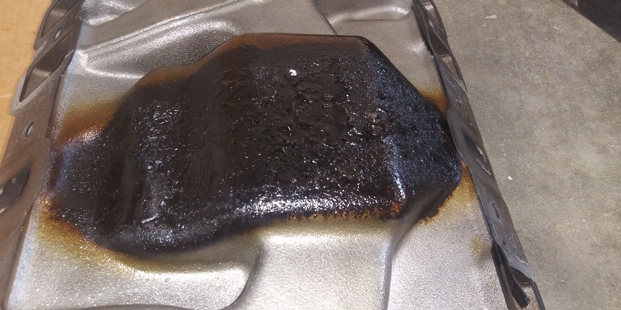

First image is the intake manifold gasket I took out of my 1971 CS. Second image is the Mahle intake manifold gasket I installed in my 1971 CS.
thank you thank you thank you
I didn't tear this down, but knew something was wrong.
Shocked it's so widespread across different vendors and Felpro doesn't seem to even wonder what I was asking about.

These are Felpro, but of you search Rock Auto there are 4 vendors including Victor that all feature the same gasket defect in different pictures.
if you search eBay the same thing is present although I did see one listed that wasn't damaged.

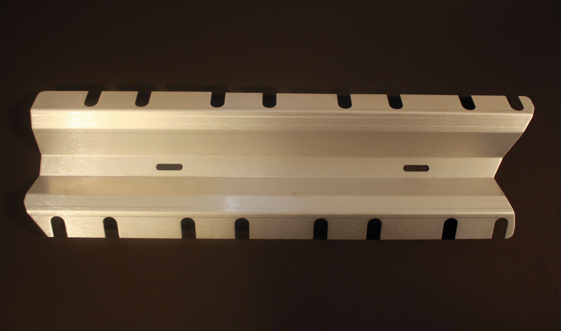

Do some research before buying anything from Mondello Performance. You need to be fully aware of what you are getting into beforehand so that you can make an informed decision.
I see in your pictures above that you have an aluminum intake manifold. Be aware that the Mondello valley tray WILL NOT fit beneath the Edelbrock Performer 350 intake manifold. I tried and it did not fit, even after Lynn at Mondello assured me that it would. When the intake would not seat due to the tray being too high, Lynn then claimed that Olds made two different block versions, and I must have "the other one". Lynn does not issue refunds, only store credit, so I ate the cost of that tray.
If you have something other than a Performer 350, then I cannot say whether that tray will work or not. But as said above, you can cut the center out of a turkey tray and use that as the valley tray - this has been done for ages.

I got one today for a 425 I am doing and it is fine. The big center area is deformed a little but that gets half bent up when you put it in anyway. That really does not bother me in the least bit. The side rails were fine, thats all that matters.

So skip the 1-piece turkey tray and get the 2-piece gasket set. Cut out and use the valley portion of your existing turkey tray if you feel you need a valley tray.
MS99471 $6.26 on RA
FYI, my engine has 2-piece composition gaskets and no valley tray for the past 20-odd years with no issues.
Now Felpro is stating specifically that this shield is necessary, yet he's run 20 years while my intake looks like it does after 2 tanks of fuel, run without it?
Maybe he should pull his intake would be my advice.

You made me open my new Felpro one I got from rockauto today. It was just fine.

it was definitely a manufacturing issue, so that's not unheard of.

The damaged corner is unacceptable, however.
I was looking at the one I have here and I think the bent corner is almost certainly from an automated packaging machine. There is no way throwing the box around would bend it that far over.

I'd have to agree automation is a part of this problem from the roll to the box with a label no humans involved.
Now onto the good stuff.
In the process of cutting this port flange clearly a turkey tray would have leaked again based on the warpage shown after the first pass had this not been cut.
This is exactly where the leak was as it happens #5.
Kind of relieved to finally get some confirmation and connecting the dots on why.
