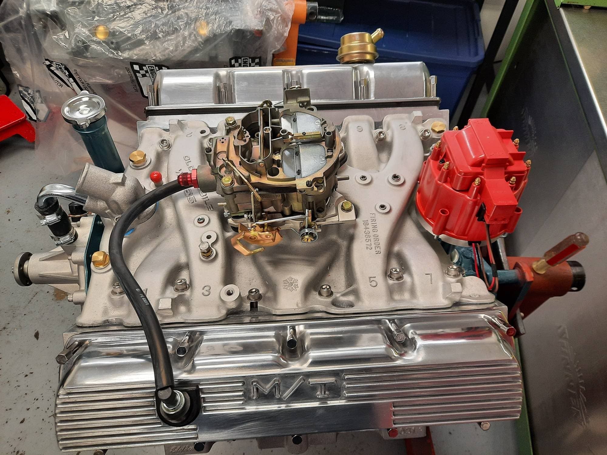

My new 455 build has the Harlan Sharp roller rockers with the M/T aluminum valve covers. We had to double the valve cover gaskets for clearance but works and looks great. Good luck.
