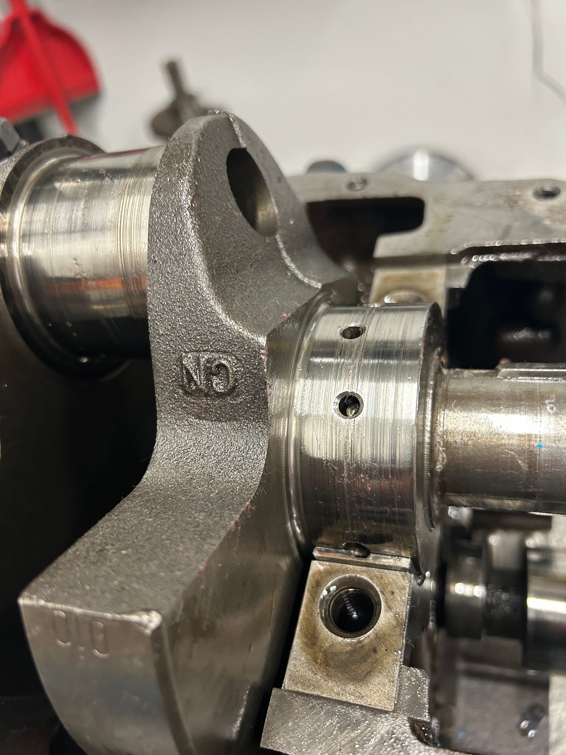

I’m currently rebuilding an H headed 455 442 W 30.
It came to me originally because of excessive oil consumption, about a qt. every 500 miles, even though it was recently rebuilt. After tearing it apart, I found numerous mistakes and careless assembly practices as well as now, questionable machining operations as well.
The last statement is the reason for this post. I typically run into mistakes and such other shops do on Oldsmobile engines in general. But what I found yesterday is unacceptable. This engine had very good oil pressure, but when I pulled it apart and saw the Crank, etc., in this condition, I was confused as to how it would have such good oil pressure with the crank and bearings in less than optimum condition.
In addition, all the main saddles were .0015-.002 OVER the high spec. So how did it still have real decent oil pressure?
I found they “adjusted” the bearing clearances by grinding the crank only .008 under, not the full .010. That tightened up the bearing clearance, even with the larger main saddles. This was a blatant machining practice to circumvent doing it the correct way(ie align honing correctly and adjusting clearances from there). Stuff like this is unacceptable to me, and should be to everyone as well. The cost of this rebuild when done in 2021 was over 7k, and it was basically just a hone, re-ring, with a new flat tappet cam.

Looks like a ton of crap went through it too. Did you find what was causing the oil consumption ?
Yes, loose guides, worn valves, questionable seals.
Rings looked OK, but the cyls were a bit barrel shaped as well.

not uncommon to see GM factory bearings +plus on the bearing OD to compensate for out of spec main saddles back in the 60’s and 70’s. I’ve seen it many times.
but today that’s a no go when doing a build not coming down an assembly line.
