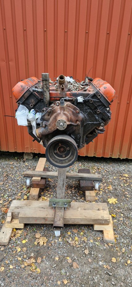

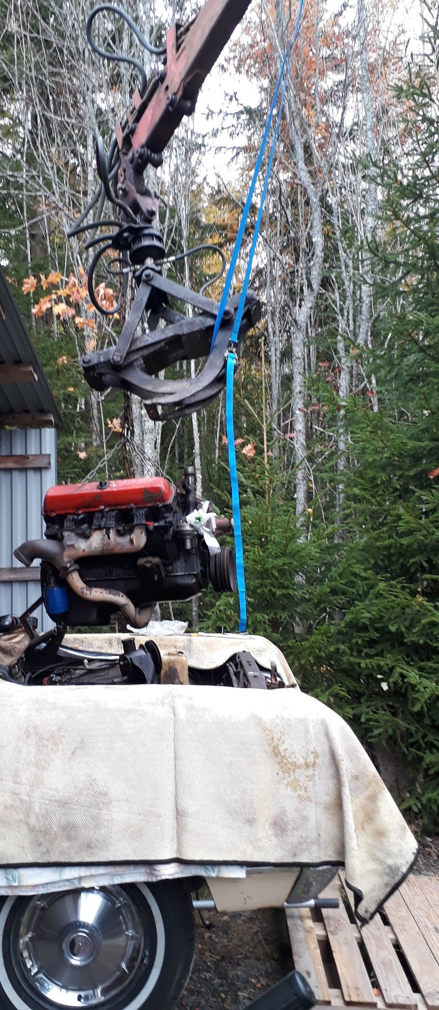

Today my brother and i lifted out the 425 from the Dynamic , using the tractor with the hydraulic crane.
So now i should clean the engine before i move it to a warm place to have it during the winter.
Yes the three legged engine stands are a little dangerous but i bolted a wood to the front leg. Have wood
under the stand to save the wheels in the gravel.

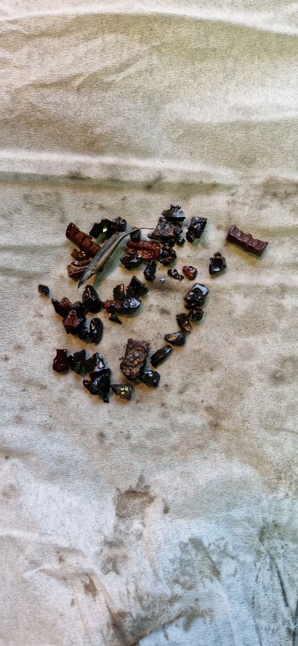

One hour is very good Norm . Removed the oilpan today and found this in the bottom of the pan.
Suspect old valve sealings and can the light brown be from the old timing gear ?

Posts: 18,263
Is the cylinder damaged?
Old Oct 25, 2025 | 11:15 AM
Sugar Bear's Avatar
Posts: 4,123
Yes to the valve seals and nylon camshaft gear teeth fragments.
^^x2^^
