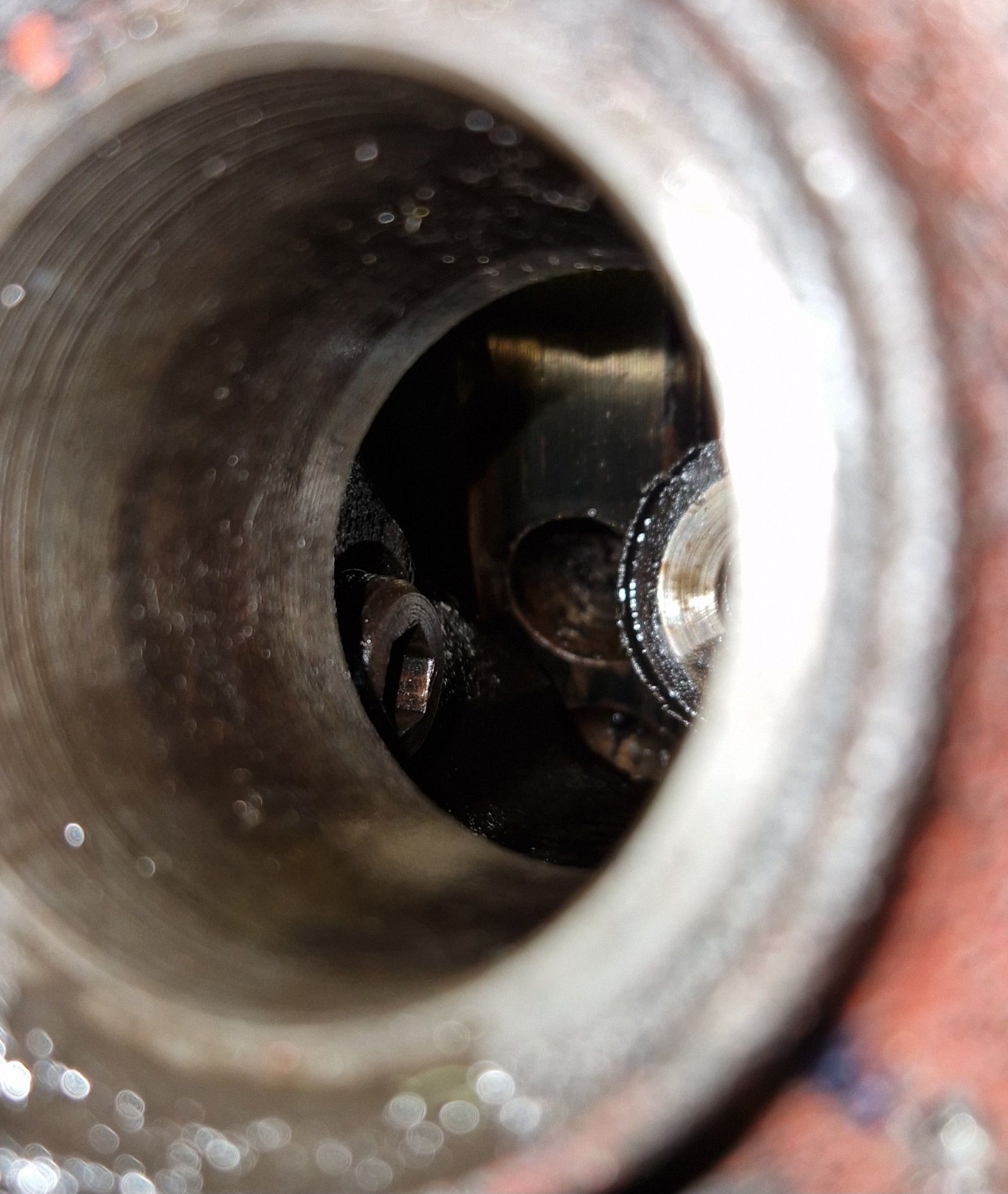

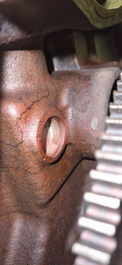

Have removed the two fronts , the left had the hole
clogged. The plug in the distributor hole must be the hexagon and access to this must be thru the
plug behind the flywheel ?
I think i let this plug stay in the engine , i can see with a flashlight that the hole is open.

Wow how much crap it was behind the freezeplug , this is between 5 and 7 . More between 6 and 8 but not so much. Can't imagine how this should look in my 98 engine

Read post #12 in this link.
https://classicoldsmobile.com/forums...removal-85064/
I wouldn't be comfortable leaving the plug in place as it would limit cleaning that galley.
Is there cracking starting around the part that the plug goes into?

Thanks for link Sugar Bear yes you are right best to remove it. I removed it thru the distributor hole and washed off the stripes on the block

Even if the machine shop cleans the block I'd suggest a very close inspection afterwards and recleaning as necessary.

Yes i should do that there was a lot of crap in gallery were the plug is. More than the other side.

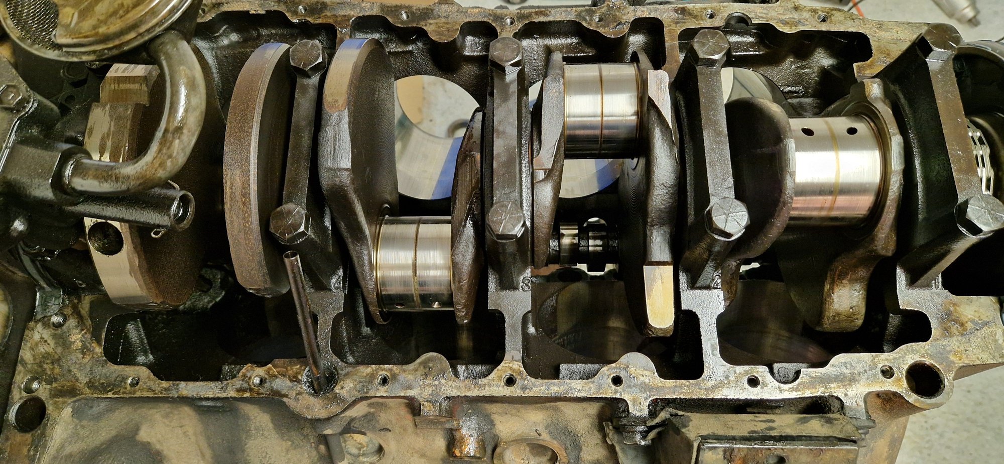

Looked att the bearings in no 7 and 8 connecting rods , they were stamped like this :
Number 7 upper bearing 7378 GMM400 324R4
under bearing 7378 GMM400 324R4
Number 8 upper bearing 7378 GMM400 296F
under bearing 7378 GMM400 296F4
Maybe it,s possible to se if these are std size ?
And the grey sludge around the bolts in the pic above was just old oil they said.
Old Nov 20, 2025 | 07:35 AM
  #65
Sugar Bear's Avatar
Posts: 4,098
X2 on the gray sludge being old oil, seen it before on engines of that vintage.
Good chance the bearings are standard, others may know by the part #'s. Did they measure the crankshaft? Does it need to be resurfaced?
Old Nov 20, 2025 | 10:24 AM
  #66
GCH's Avatar
GCH
Joined: Dec 2015
Posts: 1,117
From: Arvika,Sweden
Hi , i had the block back on my truck at this time and can take the crankshaft in my stationwagon a little later. There was a lot of engines there
Here is a pick of number 7 and 8 bearings. The other bearings look better. I can se some wear at
the crankshaft but not so much.
Nummer 7 on top and 8 below

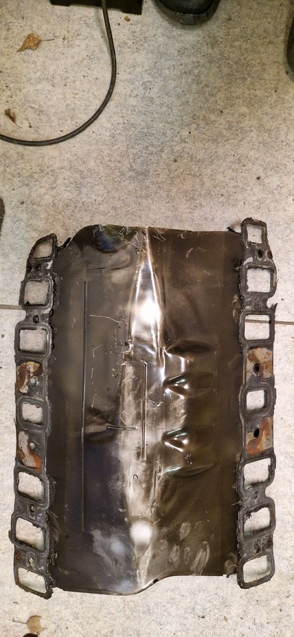

The crankshaft seal in the back of the engine was like rope ( ? ? ) style , not rubber. And the intake
manifold has the "turkey tray" , have read that common type of gaskets also been used instead.
Don´t know what is best to use. And the headgaskets was thin metalstyle :

Glenn - Sounds like typical OEM parts. The rear main seal was, in fact, rope - not rubber. Original OEM intake manifold gasket was the turkey tray. I'm not sure about the cylinder head gasket. It "appears" to be a Victor Reinz gasket. They make many gaskets. I don't know if they made original OEM gaskets for GM Oldsmobile or if you have an after market (post production) replacement Victor Reinz gasket. Others w/ more engine knowledge will know. I used a (new) aftermarket Victor Reinz intake manifold gasket on my 350.

Hi Norm ok never heard of Victor Reinz gaskets before. Not sure if i should use a turkey tray or not ,
was the thoughts that the tray should protect the cam from debris falling down maybe , hmm. I need to
check for a good set of gaskets.

Turkey trays are generally good, though I had a problem with one in my 350. It wasn't punched right but I think that is fixed now. The idea of the tray is to keep oil from splashing up on the hot exhaust crossover in the intake manifold and getting all crusted up - falling crud into engine, etc.

Glenn - What Gregg said regarding splashing oil. The gasket you have pictured is likely an original "VICTOR" cylinder head gasket. I'm not 100% if VICTOR produced/manufactured that gasket as an original OEM GM gasket for Oldsmobile. My suspicion says it's the original GM OEM cylinder head gasket. VICTOR (they were brothers) was supposedly the world's first manufacturer of cylinder head gaskets (based/established in 1909 - Chicago, Illinois) - supplying primarily the United States/North American market. (Victor) REINZ was a leading manufacturer of automotive/industrial gaskets based/established in Germany (1920) supplying gaskets to the European market(s). (Charles) Dana Corporation (established 1929, Toledo, Ohio) merged both VICTOR and REINZ into the Victor Reinz corporation (1993).
On a side note. Clarence Spicer (from New Jersey) invented the encased universal joint (C.W. Spicer [1904]) "revolutionizing power transmission in early automobiles", and grew under Charles Dana (New York City, New York). Victor Reinz is (today) owned by the Dana Corporation. The Dana Corporation began as the C.W. Spicer company when Charles Dana invested into the C.W. Spicer company (1904).
You can find replacement gaskets from Victor Reinz, Mahle/Clevite, Felpro & Enginetech.

Thank you both for your intresting info about this. Very intresting to read . So there will be an turkey tray
here again. But this maybe not necessary when the heat riser in the exhaust manifold is removed ?? But
some hot exhaust may slip thru the intake manifold anyway.
Have also seen recommendations to have a little rtv around the water ports.

Here are some pics of the old turkey trey , rtv on both sides and around all the ports. Cleaning heads and valves for now.
Maybe been leaking thats why there is so much rtv ?

Yes i hope so Greg i,m planning to keep the cam and lifters. I should check the galleries when
i get the engine back but this was known at the machineshop. It is also a nice oppoturnety to mount
a dual mastercylinder when the engine is out and easy access to the distribution block
