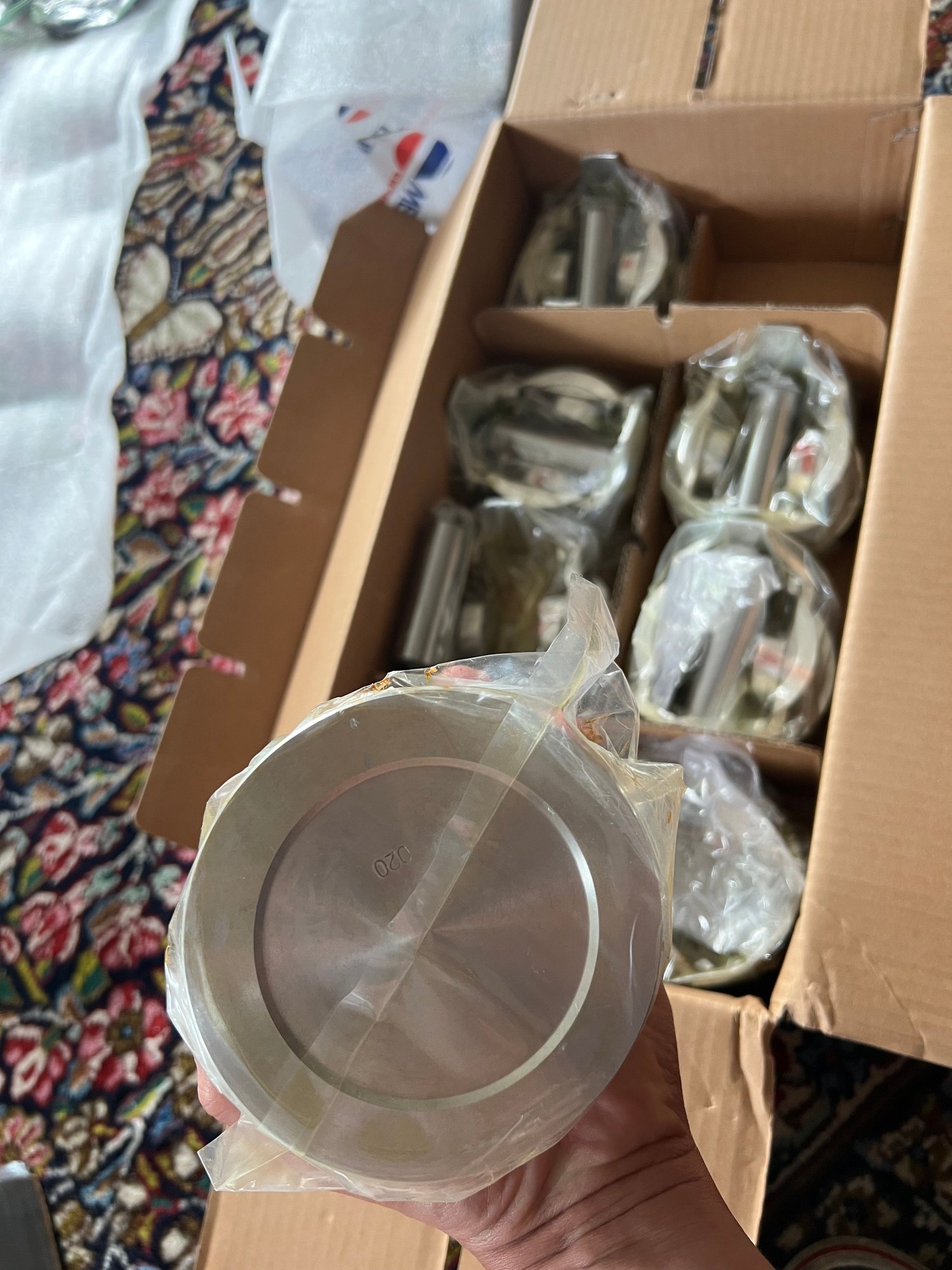

do you have make and part #of the pistons..??
Take a picture of the top face and the underside where rod goes ANY casting numbers there..?? Top may also have numbers to ID them

this picture .. only what I have

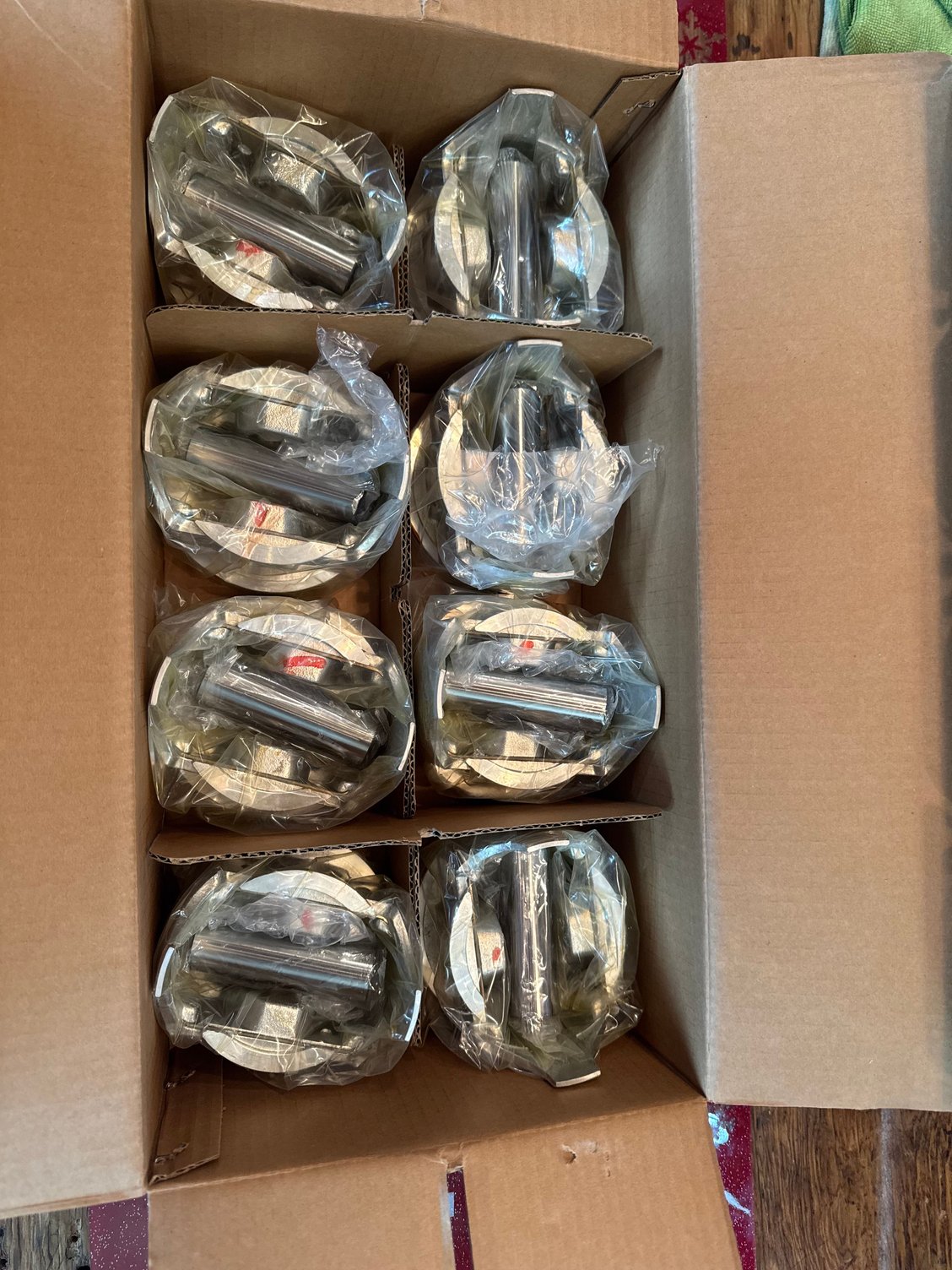

Old Sep 28, 2025 | 01:49 PM
Jelonek's Avatar
Jelonek
Posts: 62
From: Aurich
Old Sep 28, 2025 | 01:50 PM

is that cast or forged ?
Those are cheap cast pistons.
Correct piston to wall is built into the piston. Are you honing it with Sunnen or similar machine or a rigid hand hone?

How are you measuring the .003 " The factory clearance is .0008 to .0012 but a little bit loose will never hurt anything. Most pistons will have the specifications on the label on the box. Is there anything there ? It is normal to be able to move the pistons in the bore without the rings.

I think your pistons are probably from Egge. If so the clearance is .0025" So your .003" is fine. I would rather have a little more clearance than not enough.
https://egge.com/product/egge-piston...a_oversize=020
Did you check the end gaps on the rings ? Those rings are old school thick rings and if you are comparing them to modern engines it will seem to be very hard to turn over.
