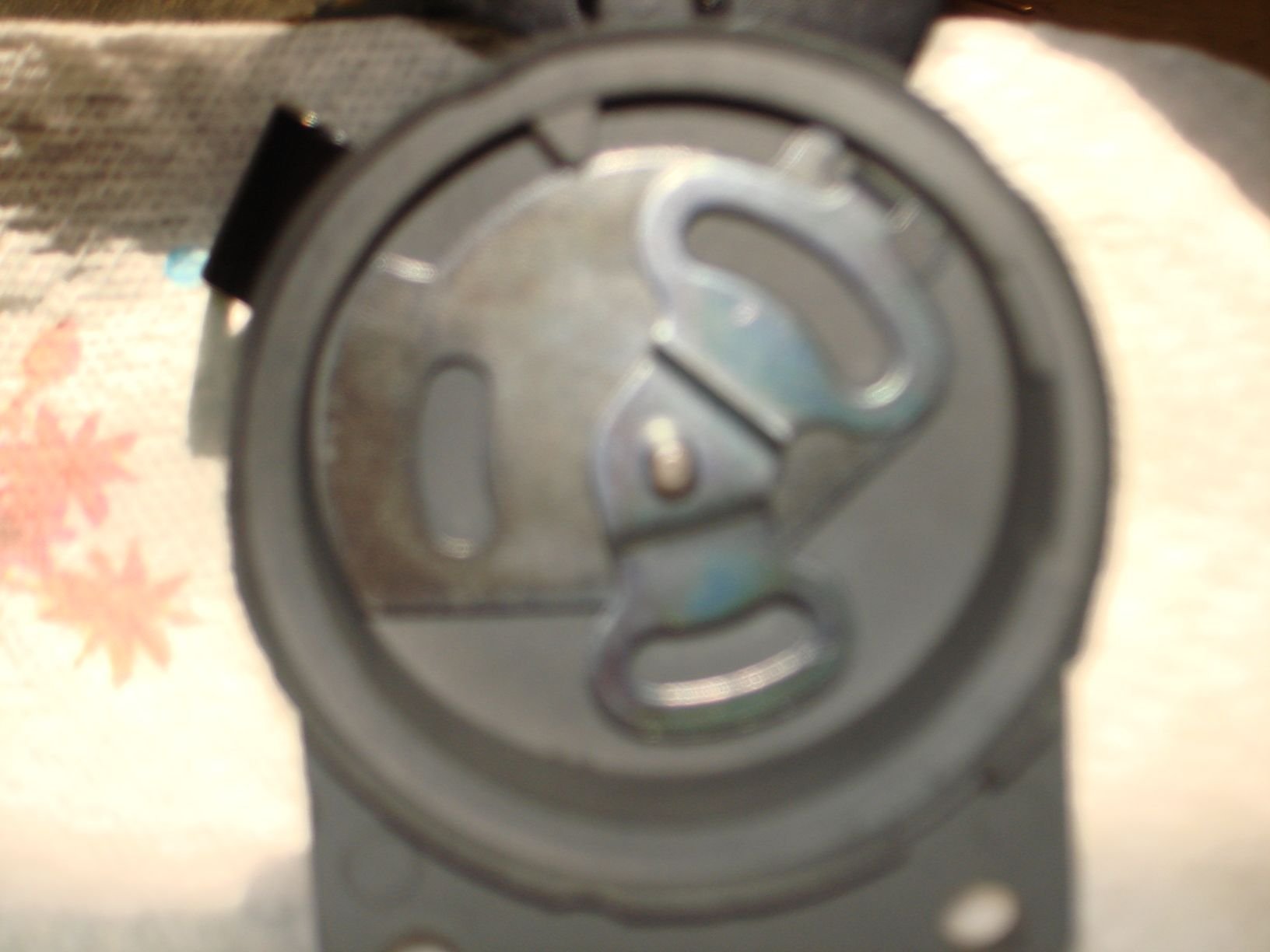

Hi Tripdeuce,
Great Job !
I've got an issue with my kickdown switch. It's not in a good condition. (look at the pictures)
I've two questions :
- it's possible to disassembly the black plastic cover without any damage ?
- do you know the wiring diagram for the 3 connectors : specially for the pin 1 and 2. Which one goes to the trans.
By the way, I've just a 1 pin switch on the transmission case.
Thanks for your help.
Take care and stay safe.
Pat.

it might work if there was a wire from the switch to the trans(see bent terminal)also looks like the spring is off it's hook.

Yes it comes apart if you carefully uncrimp the edge that was peened over to hold it together. It's full of springs and brass electrical connections.

Battery terminal would be the orange wire. Terminal 2 is the downshift, Terminal 1 energizes the High-stall mode on the switch pitch. If you have the original wire it's easy because they only go one way. If not the #2 connects to the bottom terminal of the two prong plug on the drivers side of the transmission and the #1 terminal connects to the top terminal on the same plug.

Thanks for the reply.
The issue is, I've not the original Transmission and the orignal wire disappeared too.
The trans is a TH400 with a single terminal connector
So should I connect only the 12V to the BAT terminal and the #2 terminal to the single terminal on the transmission connector ?
And nothing on the #1 ?

The stock switch on your car has two functions, operate the kickdown and operate the switch pitch torque converter. Since your trans is a replacement that doesn't have a switch pitch torque converter, simply use only the terminal on your switch that controls the kickdown and ignore the other one. That's what I told you in post #26 this thread a week ago. It is not in your best interest to start multiple threads on the same topic, as people will not have seen prior answers in the other threads.

I was looking for how to repair my trottle switch and to connect properly the kickdown function on the right pin when I found out this thread.
I understud your advise, and fully agree with you regarding the multiple threads. I'll do differently now.
To summarize, I'll try to fix the broken axis inside the switch (more confident to do it with the explanations in this thread). Test and select the right pin to activate the kickdown function.
