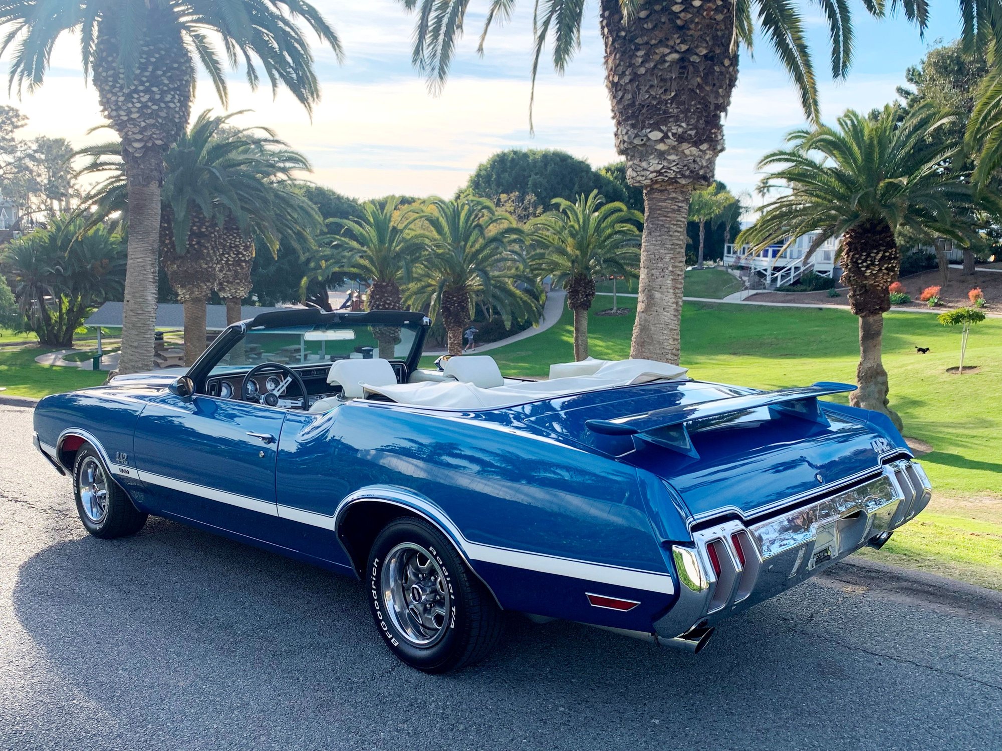

Old Jun 18, 2020 | 08:13 PM
Bandit60's Avatar
Joined: Aug 2018
Posts: 97
Here it is
Old Jun 18, 2020 | 08:14 PM
Bandit60's Avatar
Joined: Aug 2018
Posts: 97
It is a clone/tribute. but it is a 442
