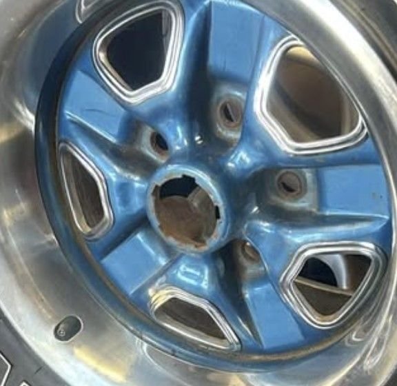

Need help with wheels
Not sure what these are off of and what they will fit. Could someone decode them please? Bottom picture is of the wheels before being sandblasted. Thank you

Posts: 18,191
Might want to post a picture of the entire wheel. It they're the Oldsmobile SS II/III wheels then they have 5x4.75" bolt pattern.

Posts: 50,768
These are 1980s vintage SuperStock wheels. 5x4.75" bolt pattern.

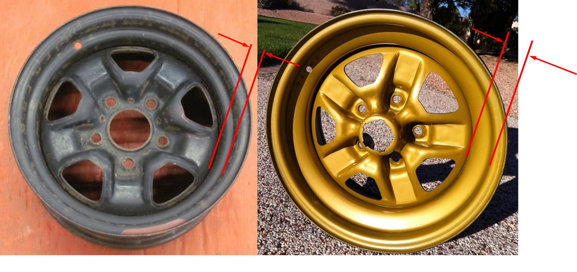

Posts: 50,768
To use technical terms, here are "snoot" (top) vs "non-snoot" (bottom)

Posts: 50,768
Also for future reference, here's how to tell 14" from 15". Ignore the fact that 14 is bolt-in and the 15 is snap-in. The difference to note is the width of the rim section outboard of the center, as shown.

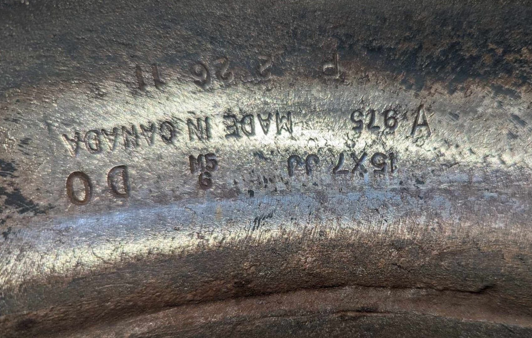

Posts: 454
Can someone decipher the date codes on these wheels? I had asked about something like this before and I someone posted how to tell the codes, but I can't find my post about it. Thanks for any help.

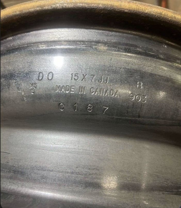

Posts: 454
Is anyone able to decipher the date codes on Post #25 please

v8al's Avatar
Registered Olds Owner
Joined: Apr 2018
Posts: 1,118
From: Los Angeles, CA
Plant - M5
Year ending in 6. So either 76 or 86

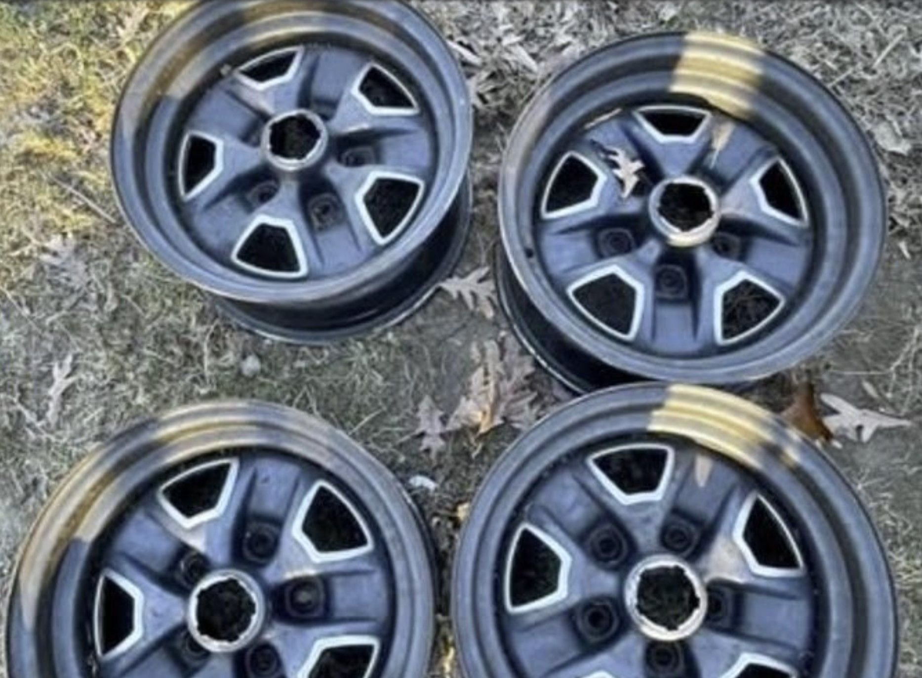

Posts: 454
What years are these from & as stated above, I'm sure they will both fit a 15" wheel?
Every single SS II/III wheel for RWD applications accepts either bezel.
Thanks Joe - I was just wondering what year each trim piece was.

Posts: 50,768
Square corners are 1980s, the others are 60s-70s.
