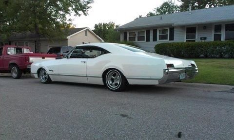

looking for some 14” or 15” x 7 Astro’s or similar. I have pretty much my mind made up on wheel size , width and tire size but I’m curious on backspacing. Anyone have similar setups? Or past experience?
Thanks In advance!
pic for example

4" backspacing with 0mm offset should work on your Delta 88. That's what the Eagle Alloys are on my 71 98.

Hope the car in OP's example has air suspension, otherwise the owner will get sick of losing oil pans on speedbumps.
