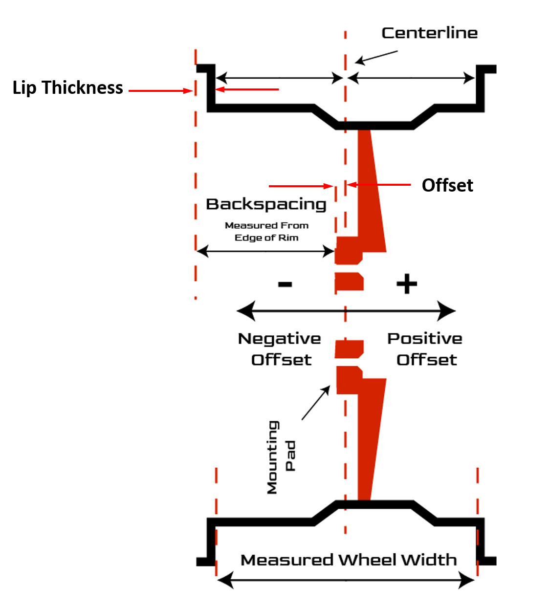

Old Dec 19, 2024 | 02:00 PM
OLDSter Ralph's Avatar
Posts: 5,215
From: St. Paul Minnesota
Rick, Joe P has posted (Post #2) the best drawing to explain things. Thats the same one I have. Print out his drawing and use it to understand things. As I explained in the phone call, ZERO OFFSET will give you the least amount of problems, and with turning the front wheels.

For reference, the wheel lips are typically 1/2" thick.
What this means is a 10" wide wheel with 0 offset has 5" inside & 5" outside of the wheel mounting surface.
Add 1/2" for the wheel lip & you have 5.5" backspace or an 11" wide wheel outside to outside.
This can vary slightly, but it's doubtful if more than 1/8".

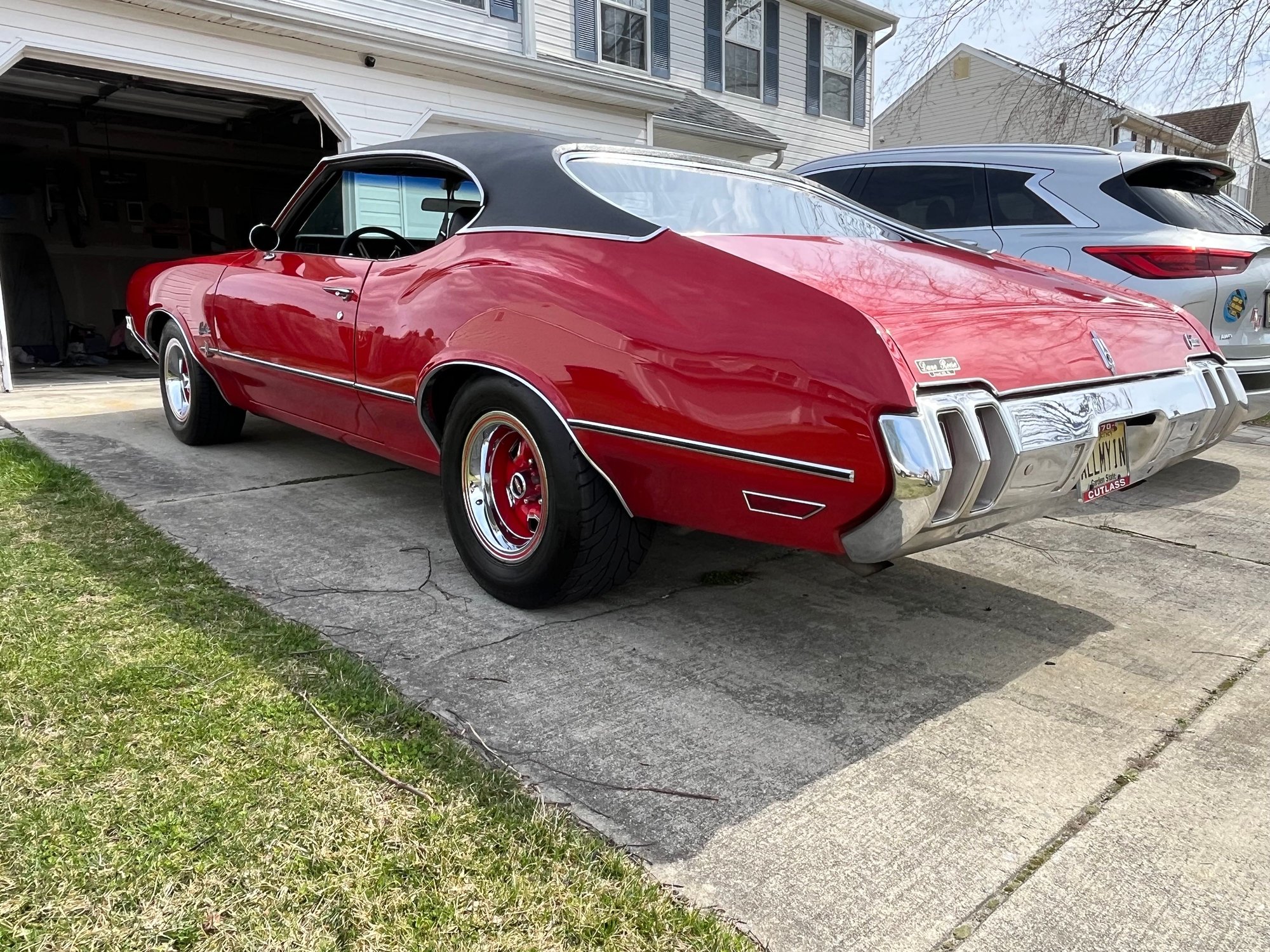

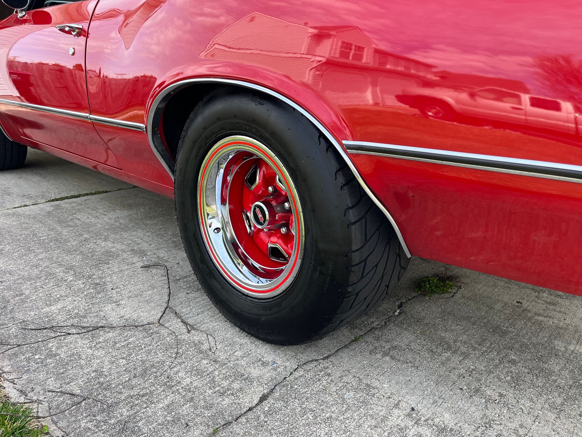

Old Dec 21, 2024 | 06:48 AM
JohnnyBs68S's Avatar
Joined: Jun 2014
Posts: 1,647
From: Ft. Wayne, IN
Originally Posted by OLE442
That. Looks. Perfect. I hope that tire fits my '68.
