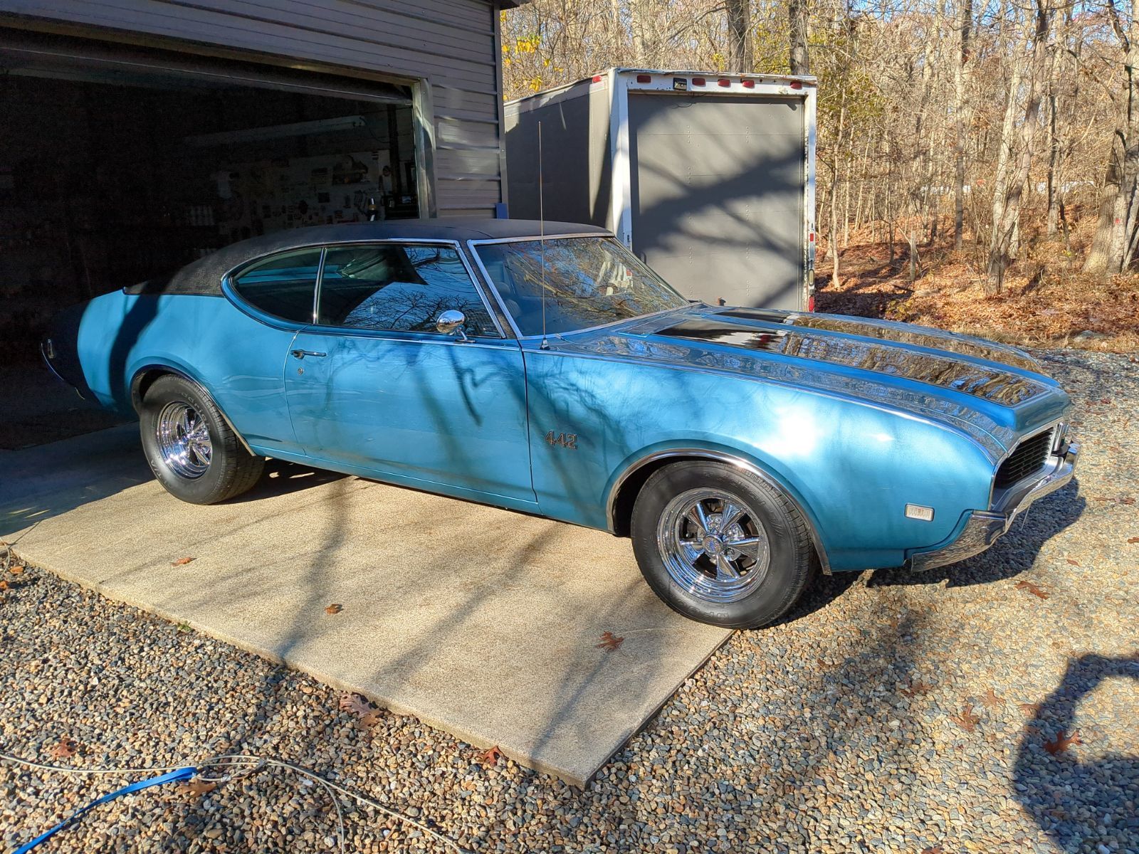

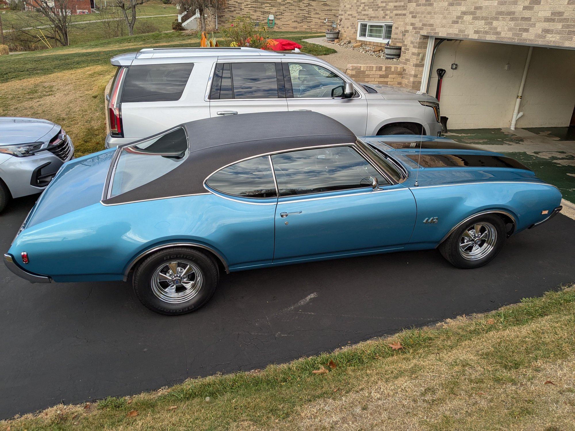

These are the only 2 pictures I have right now. I just bought the car in November. The weather has not been good enough to take her out. The BFG's are white letters in which I plan to turn them out when I finally decide on front size. This is with the Cragar wheels which will be replaced with 15" Rally wheels

What's bothering you is the car has been lifted. This is what it looked like stock.
Automobile Catalog is saying the original F70-14s were 25.6 inches tall. And as you can see the entire sidewall at highpoint of fender lip is hidden behind the fender. Now imagine how high your 442 has been lifted to fully expose a 28.1 inch tall tire.
Here is a real world stance on a then new 68 442.

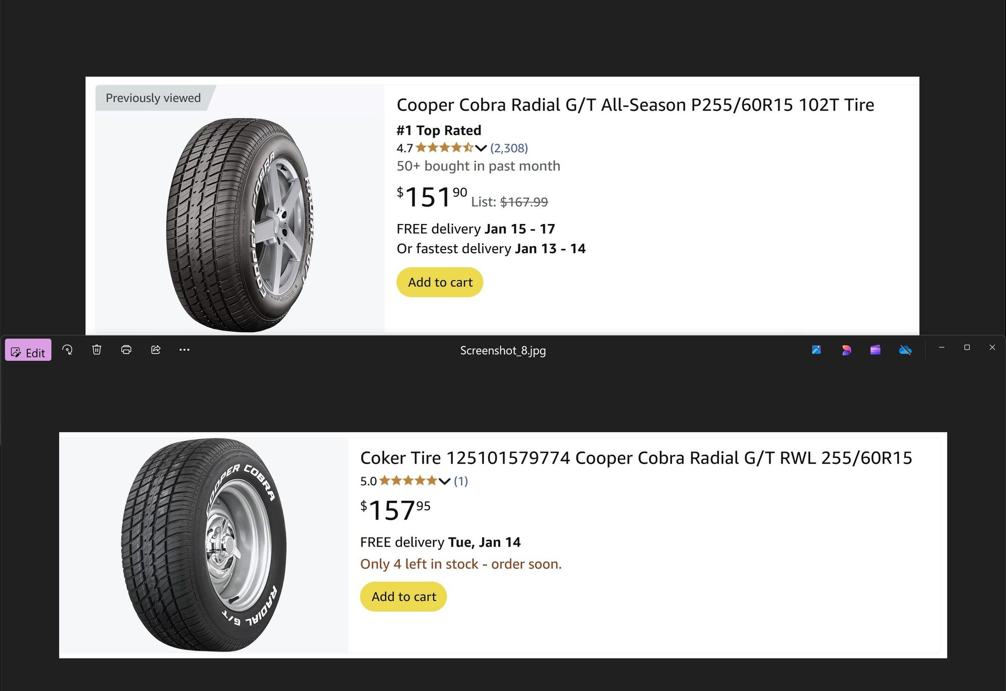

Besides the Price and the top tire stating it's an All Season, what is the difference? I'm assuming by the looks of both tires they are both All Season. One says Cooper Tires the other says Coker Tire. Trying to justify the price difference. They both read within the descriptions that they are Seasons Year Round. I guess another way of saying they're all season tires.
Old Jan 7, 2025 | 01:51 PM
Posts: 42,475
There is no difference between the two. My local Discount Tire has them at $137 ea.
