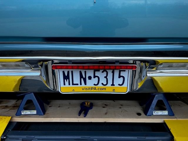

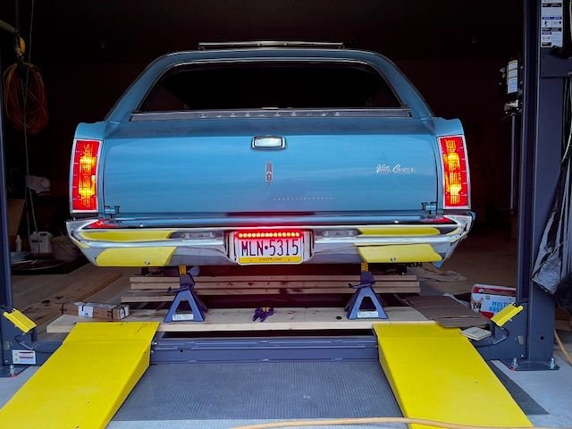

Installed a 3rd brake light.It was an easy weekend task. Got it from Summit along with a 25'- 2 wire jacketed harness.
Bought 2 small "L" brackets at the local hardware store. Total cost around $70. A relative inexpensive safety upgrade that can be easily removed .
Fits nice in the license plate recess
Doesn't protrude past the bumper
I wired it directly to the brake switch and grounded it under dash
Will this prevent a rear ending by some kid texting while behind the wheel? Don't know but there's no downside to this .

I would also mount your 3rd light higher on the rear. To me, it just looks like you and colored lights to enhance your license plate.

Mounting it higher is an option, and a good idea.
I'm not at the point where I want to drill holes in the body, but always open to outside suggestions.

There is a regulation governing the installation of 3rd brake lights and yours does not meet it. Most states follow the Fed standard.
Do You Need a Third Brake Light by Law? Rules and Exemptions - LegalClarity
Old Apr 24, 2026 | 12:40 PM
67VistaBlue's Avatar
Joined: May 2024
Posts: 126
From: New Milford,PA
Great info.
From what I read besides the older vehicles being exempt (no surprise) is the minimum height. Passenger vehicles are exempt from that too.
Has to be centered, only activates when brakes are applied.
Thank you for sharing

Looks like a good idea to me- higher would be more visible, but that's not possible, without damage to your beautiful Vista- good job!

And note that CHMSL stands for Center HIGH-MOUNTED Stop Lamp. Down low on the bumper isn't likely to be noticed, especially since everyone drives a monster SUV today.

I figured if you can see the license plate when driving, you'll notice the light.
If you're driving that close to the vehicle in front of you that you can't see the license plate, you're gonna rear end him.
