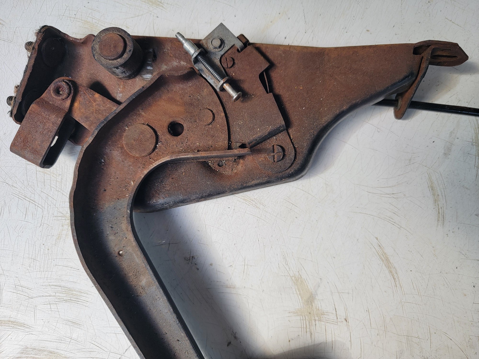

does anyone have a picture of how the emergency brake switch is connected to the pedal etc

Here is a picture of the parking brake assembly, showing the switch. This side is against the kick panel when installed. Essentially, the dark side of the moon! The switch contact can be reached with some difficulty (headstand in the floorboard, etc.) to connect the wire to it. When the brake is engaged, the switch closes. This grounds the circuit, turning on the interior brake light. Releasing the brake obviously opens the switch, turning the light off.

Thank you. This helps

im going to be tackling this soon. I’m sure my parking brake hasn’t been messed with
anyone know what colour wire went to this ?
this is extremely hard to see back there lol
