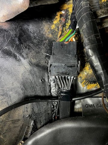

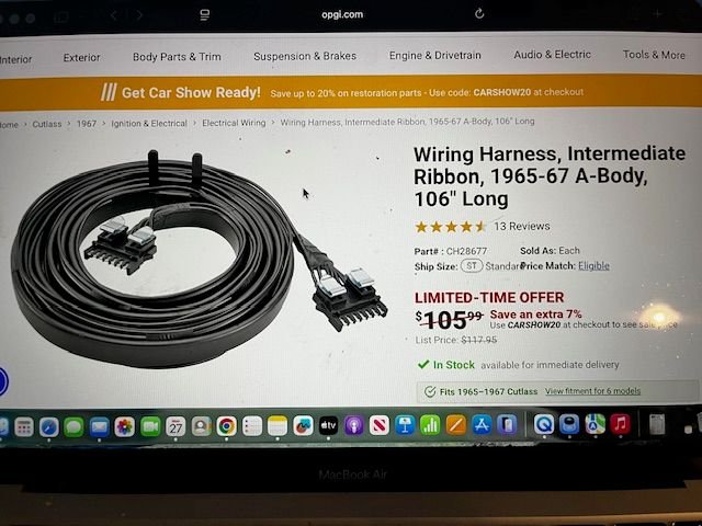

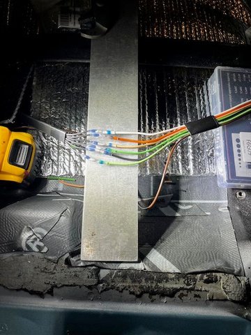

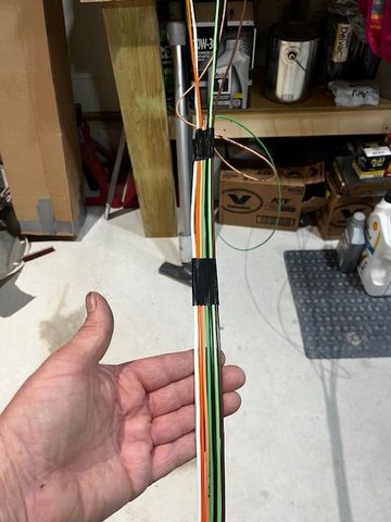

During one of my winter projects I was tracing a tail light problem (bad connection). Turns out it was the intermediate harness. It was brittle and the wires were almost broken completely in a few spots. Of course it's not available,(the Vista harness about 2-3 feet longer than the Cutlass harness) so you must improvise. I bought a Cutlass Harness and used the first 2 feet. made a splice under the seat area with the harness I made.

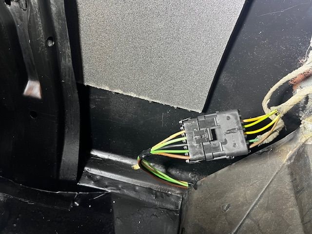

Bought a 6 wire harness connector and made the new hook up with the tail light harness in the spare tire well.

Here's the Cutlass harness (Bought from OPG) plugged into dash harness. I used the first 2 feet and made a splice under seat area
used 14ga wire  trying to match factory colors
Made splice under seat area

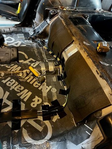

Routing harness along floor pan
Made connection with tail light harness using a new connector
