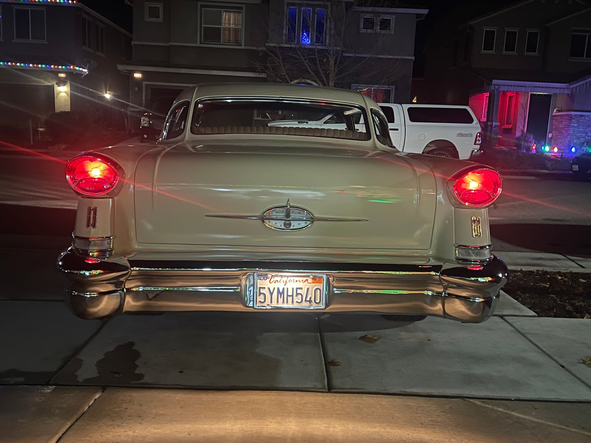

Hello, New to group. Need help/ advice on removing the rear 3 piece glass and trim without damage.

Screws hold small plates that push the glass/rubber outward, from the inside. Remove the glass from the inside, the trim just fits over the pinchweld around the opening. Remove from inside or out.
