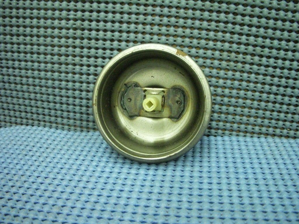

Joe P, any idea what size square is on the cable end at the wheel ? .212" square drive just popped into my mind.

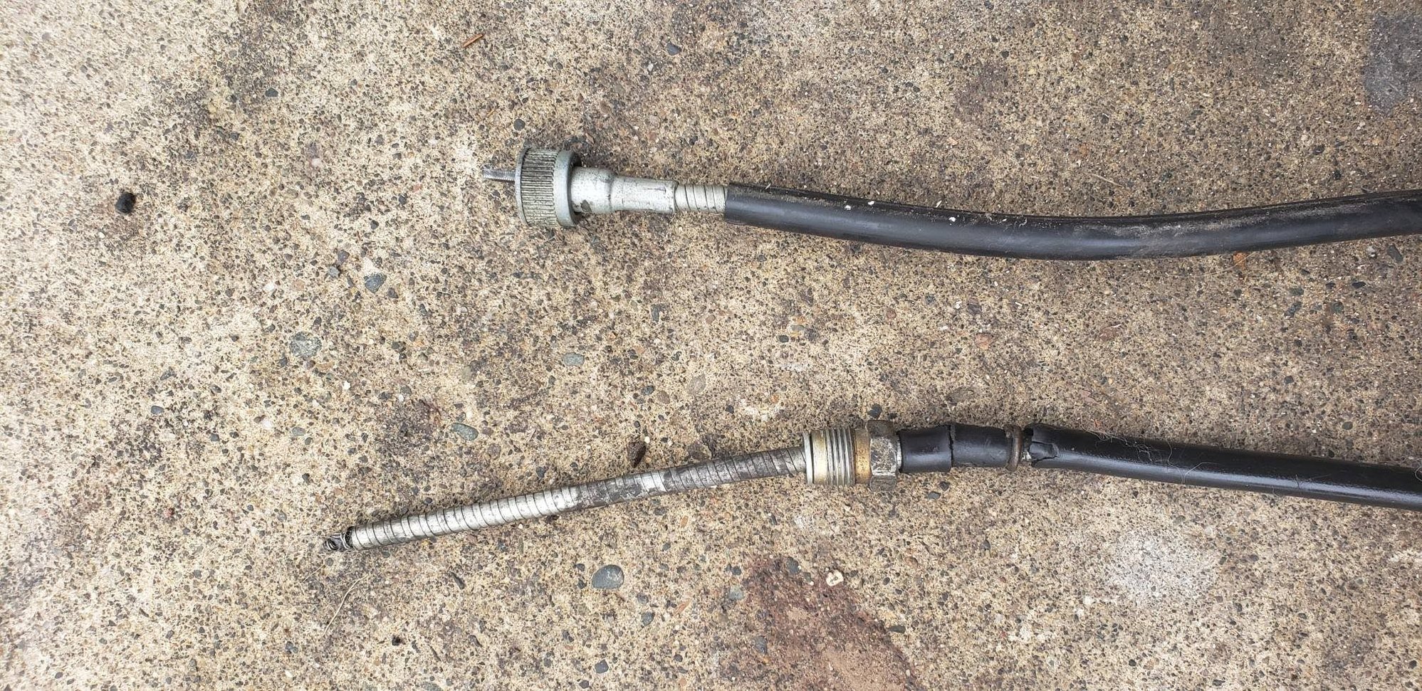

Old Dec 3, 2019 | 03:15 PM
Perkolator's Avatar
Joined: Feb 2015
Posts: 75
From: Sacramento, CA
Any more info on these cables, dust caps and parts availability?
I have a 68 Delmont with a problematic speedo cable too.
My mechanic sent me pics of the cable removed. I'm waiting to confirm with him where he thinks the issue is, he hinted the cable may have sheared off inside the pickup fitting but hasn't investigated yet. I have a feeling it's the dust cap after seeing that it's pickup fitting is made of plastic that's now 50yrs old....yay for plastic gears, just like inside my broken turn signal switch!
Anyways, I found one of these NOS dust caps made of unobtanium over at OldsObsolete for a mere $185.
Any other sources known?

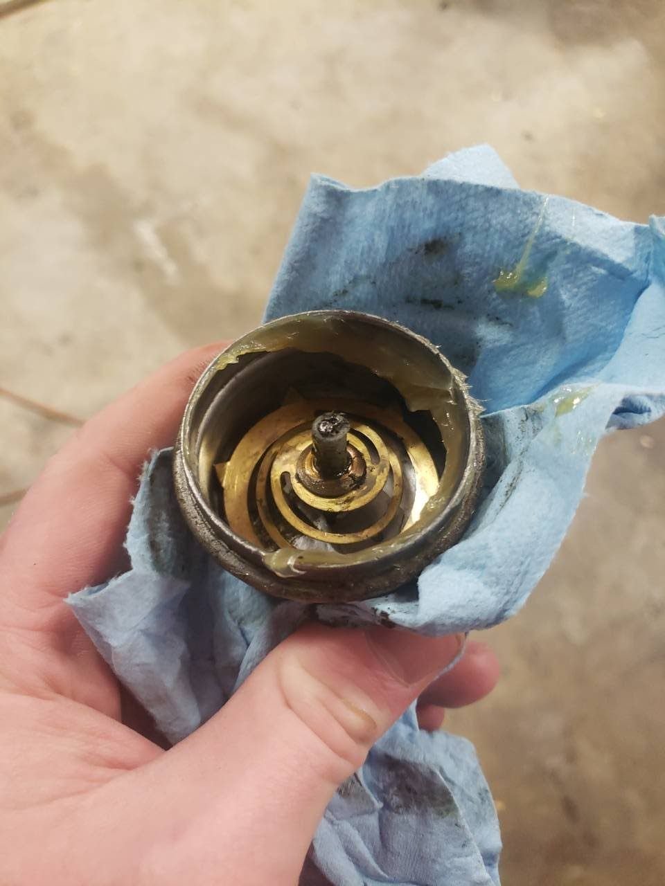

Talked with my mechanic - problem on mine turned out to not be the dust cover, the actual speedo cable end sheared off inside it!
So I guess now I need to source a new speedo cable. Do you guys think that Dorman cable kit linked above on RockAuto would work?

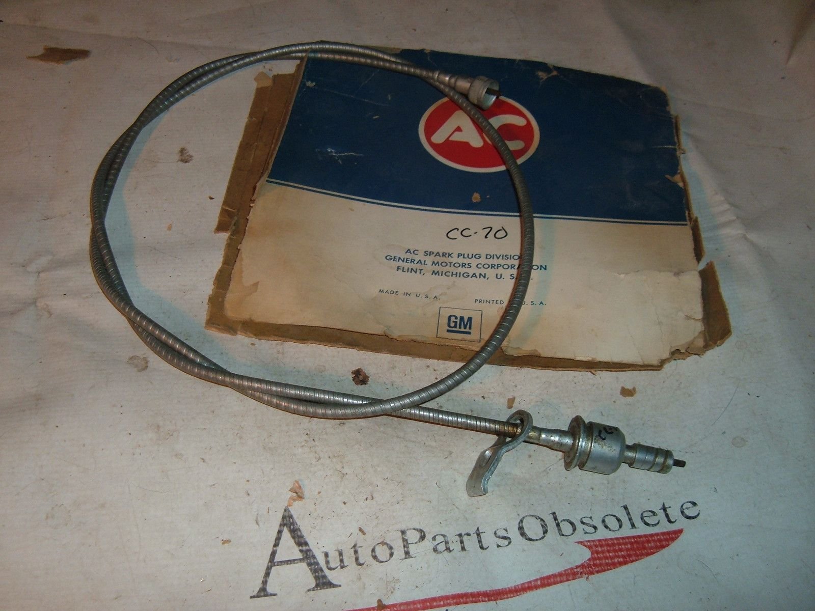

Nos wheel driven cable cassing assembly AC # CC 70 1588258
Nos AC cable cassing assembly # CC70 1588258.... In th cardboard that was a box...
Old Dec 4, 2019 | 06:22 PM
rocketscientis's Avatar
Joined: Sep 2019
Posts: 1,608
May hav been over exicited.......no
Premature phantom sending of post
cable is metal sheethed 59" tip to tip typical mount at wheel w retainer & screw on speedo mount at other...we got it from man that cleanedbout a dealership
Its realy wierd th stuff i find that Im not even lookin for.....this was in bottombof box of 67 A items n I was huntin a horn cap.....it proly should hav a new home....
YOU HAV VERY SPECIAL PARTS WANTED AD
its th parts i wamted to post pix of here but site refused so th parts you wanted to replace your two piece , or however many pcs it is , speedo cable May be at your wanted listing...nos...uncertain of its exact app but came from olds dealership cleanout back when general mismotors MURDERD OLDSMOBILE .check AC # CC 70 1588258 IF incorrect or unwanted plz lemme know

You know, if the only hard to source part is the plastic interior piece, that looks like a prime candidate for a 3D printer job. Granted there is a metal bracket holding it in place, and the cap itself, but that doesn't seem like a deal breaker. It's probably not a gold mine part, but something that a number of people would appreciate...

QUITE RITE YES INDEED how uncouth of me to hav overlooked that detail as th one is utterly useless without the other...chances of nos items as such to compliment th cable assembly are slim , but not to be discounted from tealm of possabilities .however at least half dozzen donner parts cars may produce them on an on demand bassis as current wind chill is obscene anyone in need or wise enough to accumulate an extra one just in case can call or txt me at 9897219432
cable assembly offered to ol boy yet a yea or nay has not been forthcoming as of yet leads me to ponder its fair market value should a for sale listing be required to locate its new owner...if anyone can tell me who its new owner should be I'd almost certainly hav to discount any item they may hav stored here for years unknowingly

Hopefully someone with 3D printing skills chimes in and can say whether or not it would be a realistic project.

I thought of the 3D printer for several simple plastic parts on this car. They’re not that hard to produce for someone who knows what they’re doing, heck it can even get 3D scanned to save most of the work. Probably not worth it right now since I did find multiple NOS dust caps for sale across the web, for various prices some as low as under $30. Perhaps in another decades time when these are consumed maybe they’ll have to be reproduced.

These are what are on mine, the tip of the cable sheared off in the dust cap. I got the Dorman cable for now just to see if it works since it was under $10
