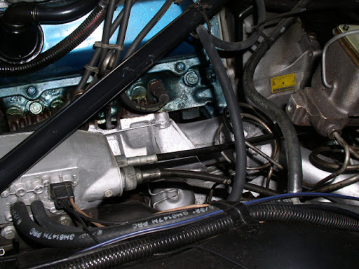

the 68 is probably 1968.
There should be a 2 letter code painted on the tag.
This one is a BB code.

Ok, apparently I would need the first two numbers on the tag to determine what year it was. In the book I have the example it gives has a tag with the letters OA with a serial number 73 O - A - 136865. The example is a TH 375 which came behind the SBO 350 in 1973 in B bodies.
The BB transmission that J posted came out of a Buick, and the AJ transmission Jeff posted came out of a Cadillac...
Perhaps the chart isn't fully up-to-date.

well being that mine is original (I think!!) maybe it was shared with Eldorados??? I read the entire service history of the car (thanks Joe) and I do not recall a trans repair.
