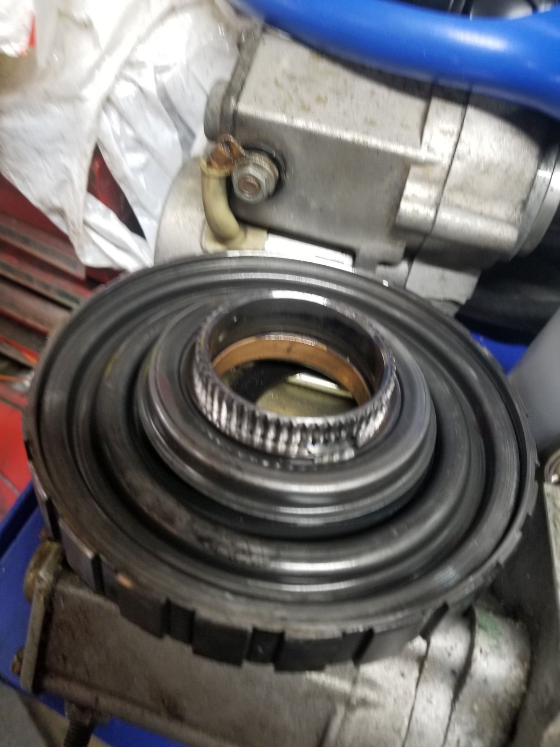

Interesting idea on those check *****. I finished tearing it down. I am getting a new pump and the kit with nearly everything including the billet forward drum, sunshell, servo, shift kit, upgraded thrust washers basically good to 450+ hp/tq from CK. I am also getting a new billet speedo bullet and the proper speedo drive gear for 3.90 gears and 275/60R15 tires. I don't why anyone would want a TH350, they suck stock and fail almost as often as a TH2004R. Crappier first gear, no OD or lock up converter adds 1000 unnecessary rpm. I will be parting with $1200 US in parts for this after the 351 build, which will really push my stock TH2004R other than CK .555" boost valve and regulator along with a deep pan and bottom feed filter.
I upgraded my snap ring pliers, the crappy multi head unit didn't cut it.
This snap ring was a challenge to remove, as it rests against the raised supports in the case.
Plastic thrust on top of the low/reverse assembly
Low/reverse clutch piston
Low/reverse clutch housing
Low roller clutch race and roller assembly
Spacer housing to case
Thrust bearing, rear cam/lo race
Output shaft with clutches stacked on
Low reverse clutches and steels
Low/reverse clutches and steels
Rear carrier assembly
Brown 26 tooth gear
All parts stowed away until assembly.
Hit the case with degreaser. It will get pressure washed before assembly.

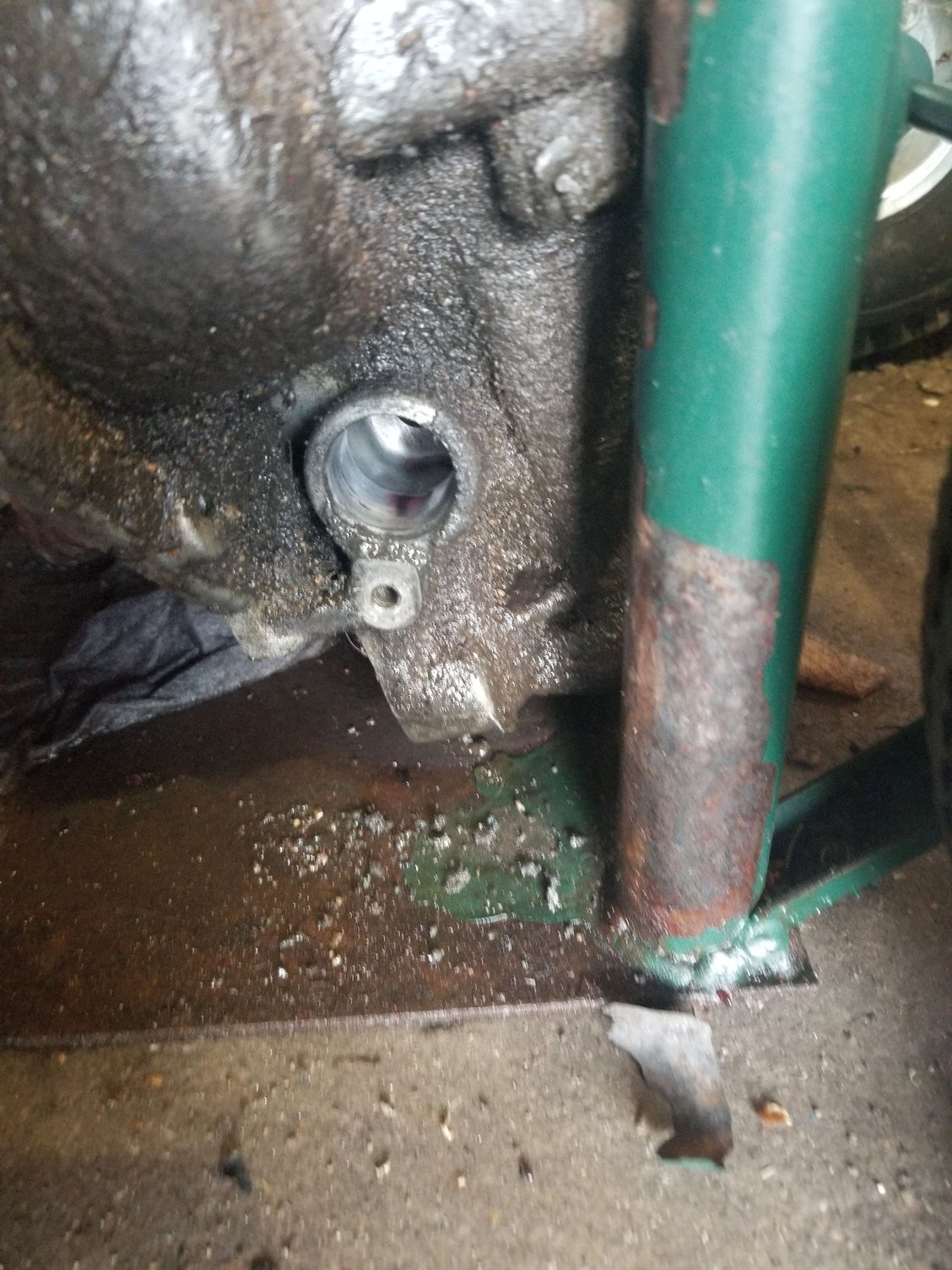

Boy, that looks familiar. I have to admit that I had a heck of a time getting the speedo driven gear bullet out of the case. The steel bullet had seized in the aluminum case. Hilarity ensued. I ended up getting a replacement aluminum bullet for the rebuild.
Old May 3, 2021 | 08:27 AM
  #52
olds 307 and 403's Avatar
Out of Line, Everytime😉
Posts: 10,101
From: Melville, Saskatchewan
Thanks, Joe. That reminds me, this one might be seized now that you mentioned that, I will check that tonight. The current TH2004R in my 70S definitely isn't. It was spinning in the case tightening up the speedo cable. Speaking of that, I need to put a gauge on that trans and make sure the big CK boost valves are putting out 200+ psi of pressure. Other than the deep pan and bottom feed 4L60E filter, it is stock. There was nothing in the pan and the fluid was very red, I have a feeling it was rebuilt not many miles ago. I may pick up a servo for the current trans to help it live under the planned power upgrade.

I pulled the speedo bullet as they tend to seize in place. I thought this one was seized, it was not, it must be the one outside that is. I also ordered the CK improved copy of the GN servo for my current 2004R. I know from experience, until you change the low performance servo, it is hard to get firm shifts out of these in my experience.

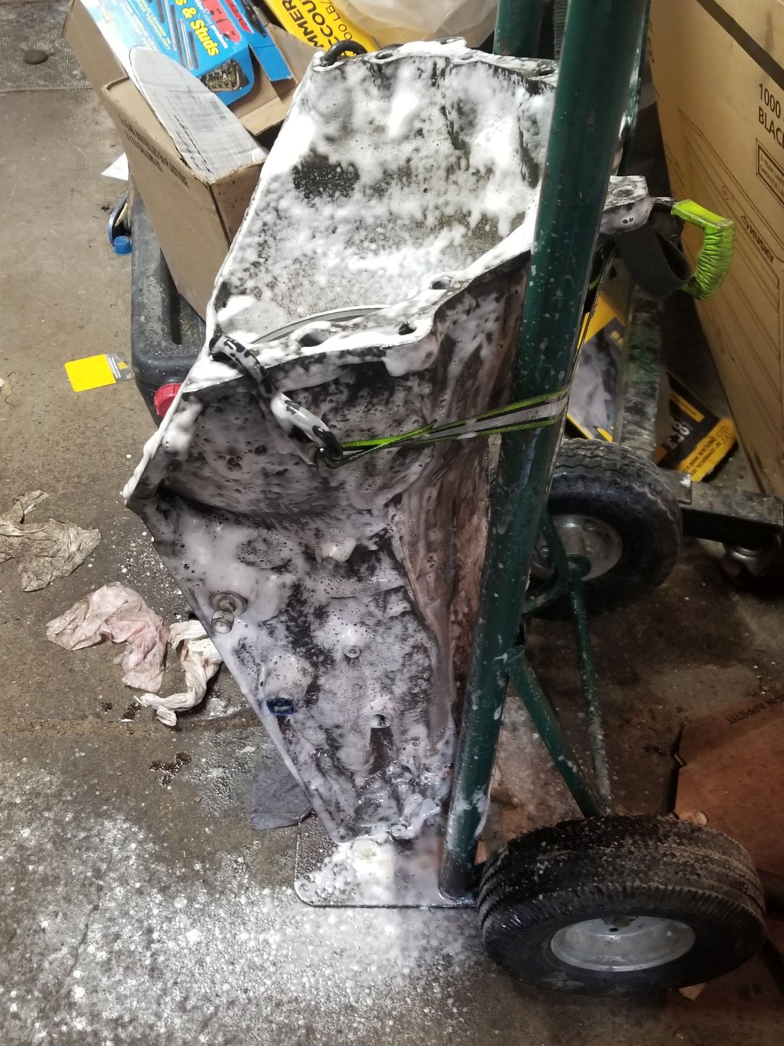

Hit the case with degreaser and hit it with the pressure washer. Not super impressed with the Spray Nine engine degreaser. I will pick up probably Gunk or similar and hit it again.

I hit it with a whole can of oven cleaner, used my 15 and 25 degree tip. I ended up carefully using the rotating blaster tip on my 2200 psi gas pressure washer. Looks pretty good.

Now, with some sandpaper and polishing compound you can make it look almost like chrome. For those without a pressure washer spraying them down with oven cleaner inside a large trash bag and closing it off and letting it sit in the hot sun for a few hours sealed up, and then using a regular garden hose to wash it off should work well.
