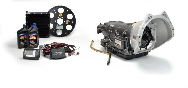

TCI makes a 6speed automatic that can be order with the BOP bellhousing. They show a starting price of over $5700. You'd have to call them about fitment

That's just a 4L80E where they gear split with the overdrive planetary. At least they've finally changed the ratios in the main planetaries, so first gear is now 2.97 instead of 2.48. The thing that scares me about this trans is that the 4L80E overdrive stage is the weakest part of that trans. In stock form it only has two clutch plates. I'm sure they beef it up for this application, but it's STILL a long way from the beefiness of the forward and direct clutch packs.
One does have to be skeptical of the hype.
Using the latest developments in drivetrain technology, TCI® has developed an innovative automatic transmission for Pro Touring, street and all-out race vehicles.
Yeah, a trans that was first introduced in the 1991 model year is the LATEST development in drivetrain technology...
EDIT: the version that comes with a BOP bellhousing is a mere EIGHT THOUSAND DOLLARS!
